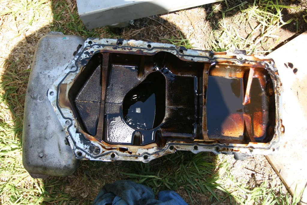

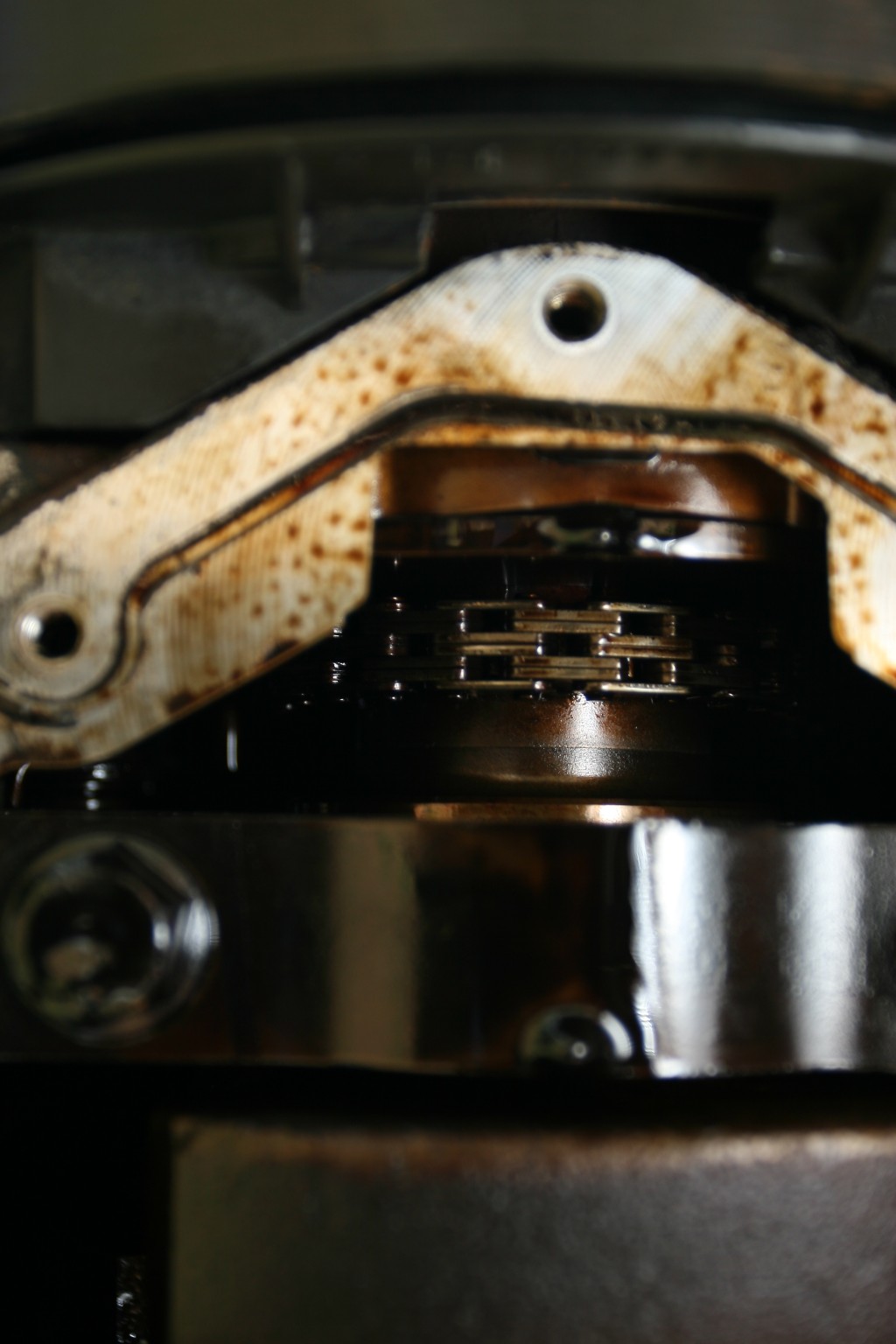

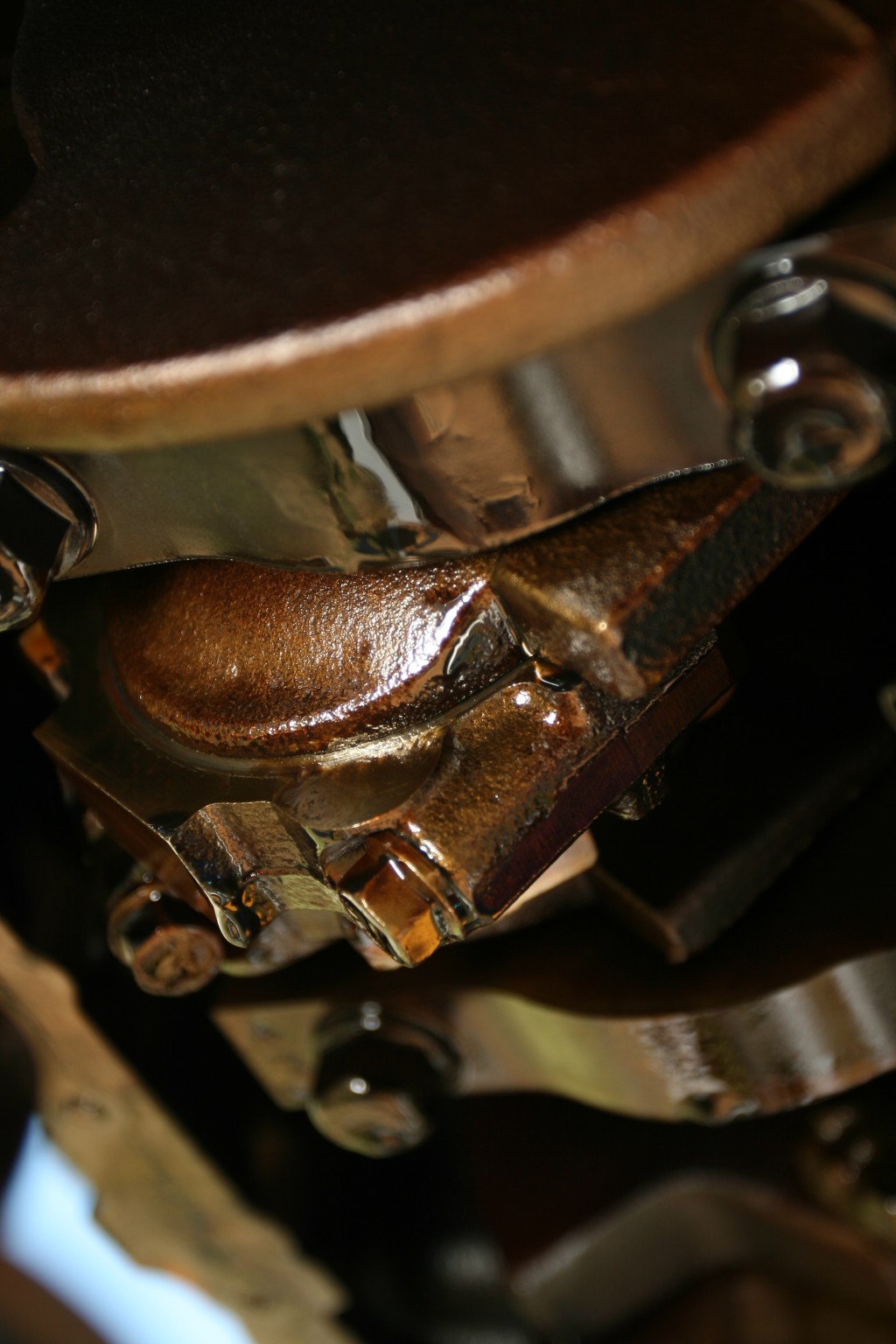

got engine crane back but wont have time to shift onto stand till next week, so just dropped the bottom off cause i was itchin for a look, whats everyones thoughts? i couldnt' see any metal in the sump just a bit of goop, pickup looks clean, wiggling the rods could only wiggle enough to just make a noise, also is that a VS sump? thought the VT had the metal gaskets? The sumps cracked right on the inside edge of the T shape, it just looked like a casting mark but is a crack..

- Posts: 5625
Re: The1's Daily
that first bigend pic looks a bit dodgy maybe its spun a bearing.get it on a stand
Re: The1's Daily
yeah agree, did not see it when I had a quick look first time
check the bearings not worth the risk fitting it without doing so
Re: The1's Daily
righto, when i get it up ill pull that one off for a look and a few more pics inside.
Re: The1's Daily
i don't think its spun a bearing, you can see the join in the bearing in the same spot as the cap joint! probably just the angle of the pic that makes it look like that, otherwise, don't look too bad inside, usual build up of varish but nothing to hardcore!
- Posts: 8114
Re: The1's Daily
what you are looking at is actually the thrust area polished clean. It does look further away from the journal than is should be so check for movement. there should be none perpendicular to the journal only few thou of end float
