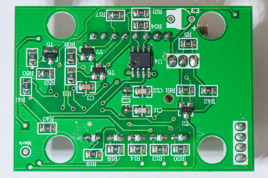

- Posts: 5632
we should start an elm innards thread and see how many different chipsets we have least then we could work around making each work or assertain which dont
- VL400
Here is an eBay special from a few years ago. Just the generic clone labelled ELM327 V1.5a
Been meaning to try your tool on a CAN vehicle for you, and also to get some logs as it connects ok using the current ELM compatible software around the place.
