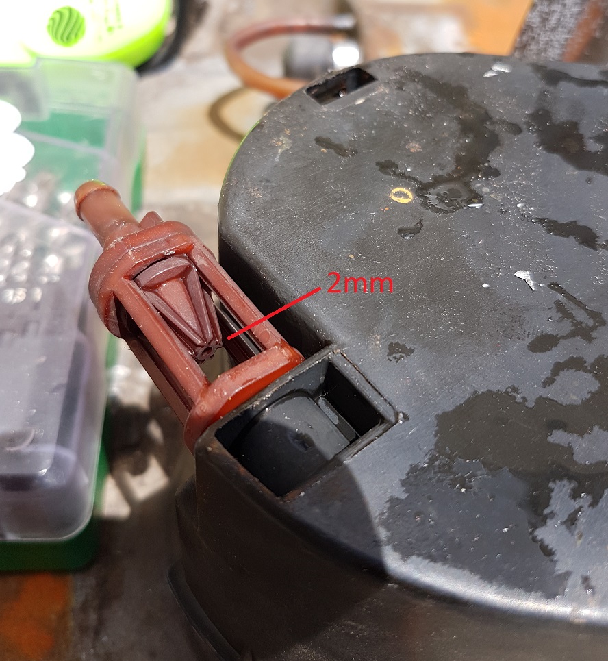

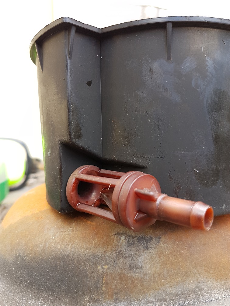

On my EVO they have only a 2.5mm return inside the tank. It creates a venturi effect to draw fuel from the LH side of the tank. I fitted a Walbro 255 and had problems only to find out that the venturi hole needed to be drilled out to 3.5mm. I did some before and after fuel pressure tests on both the supply and return line and found it was around 15 psi in the return line and now is around 4. Car is now running as it should.
Re: Toyota Powered VL Calais

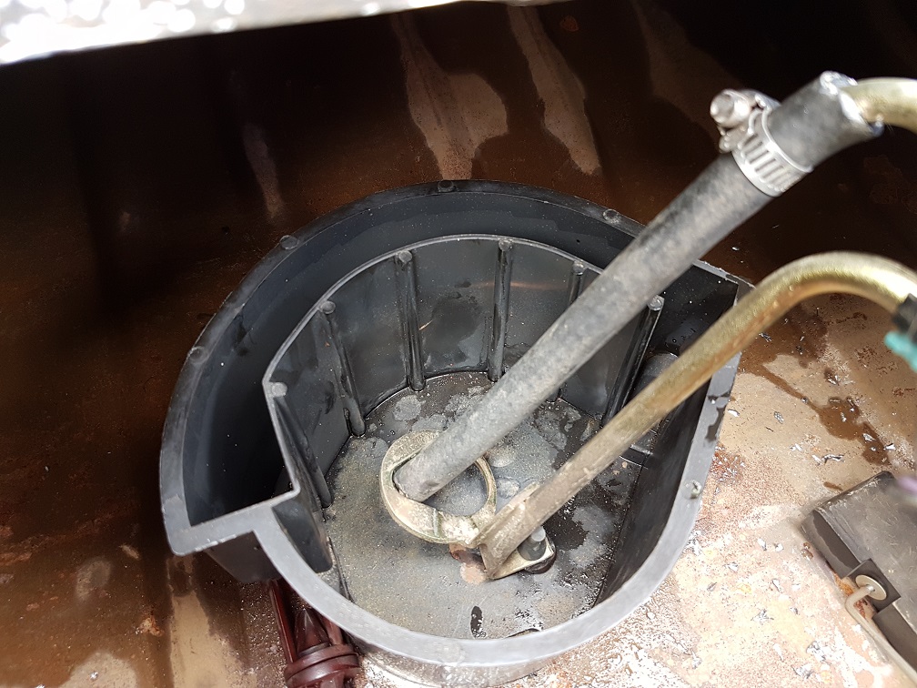

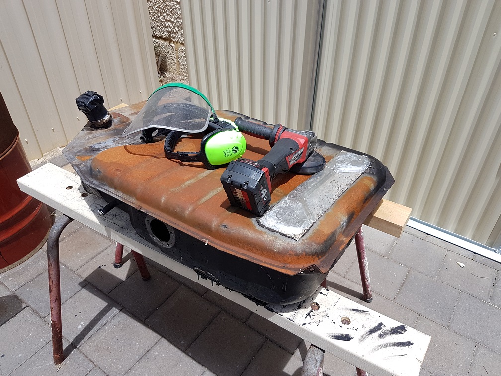

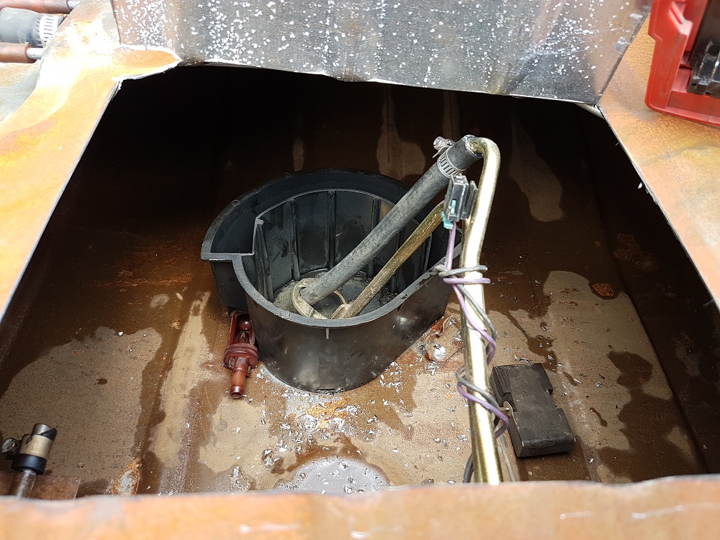

Spare tank now has an access hole :lol: Looks like the venturi is only 2mm, well that sucks! Certainly sounds like similar issues in the Evo Charlescrown.
Some pics...
Swirl 1.jpg (322.9 KiB) Viewed 7938 times
Swirl 2.jpg (283.28 KiB) Viewed 7937 times
Venturi 1.jpg (257.28 KiB) Viewed 7938 times
Venturi 2.jpg (287.96 KiB) Viewed 7938 times

Would a fuel tank from a later model Commodore possibly have a larger venturi on the return?
Just add a 2nd bleed in the line to relieve pressure but still allow the stock venturi to work.
Alternatively, turn a new larger one up out of SS or if you can, drill that one out larger.

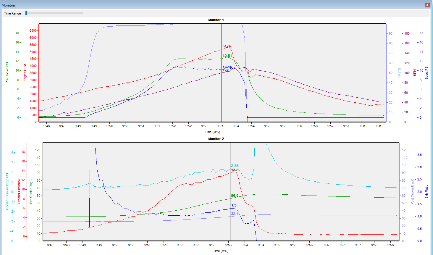

The cooler that was replaced earlier in the year performs better in terms of pressure drop but as expected the tube and fin design is slightly less efficient compared to the old bar and plate. But overall happy with the systems as a whole, total ratio of 1.3 for exhaust back pressure to inlet pressure is reasonable. Dropping 2 PSI at 10.5 PSI inlet manifold pressure, it was dropping around 4 PSI and climbing for 8 PSI manifold pressure on the old cooler with the same 70% wastegate DC.

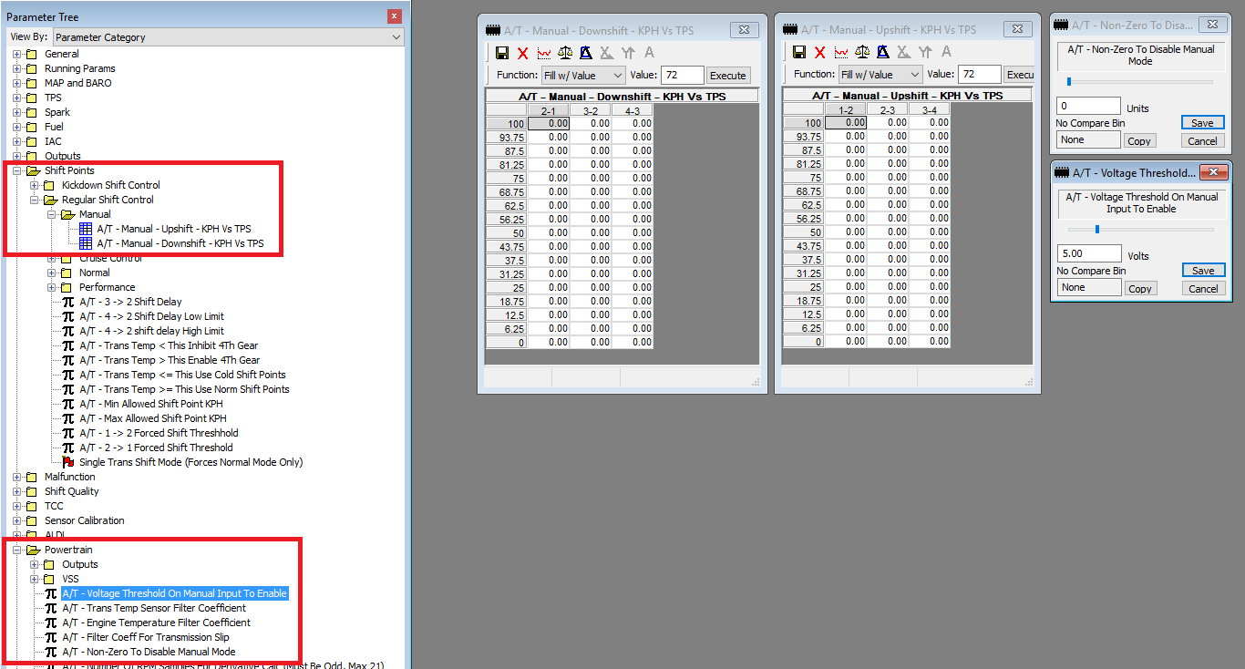

Added a switch for manual/auto control, so the above pull was in 2nd gear. Works like a charm using the manual input pin D10 (on a '424 PCM) and the following settings and applying battery volts to get manual mode. No kickdown control in manual mode so never kicks back, just follows whatever position the shifter is in.

Awesome car now. What is the exh ratio your logging?
