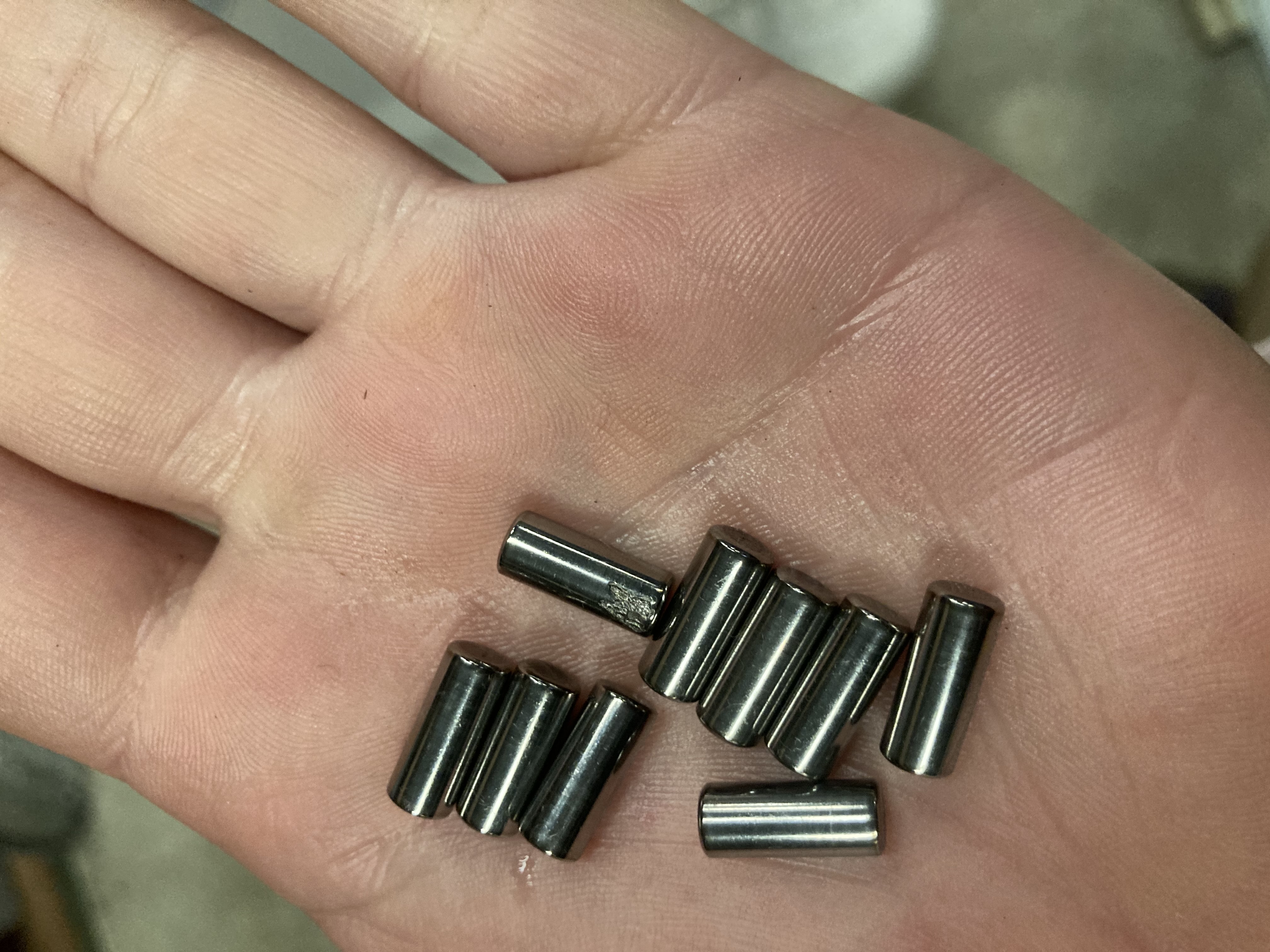

I just realized this after like 6-7 years. The loose rollers are the same ones in the cage of the 10 roller and they can be popped out.
So I had this 600k one from my old Vacationer that worked fine but one roller was badly chipped.

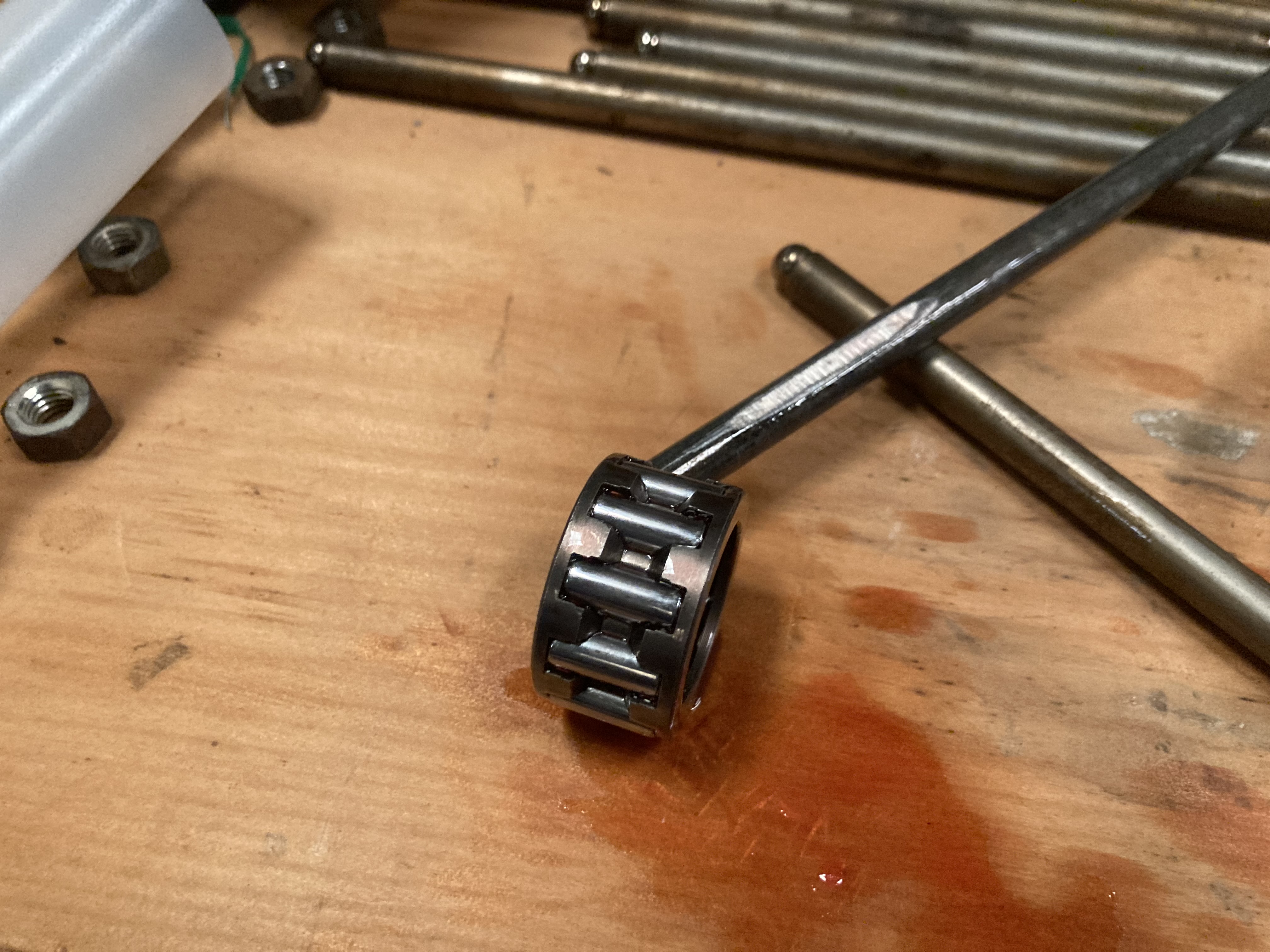

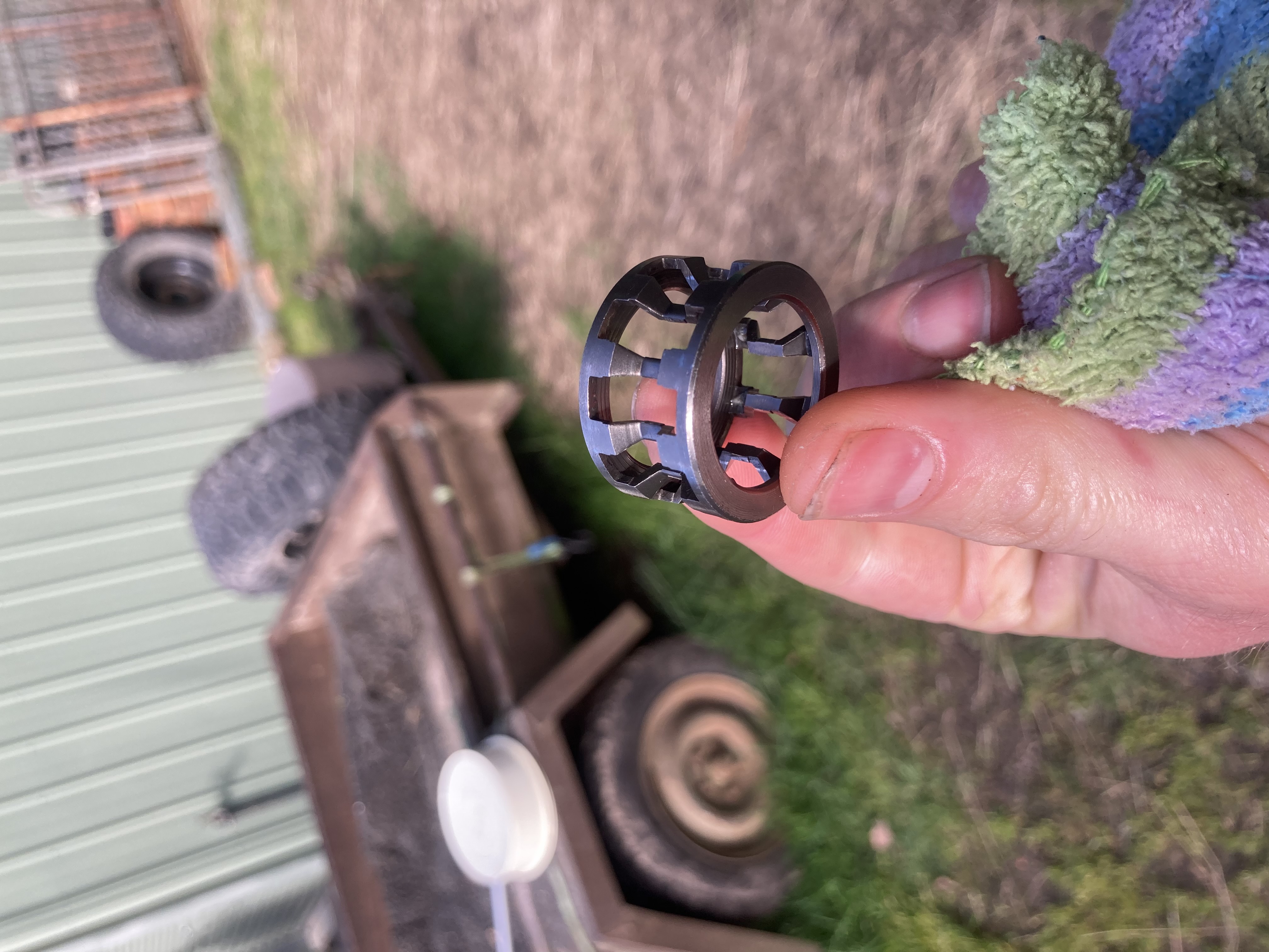

I tapped with a wood block using the corner edge on the roller from the outside and the roller pops through to the inside.
I knocked them all out and then used a steel rod with a flat ground on one side to balance on top of the roller from the inside of the cage and forced a fair bit of pressure on the 2 ends of the rod either side and they popped in, one by one. Now I have a new Aus spec bearing and now don't have to try and track one down for this box or and of my future builds, just use the rollers supplied in the US OEM overhaul kit which contains everything needed now to do the Aussie variants.

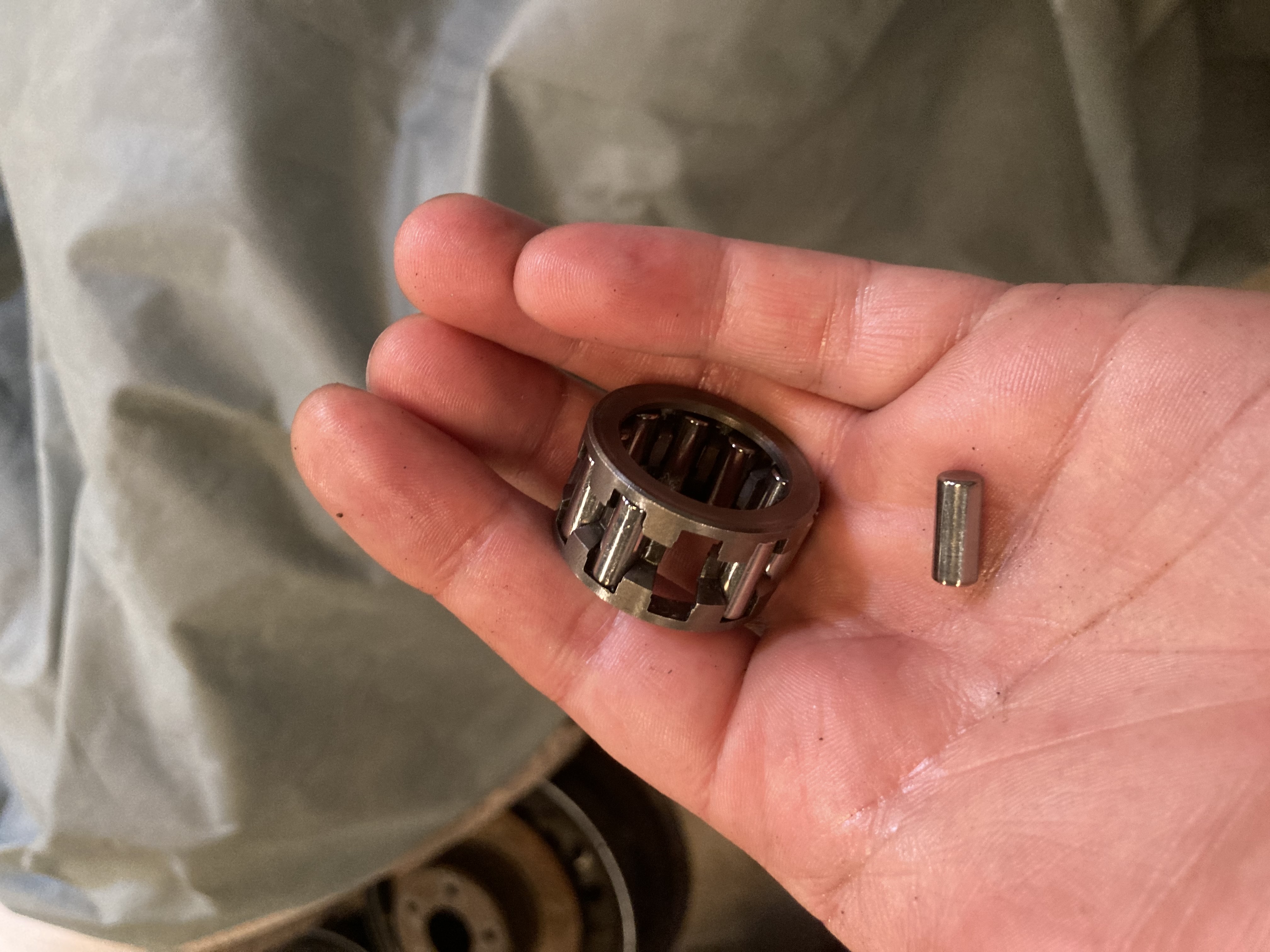

New roller installed.
Old ones with 600K + on them, I wonder how many billions of times these things have rotated
