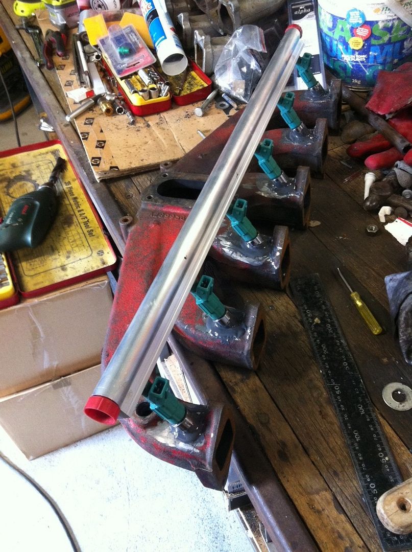

Had a day off work today and made this up and it was a lot easier than I thought it would be. A 19.5mm drill bit $57, 6 steel injector bungs $60 60 and a packet of JB Weld $ 14and of course a custom made fuel rail about $300. I will clean it up a bit once it fully dries which should be tomorrow sometime.

Don't know much about JB weld but I suppose all it's got to do is seal an air leak. Thought about machining a groove in the bungs and pushing then into the 19mm holes. Big drills get expensive don't they. So next step is to mount the throttle body.
Re: 265 Hemi to efi
that'll work well enough and long enough for a test rig
