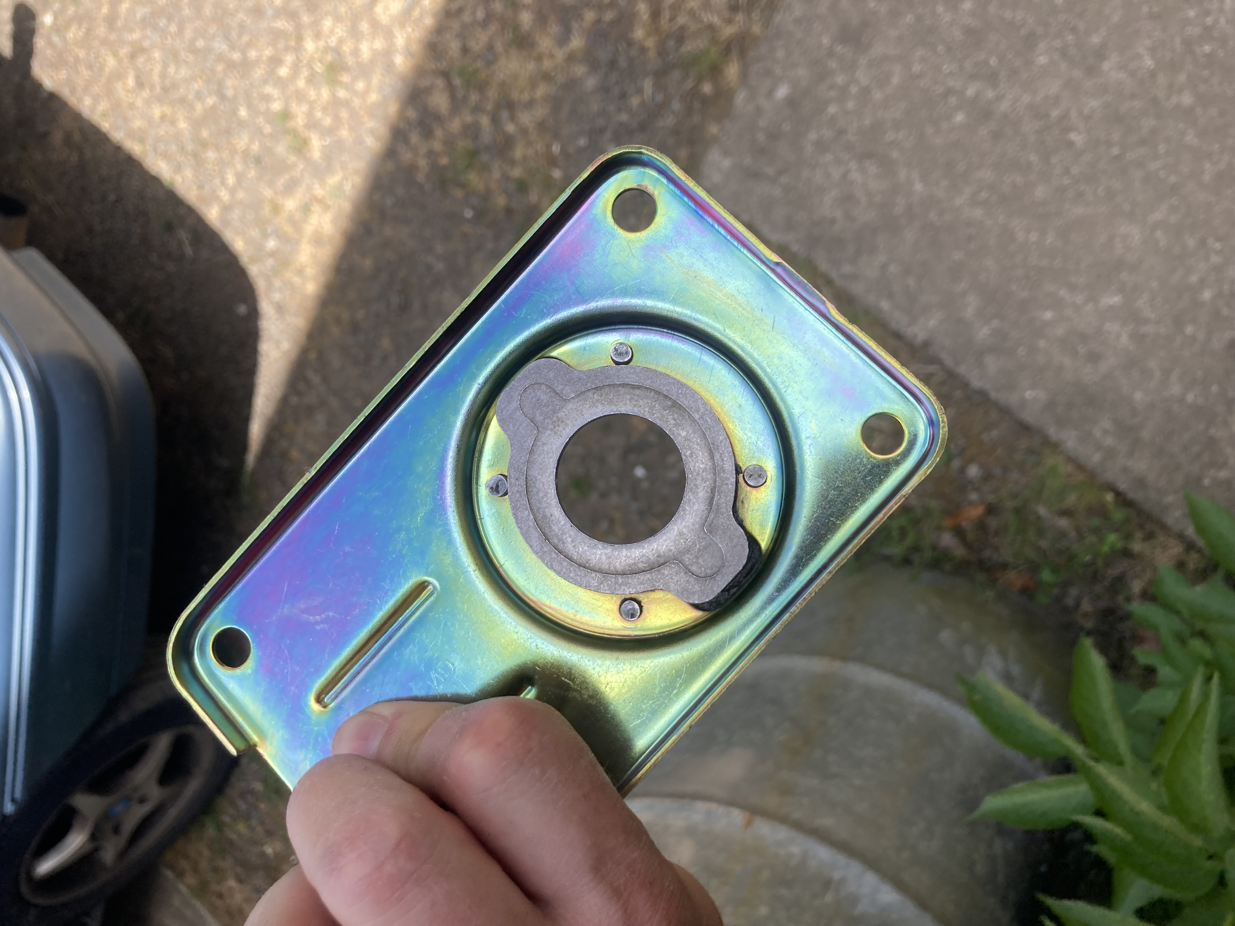

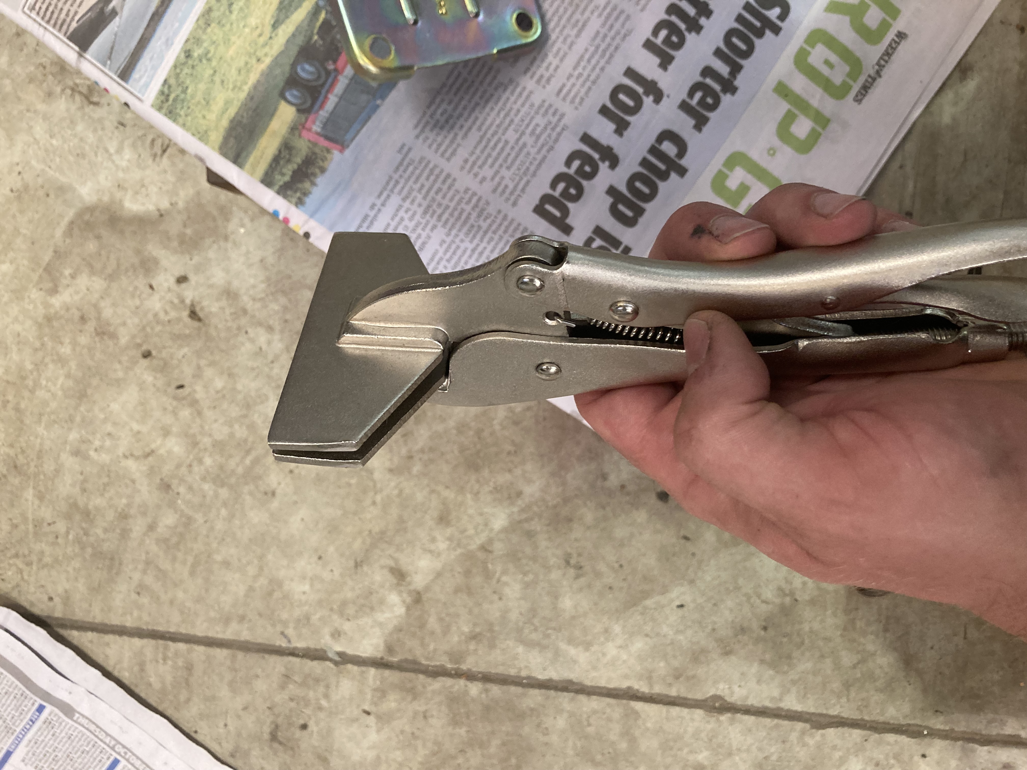

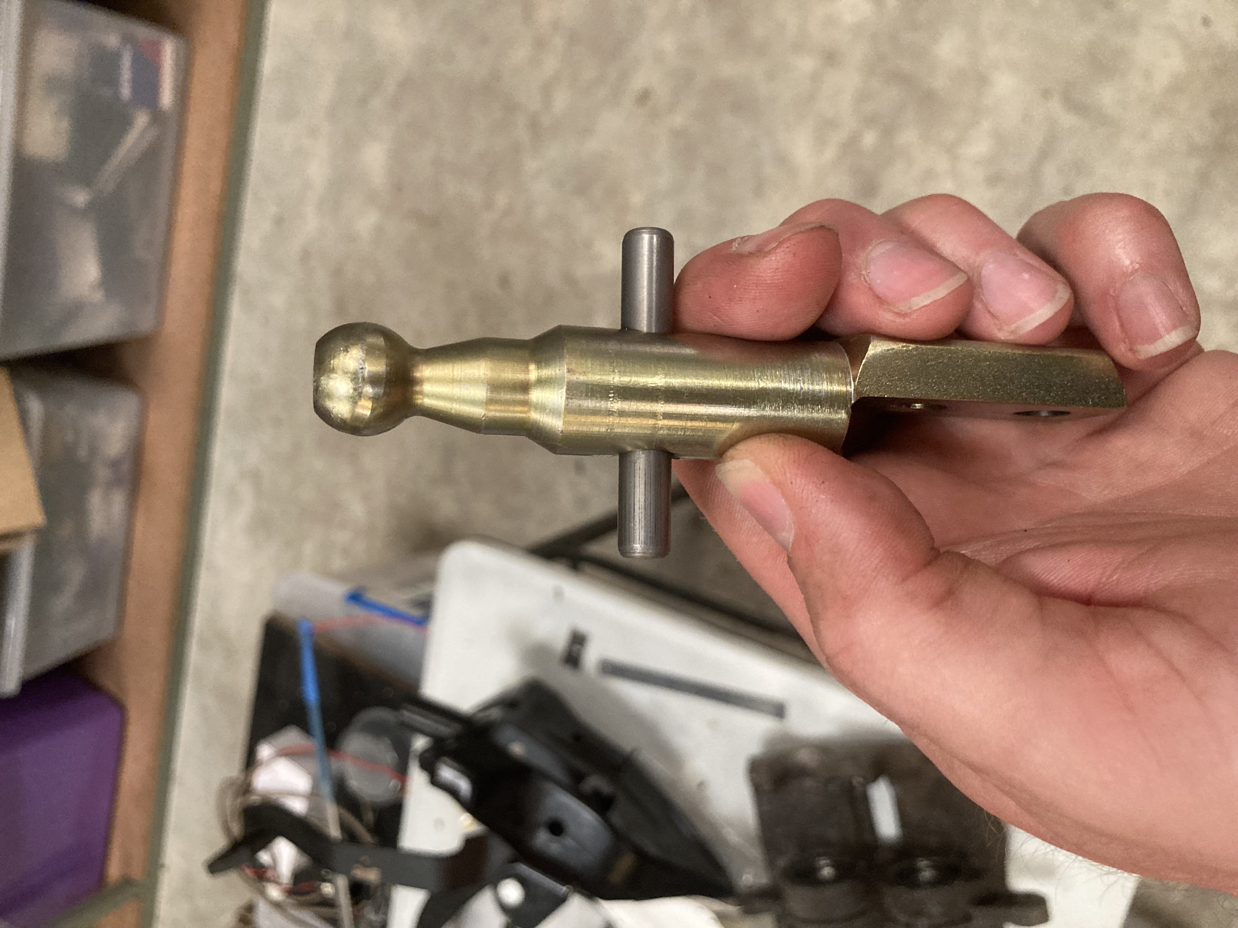

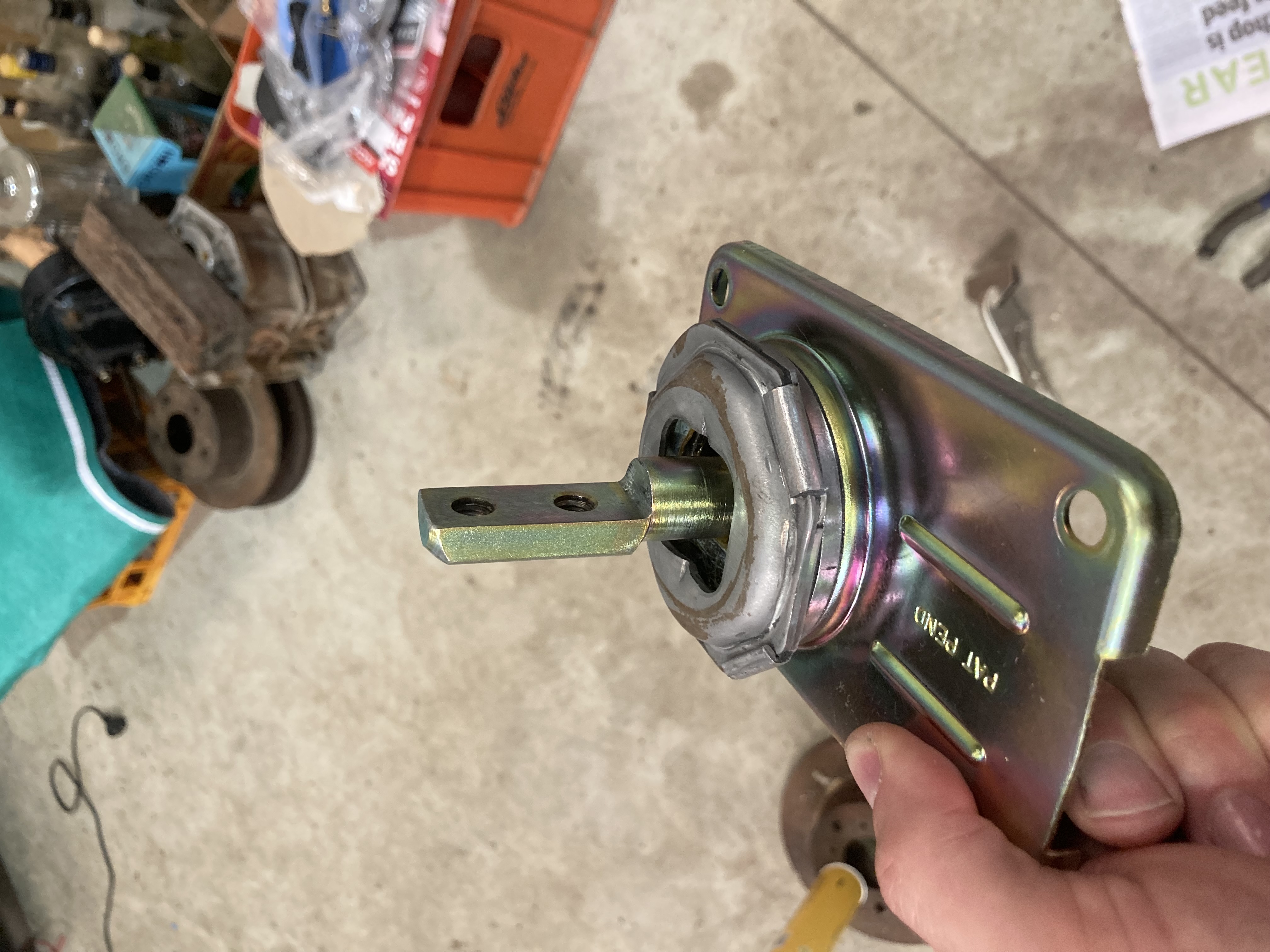

Finally got around to building that new stock shifter from the bits from the US long shifter that was a NOS pulled unit.
My home made rivet punch worked great. I cut a piece of hose as a guide to stop it from jumping off the rivet when I belted it with a large steel mallet.
Worked a treat!
I also added some oil resistant silicone between all the layers to better seal it than what the factory does, so hopefully that stops it from weeping anywhere near as much as they do.
Few other "purpose tools" I used to press the tabs back together.
New pin from the NOS unit pressed into the original shaft.
Genuine new boot that came of the NOS unit was used too.

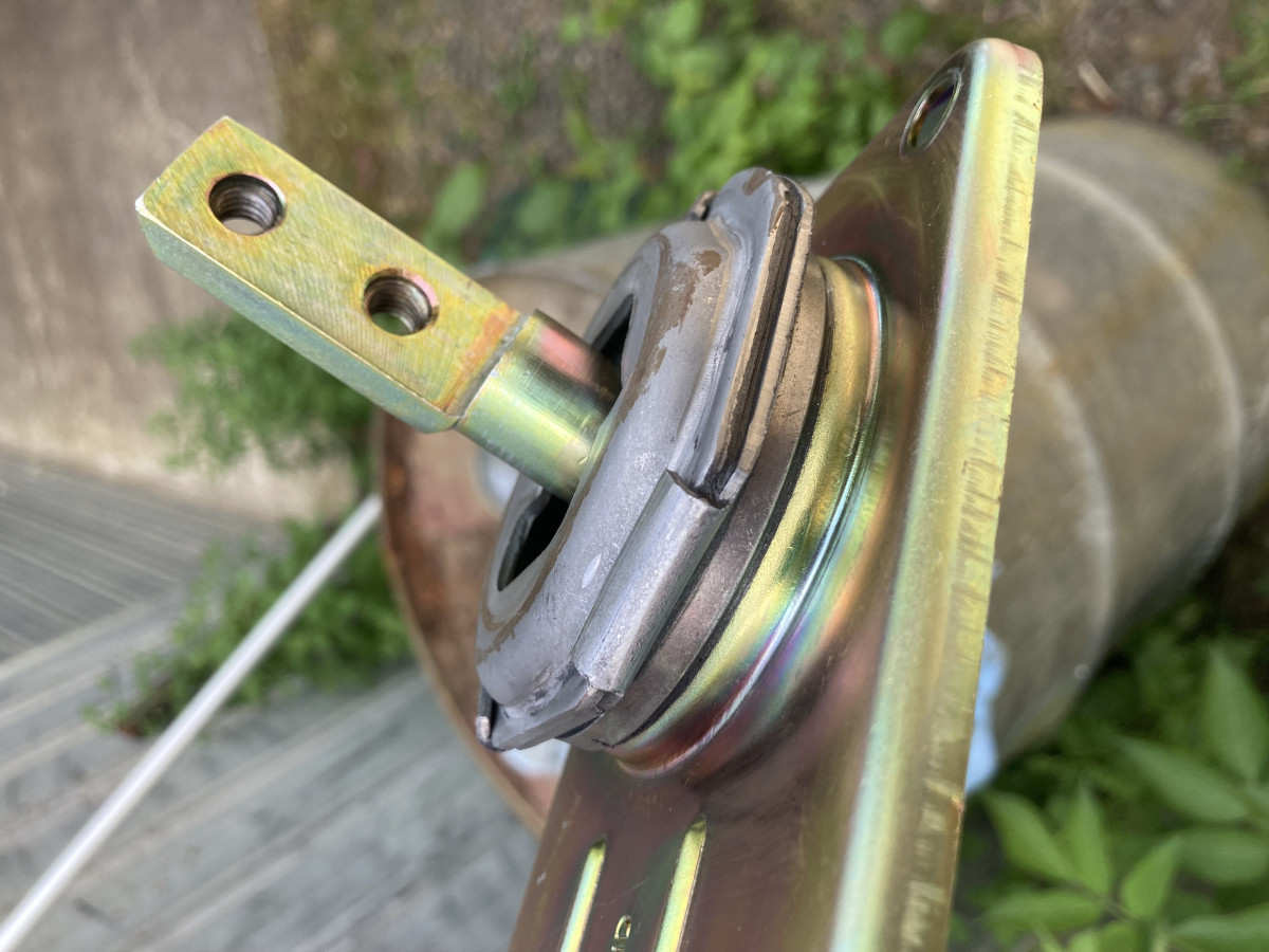

Still can't get the pics to go the right way once they upload. I am sure it's a win 11 problem as much as it is an apple one. But on my desktop which is win 7, I can always fix it before uploading by using my trick of rotating in a random direction, then rotate back to the position I want it to display, works 100% of the time. But on win 11/10 it only works maybe 20% of the time and there is no way to tell what it will end up being once uploaded. Not just on this forum, by FB posts and ebay does it too.
Anyway, would be cool if this forum had a pic editor so you can at least fix it in post, kinda how ebay used to have one up until a few weeks ago this year or I suppose FB market place.
So just try to bare with me on the random pic directions.
But I digress. The sealant took me several goes and this is the best I could. My hands are just never steady trying to dispense sealant and lay a nice bead, never have been and I am rat shit at this, but I am happy this came up ok at least by smearing off the excess after a few goes in itself.
All other seams I used a micro cloth to clean up the excess.

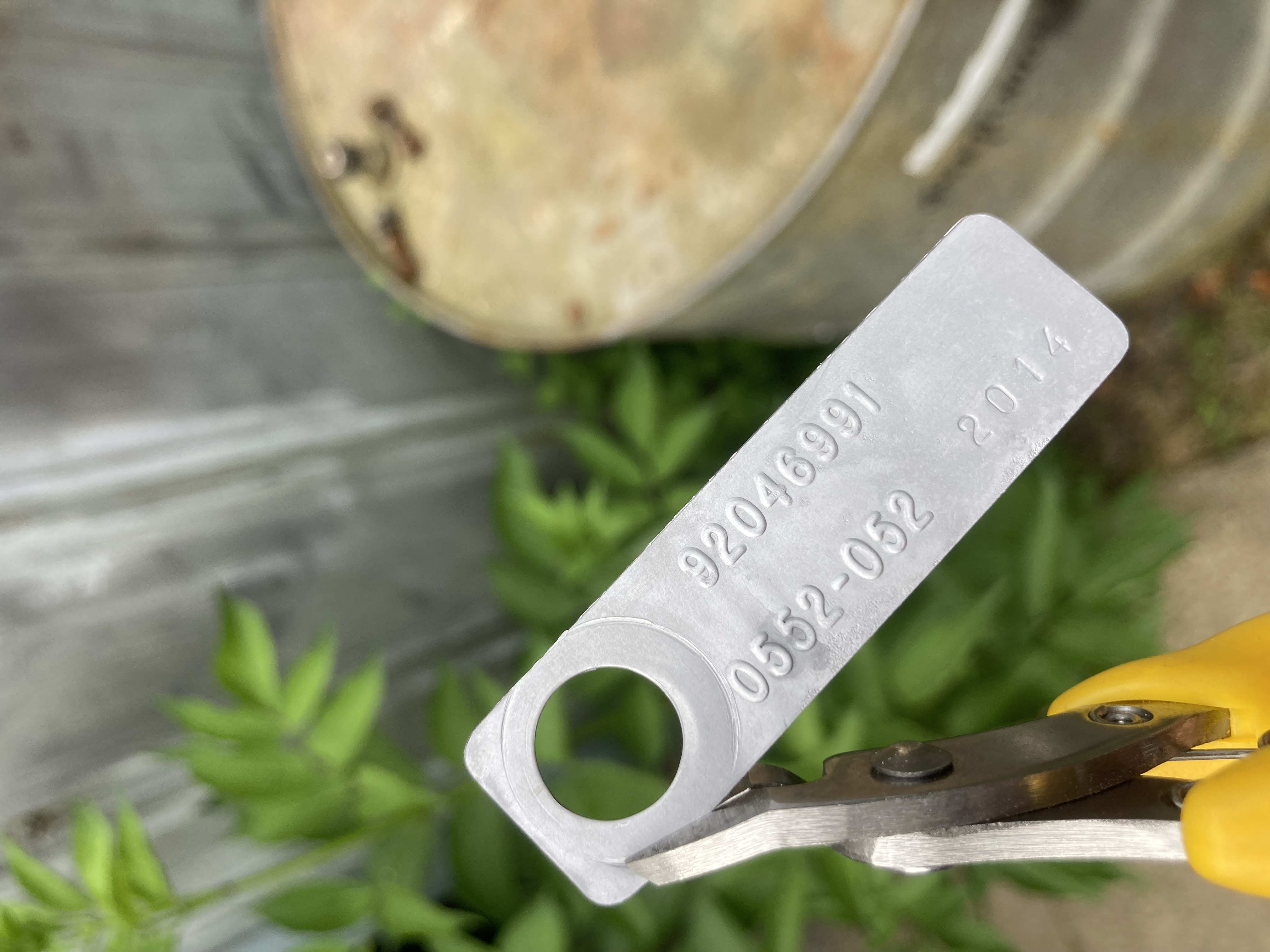

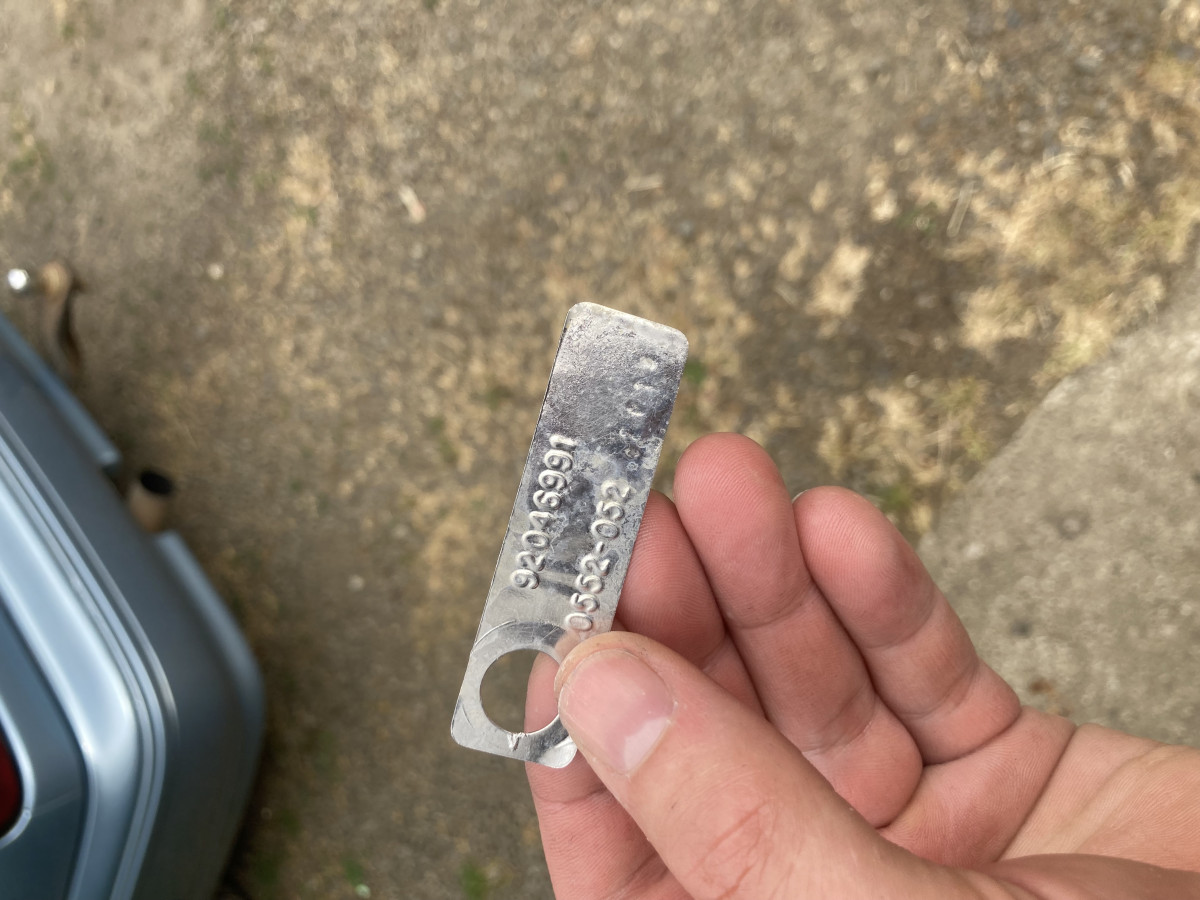

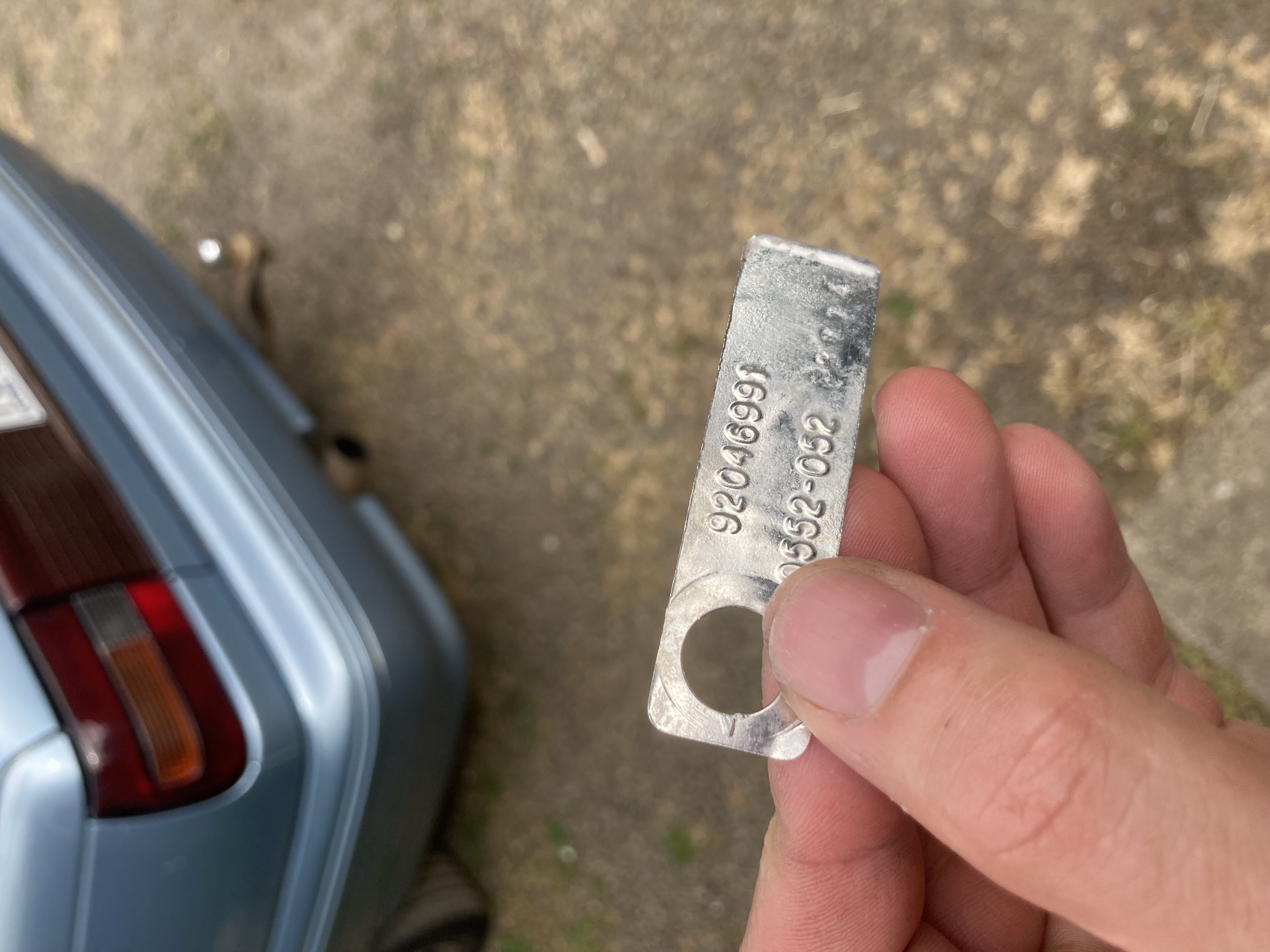

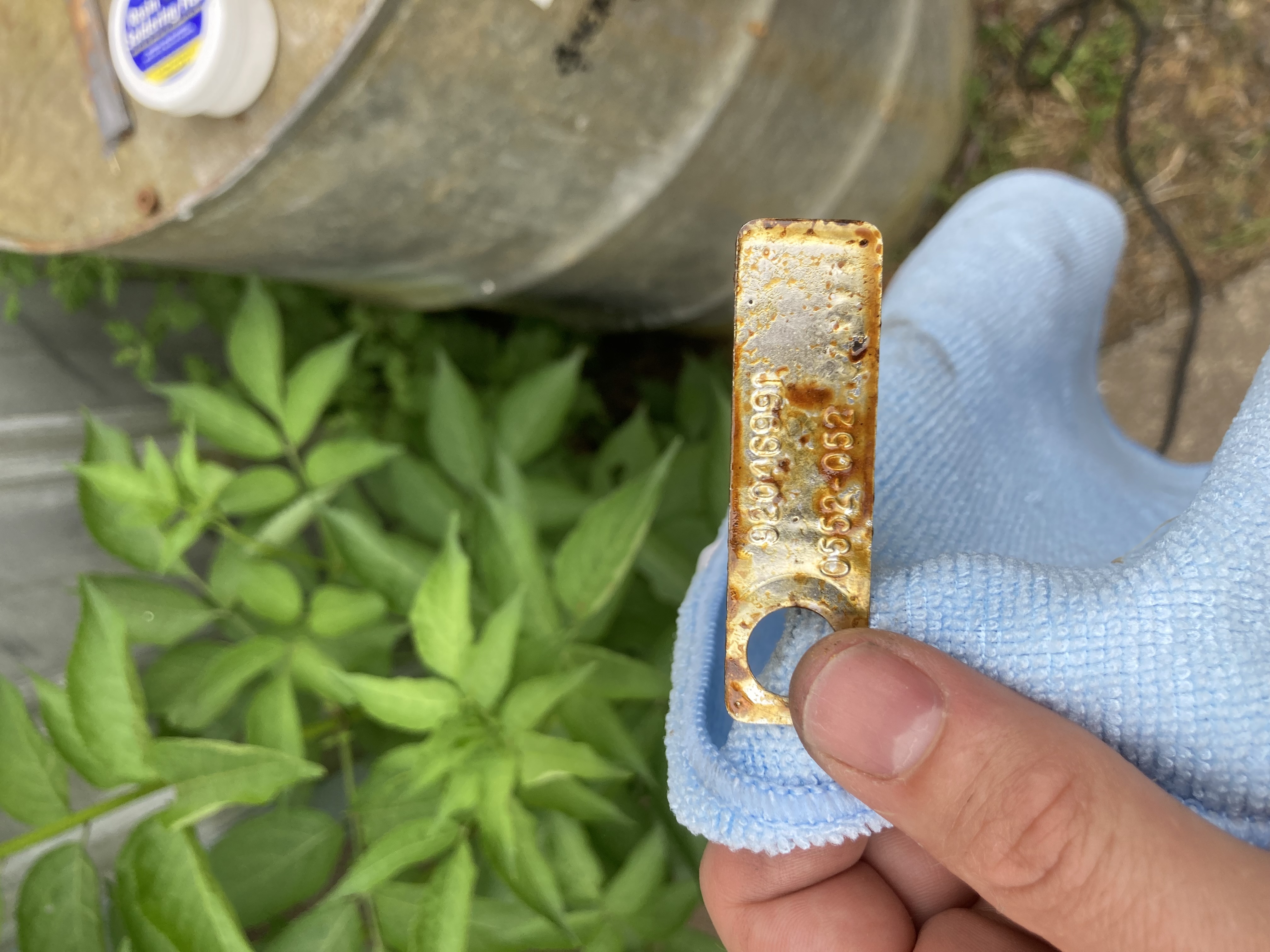

I also restored the ID tag for the T5, not that I really need a tag for it as it's not a restoration, but rather a good tidy up and mod with a long service life in mind as the goal, but I had to give it a shot.
So the OG tag is a rolled sort of plate with gal coating before they are cut and stamped. But I can't really get a place to gal it with such a small one off job like this, plus I am poor now so I can't afford little luxuries like having a nice tag lol.
But I already had stuff for lead body wiping/filling and bunch of supplies for electronics soldering. So, I came up with the idea of stripping the tag to bare metal by pickling it in HCl, used a propane torch to "thermally clean" off some bits of silicone sealant that didn't want to come off, HCl again, then I dipped it in tinning pastes, 100% Sn powder and ZnCl as the flux, all as a slurry.
Used the heat gun and played around and found about 480C was about the go for getting it to flow out decent. It looked very rough and granulated as expected, so I fluxed it now this time with rosin flux I use for PCBs, then tested temps and found about 390c to flow out nice, I flicked the tag while molten to rid the excess bulge of tin at the bottom and some solder wick around the SN number, fluxed it again and it came up great with a natural looking gal, just it's tin and not zinc. But either way it was a beaten up mangled heavily rusted tag that was not even readable on the some of the numbers.
I had one zinc plated in the past, but I dig the tin gal look. Looks industrial and mass produced, rather than the bling that comes with overdone restorations which i feel I did a lot of in the past, not for the look, but for corrosion protection as the humidity here in winter is horrific, I still always preferred that new/clean OEM look . For a daily driven car, even this type of work is overkill, but it was essentially free and only just cost a little of my time and the results were worth every bit of that.
