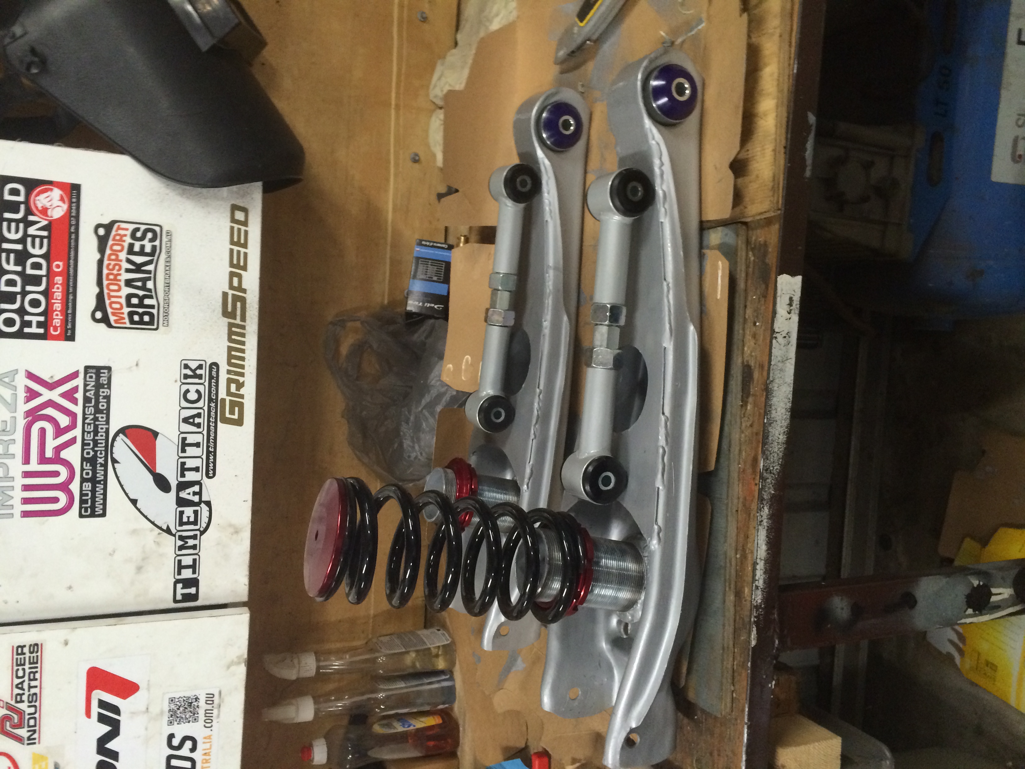

did you weld in the nolathane bushes in? I had to on my VP lol.
TdracerTd
Posts: 488
Mitsubishi Evo IX
Re: Sc14 to buick and e85
Post by TdracerTd »
vlad01 wrote:did you weld in the nolathane bushes in? I had to on my VP lol.
Why?
they were undersize and kept falling out. Hence why I use superpro these days as they machine the shells to precision tolerance where nolathane have die pressed shells which vary in size.
TdracerTd
Posts: 488
Mitsubishi Evo IX
Post by TdracerTd »
vlad01 wrote:they were undersize and kept falling out. Hence why I use superpro these days as they machine the shells to precision tolerance where nolathane have die pressed shells which vary in size.
Okay, these appear to be alright. They have been in for a year or two and have done a few events without any problems.
should be alright then.

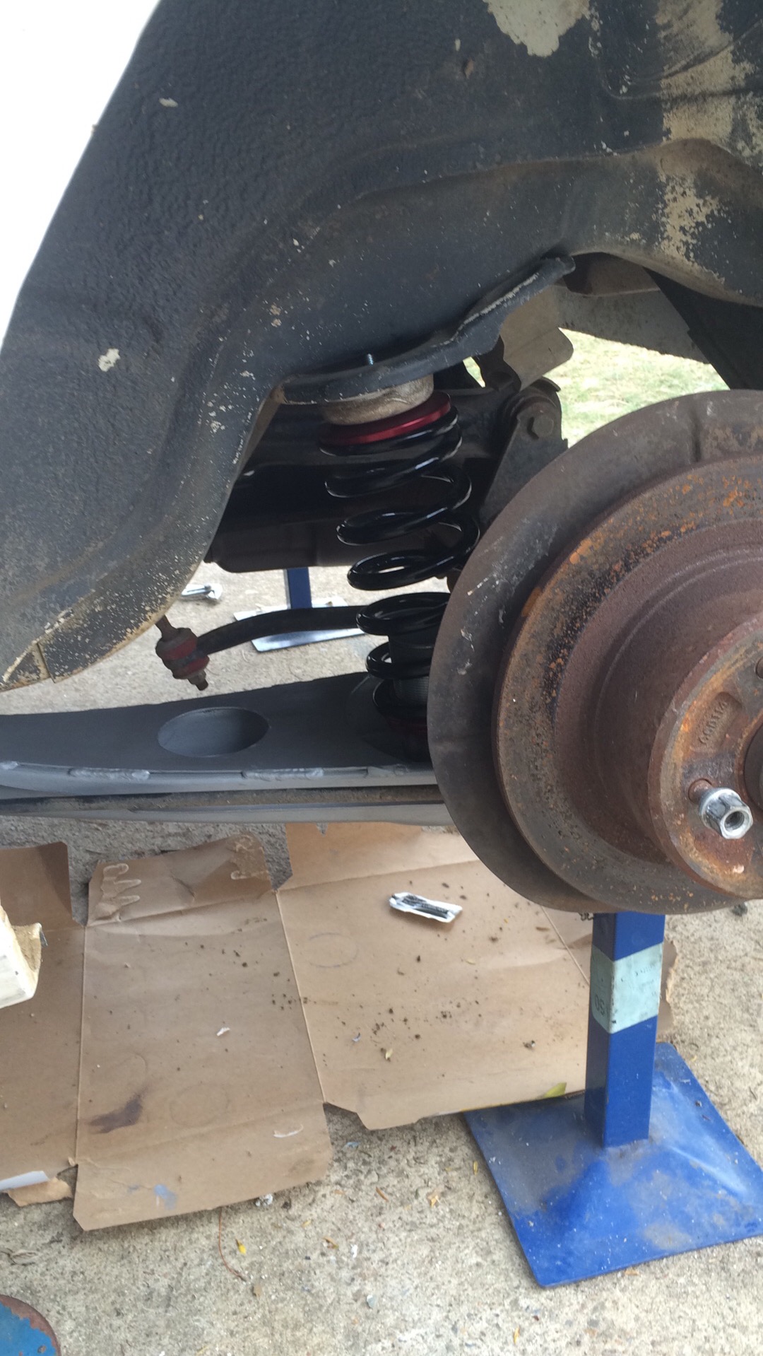

Finally got these painted and installed-

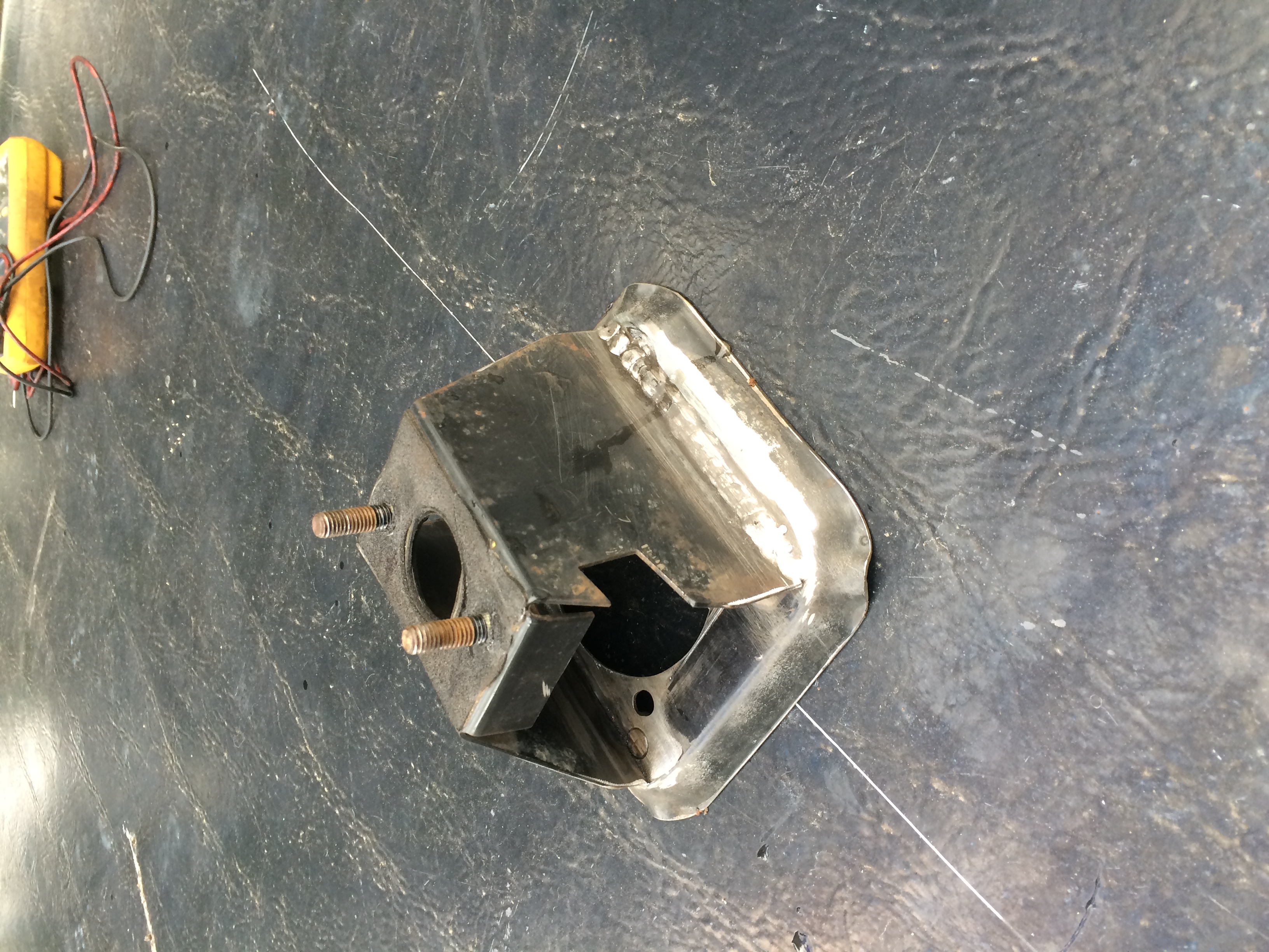

Also a vt booster to vp firewall bracket that I made-
