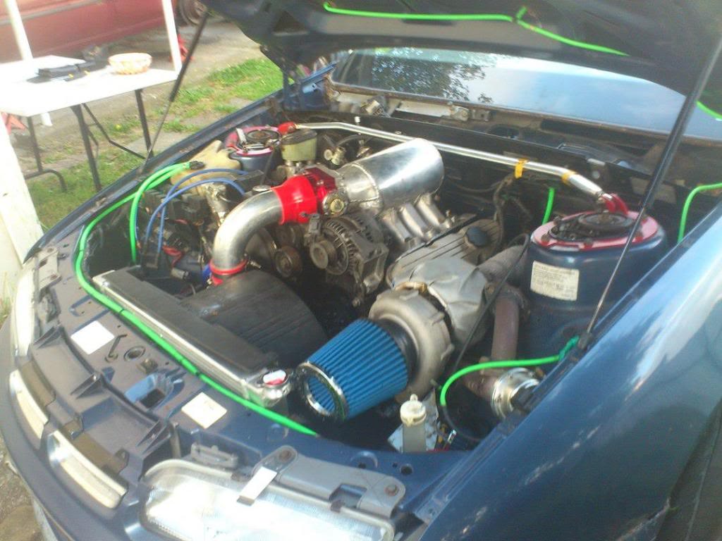

new injector and a set of plugs in vx runs a bit smoother but very much the same.no real updates on the starlet its still away getting its cage fitted.so while its been away we finished the vr turbo's intake manifold and today tried to dial in the cam.i say tried as the cam card doesnt match the cam turns out what was meant to be another 222@0.050 cam is actually wait for it a bloody huge 284/290 @ 0.050 sims up at good for 650-700Hp :D seat to seat is 310/310 degrees. finished inlet manifold pic below
Re: DELCOS NEW RIDE
nice race cam :)
Posts: 5630
Re: DELCOS NEW RIDE
yeah LOL nearly a formula holden cam going off the open and close figures

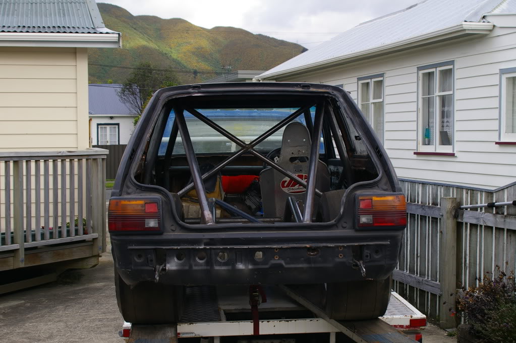

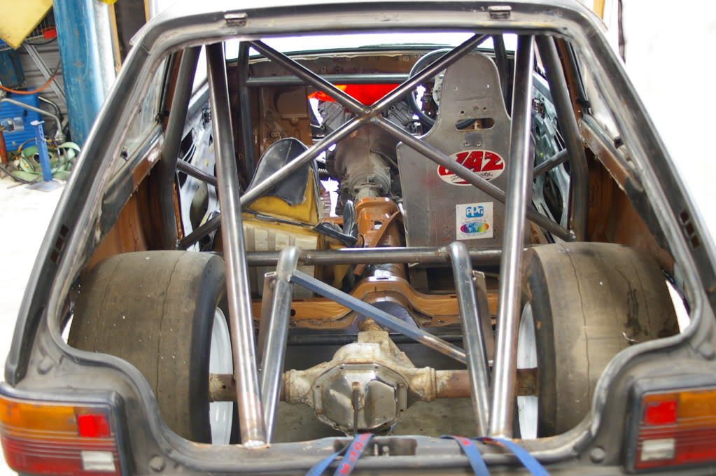

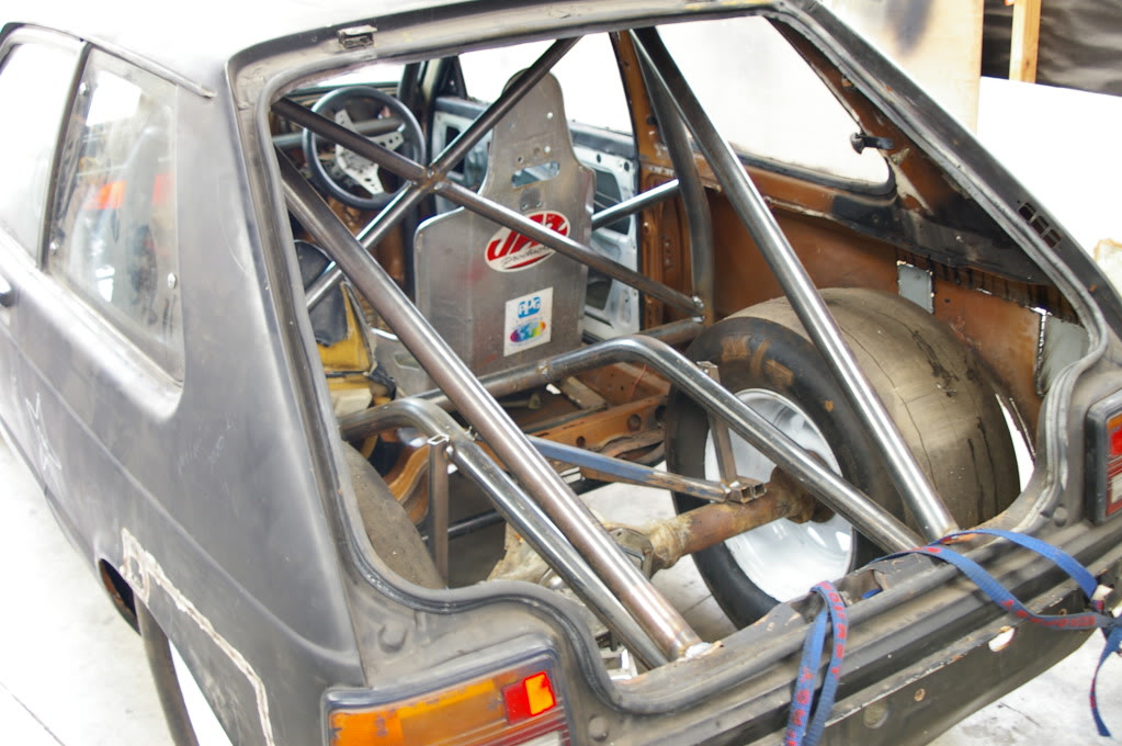

so excited starlet is back in the loaner shed :thumbup: i thought i was gonna have to go have a sly masty when i seen it
pics

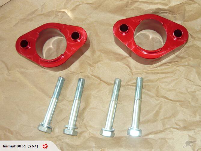

more parts for the starlet.30mm billet RCA adjusters and new high tensile bolts to realign the steering arms to remove bumpsteer after lowering it so far ,should be able to go lower even :D
