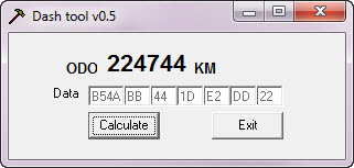

this is what I got from it, haven't had any time to do much more with it though.
and from memory the odometer was 24xxxx but I am not sure other than I was sure it was up there.

this looks good :) matches what im seeing in the hex editor!

Nice Work Holden202T, it's been a while since I played with this stuff & looks like you've got t sorted!
Posts: 10435
was pulling my hair out for a while trying to get it all working! should have checked the solder joints first hehe!
