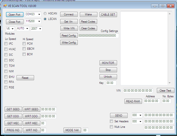

Yeah i tried to set avt up like jayme to monitor all addresses and also had trouble,it would be good if it could be done as its very hard to monitor all address with elm and not get buffer full errors at 500kbps.
I enede up using the elm for this program i wrote.

In the app above, what is "prog ind" and "mec"?

MEC : manufactures enable counter ,if set to a specific value the module doesnt need to be unlocked to program
Prog Indicator i used by me for development ,if youve ever tried to program a dash with under 100km using tech 2 ,it looks for this value and wont proceed unless it = a specific value
,if it doesnt tech 2 says dash already programmed ,if it does dash display will read " not programmed"
