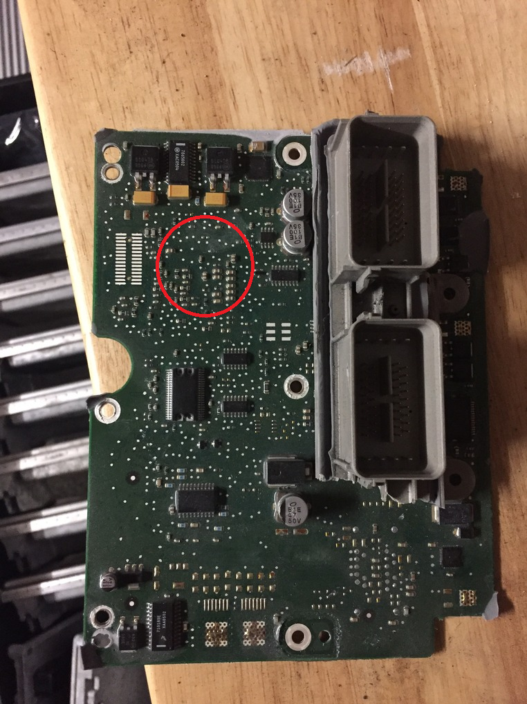

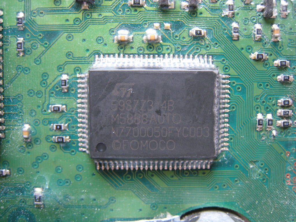

Rolls,
Anychance you can take some pics close up of the plug side directly opposite the MPC chip? Can you see the tiny (literally pin hole size) vias in organised lines?
And also what are the main partnumbers on the backside of the board?

Rolls 3.2 HPT onwards allows you to read the mechatronics Auto takes like 20mins for a full read, and about 15 seconds for just a calibration read or write, I have one on the bench if played with if you like to have a go it your more than welcome.

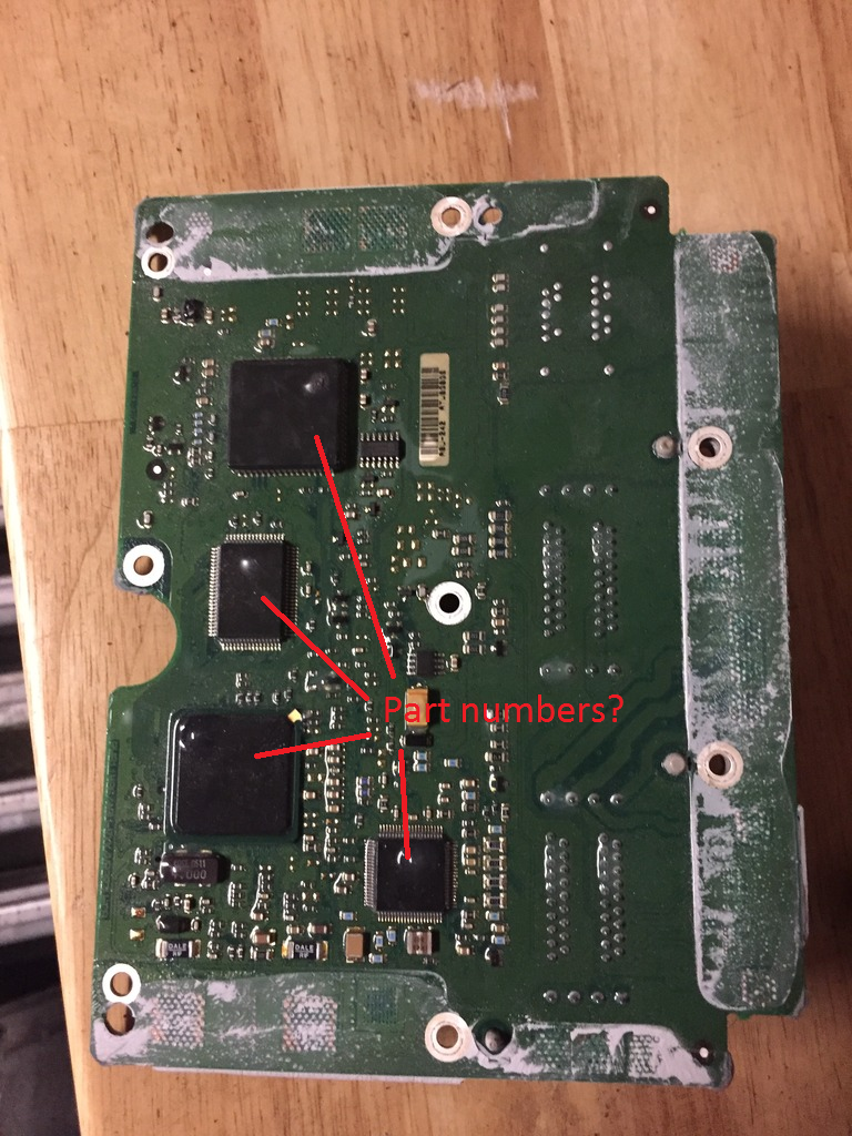

And TAZI that ECU you chassing the numbers from completely unreadable there is a film over it I can see text but would need to remove the coating to even have a slight chance of reading it.
