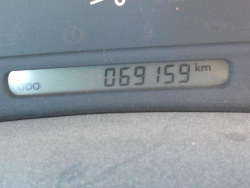

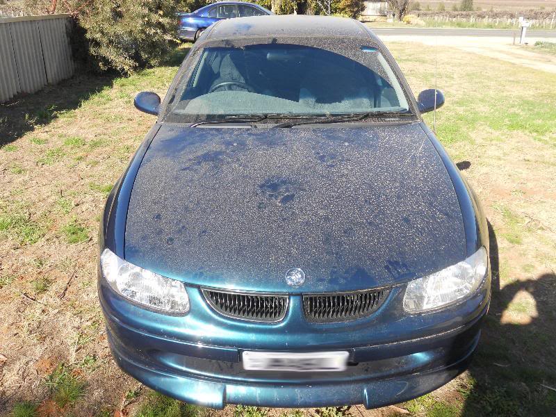

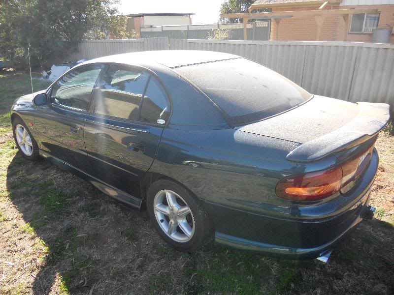

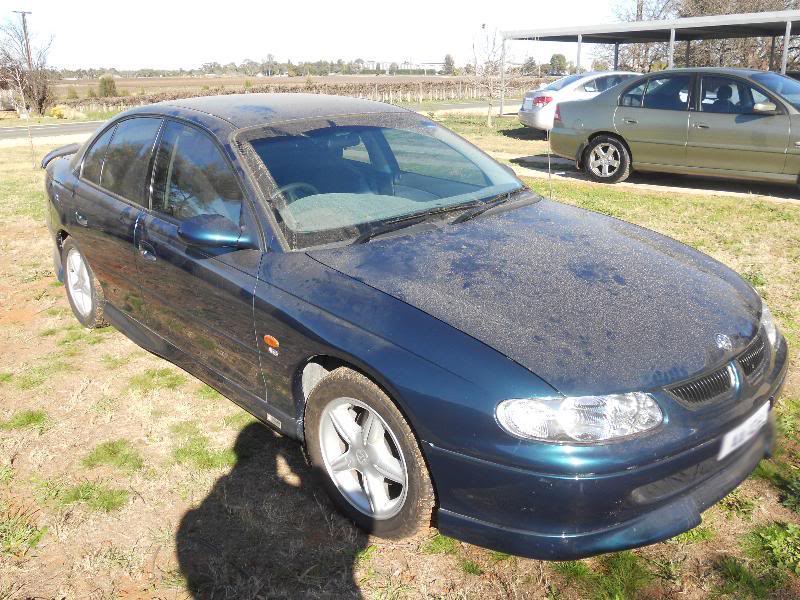

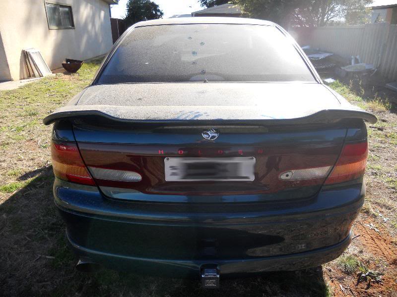

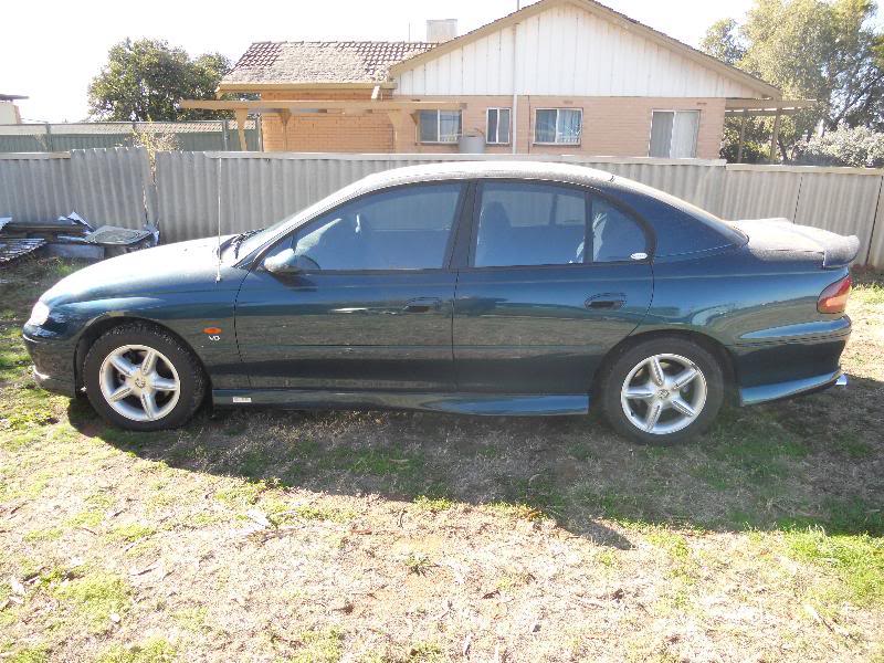

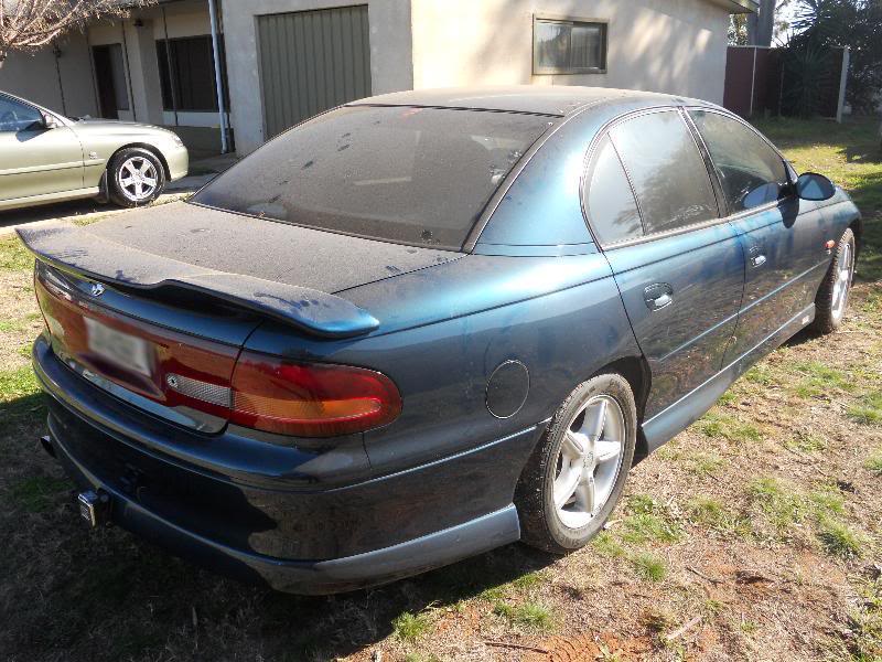

So I thought I would bore you with some pictures of a very dusty (Nine months without a wash) 1997 5ltr VT Holden by Design....Cheers again everyone..Mark!
