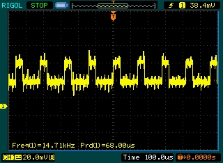

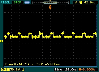

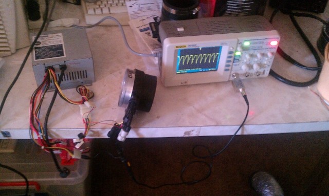

ok had a play with my new oscilloscope, Hopefully did this measuring correctly
, i got ahold of some other MAF's to play with, i think the MAF i have is an aftermarket as there no delphi stuff on it anywhere, actually no labeling at all, i managed to get ahold of a geniune Delphi MAF and another one the same as this stuffed one to play with.
I used the aircompressor from a distance to blow air through the MAF's, seems as you would expect when they reach there max flow it just stays at the same hz output and flatlines.
Here's my bench setup, just a standard AT psu used to feed 12v to the MAF, the scope on the output Stuffed MAF, after about 50psi i keep going to 100psi but it doesn't register anymore than 7576hz Here's the second aftermarket one i got ahold of which seems to goto 13160hz no problems. And here's a genuine LS2 MAF with Delphi Badge on it, got 14710hz, going by the LS2 MAF tables there only used upto 12000hz Compairing the two seems the aftermarket has bigger voltage from peak to peak than the Geniune one which seems much more refined?
