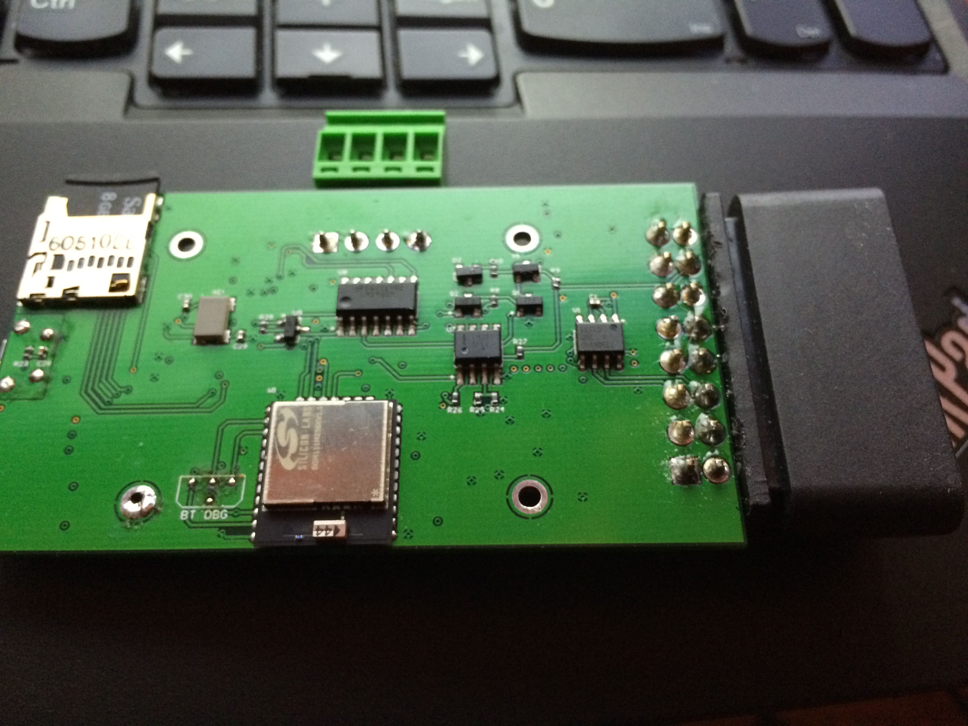

Re: LS1 ADX V1.6 to suit Tunercat OBD2 Cable, AVT 852
AVT interfaces? How passe'
Coming soon....
Coming soon....
- Posts: 10111
Unless this is AVT compatible, I think it needs to be split to a new thread?
