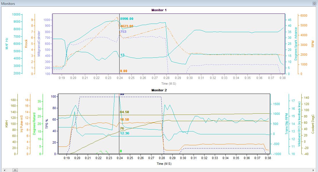

trikky73
Posts: 72
Joined: Mon Feb 13, 2012 8:22 am
cars: VS V6 Sedan
Re: Extended Factory Bins
Post by trikky73 »
All I can say is that the extended bins rock, I have dropped just under a second in my 0-100 times with my time now being 7.6sec :punk: just by going to the extended and having that bit extra control over the spark. My peak airflow has also gone up from 746 to 754 once again just by having the extra spark tables
