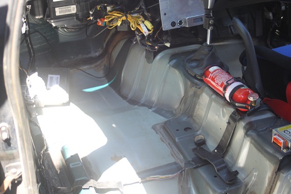

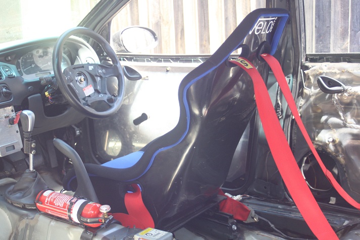

In the last pic i extended the shifter shaft to make the reach easier when buckled in the seat.
Prepsol'd the floor to get rid of the sound deadner leftovers and added the fire extinguisher
Battery position label also fitted.

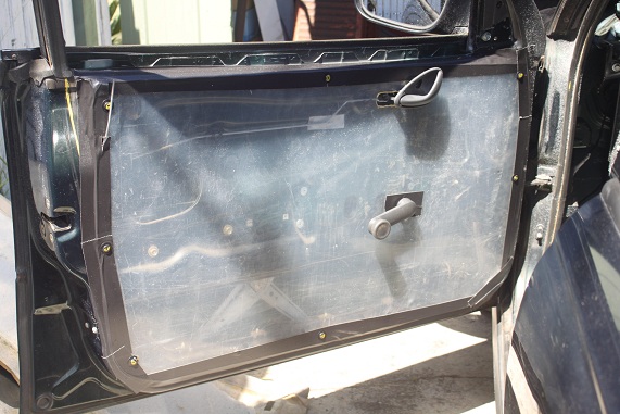

I went to a mates shopfitting factory and he cut up 4 pieces of acrylic offcuts.
I fitted up the fronts for now and will paint them later.

Thats as far as i got so far......roll cage will most likely be ordered next month or february.....i'd like to make my own but time is the killer and i'd probably stuff it up :think:

I wouldn't use acrylic for door cards - I wouldn't use it for anything inside a track car.
Acrylic shatters into sharp bits, so a decent hit on the door could put an acrylic shard through your body.
I know CAMS doesn't allow acrylic windows, but not sure about it's use in other areas.
Polycarbonate (lexan) is much safer - but not as cheap as free offcuts :?

Festy,believe me i'm with you on this. just drilling the stuff with pressure causes cracking and i hesitated to even put it on the doors,especially on the drivers door
as thats the first thing on my mind (shattering).CAMS makes no mention of using it anywhere else except the windows.
I cut them out and mounted them anyway and will use them as templates for either masonite,plywood,possibly a thin metal sheet (even metal is a worry)as 202T suggested.
I'm just weary of what damage can be caused on the drivers side.
