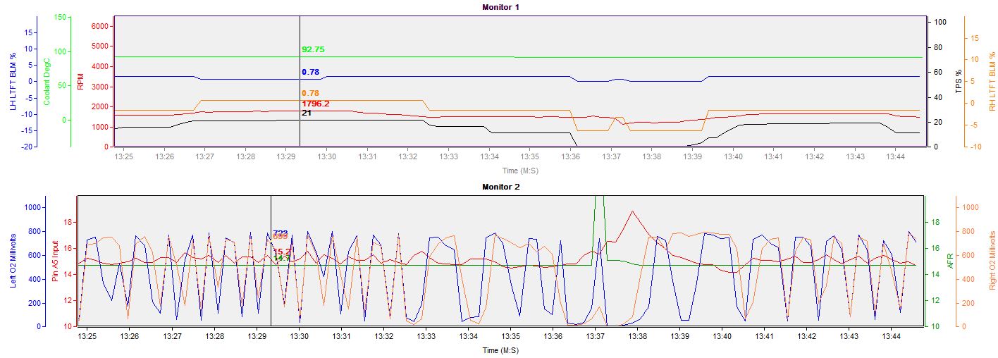

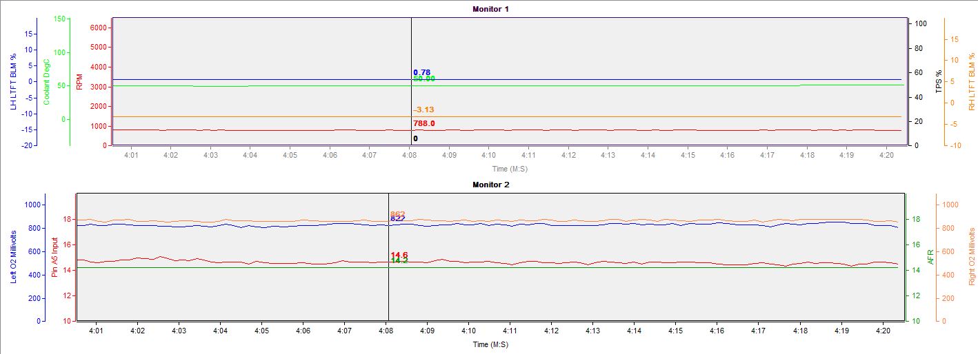

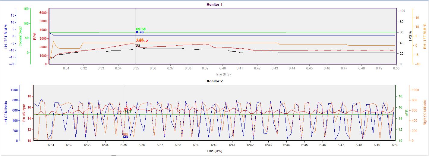

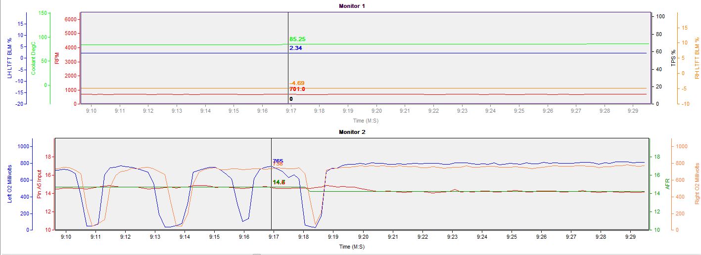

so I've recalibrated my o2 sensor and replaced plugs and lead which were long overdue for a change.. so it seems that the wideband is reading much better and most of the time reading the commanded AFR. There are spots early on when it just turns on where it tends to show leaner than commanded..
i think im pretty confident that my wideband is ok and doing the right thing. i wonder if anyone has any logs they could share with their wideband on a stock tune? my car is a vs v6 na- im running The1s enhanced bin on my NVRAM. it would just be interesting to see another log on a factory tune what the wideband does. should it be spot on or is the factory tune not that good?
just say i had an exhaust leak which i quite possibly could (i suspect in the y-pipe after the exhaust manifold and before the wideband sensor) would the effect of this on the wideband vary with speed the car is moving or coolant temp? because what im finding is that as i get further into a run the wideband reading tends to get much closer to commanded in both open and closed-loop idling and closed loop fueling in driving.charlay86 wrote:Try swapping the wideband into a narrowband hole, if things improve it pretty much confirms exhaust leak theory.
