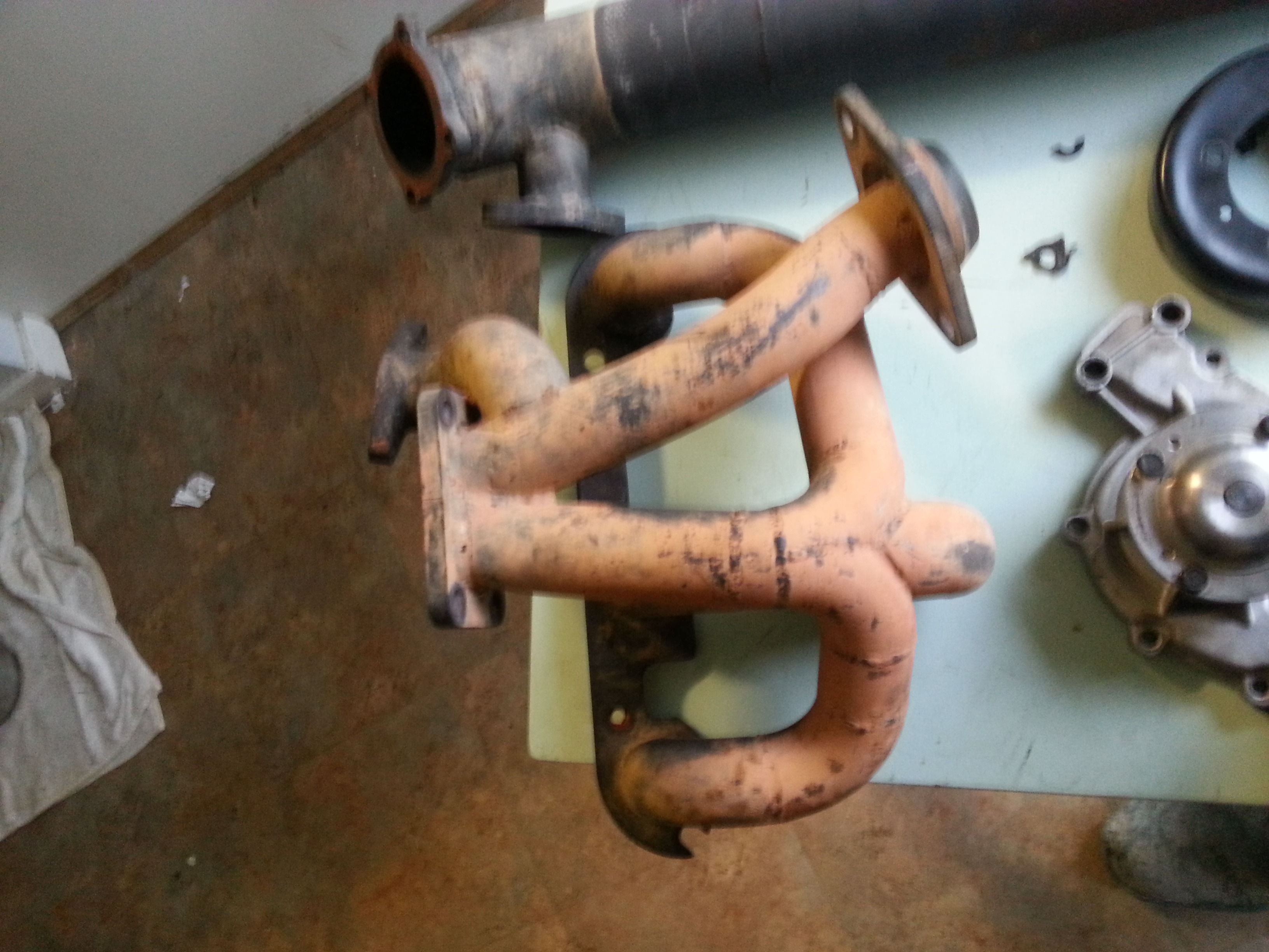

That small pipe just under the flange on the right side that curls around is the wastegate pipe.
Tonight ill get my turbo and dummy it up so you can see how the setup fits together etc. I think tye problem is the wastegate wont be able to bleed enough preasure off due to onoy feeding off one side of the engine

your turbine housing is a single hole so it is letting pressure out of both banks just not efficeintly.you will probably find the housing is way to small and the exhaust wheel inside it most likely is quite small.you could fit a second wastegate in the same manor as the other gate to help flow enough and it will suit the bigger split turbine housing turbo if you change turbos and fit a new flange on the manifold later.
the worst thing about boosting from low rpm is it strains the bottomend harder with the extra load on the crank and bearings at low rpm and detonation mostly happens high load low rpm
if you have the spanners and can handle taking the housings off the turbo rip one off at a time and measure the wheel sizes .

Ok thankyou, I just whipped the rear housing off after reading this but cant seem to find my vernier calipers so measurements may have to wait till I can find them. How good do you think my chances are of finding a larger a/r housing to suit this wheel? Is it even possible to use this wheel with a different a/r housing?
It seems to me that if I have to change the whole turbo I may as well flog this gear off and make the manifold and dump from scratch to avoid all this modification and trial and error. Got my new mig welder now, its a uni mig 180 so perhaps I could sell this stuff off and buy some pipe with the profits.
Even if it boosts early and strains the engine more, and as a result means I change engines more frequently do you think you could tune, or advise how to tune around that? Perhaps just more fuel and less timing in low-mid revs?
Re: vn v6 turbocharger choice
rich to start with and less timing is going to be the best way to keep it safe, if it was mine i'd be bolting it all together and see what happens, if it boosts straight off idle then yeah maybe you want to have a bigger turbo, and just set the wastegate to open on like 5 psi till you get a feel for it then slowly bump pressure up as you go.
