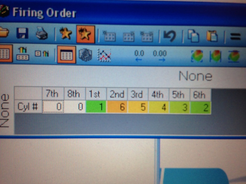

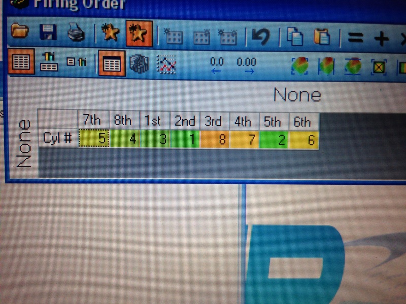

Std Gen3 firing order - 1st on the list is Cylinder 3
Here is where i entered the V6 firing order - i think ive stuffed up here

I remember reading somewhere this doesnt actually change the order the injectors fire in... that is hard coded. all it changes is which injectors it percieves as left bank and right bank for the fuel trims. you have to figure out the hard coded order it fires in and connect those outputs to your injectors in the correct order. this wont help it start however, as I said the injector firing order will not prevent it from starting.... VN's fire all injectors at the same time, all cylinders are at differnet points of their strokes and it doesnt affect it.

The Ls1 Ecu's fires injectors sequentially and its a VS Ecotec engine..

Re: V6 ecotec 3800. Tuning ls1 Pcm
Yes they do fire sequentially, but what Jayme is saying is dont get hung up on the small backfires and injector order. Engines run fine with all the injectors firing as a batch without backfiring. Its just that they can run a little better with sequentially fired injectors.
