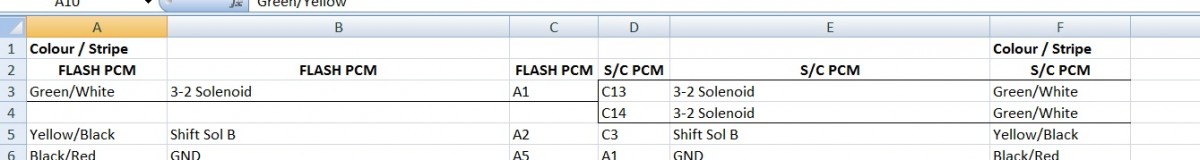

A question regarding the spreadsheet for Flash to S/C PCM conversion. For example with Flash PCM pin A1 to S/C PCM does that mean the wire is doubled up for pin C13 and C14?
Thanks

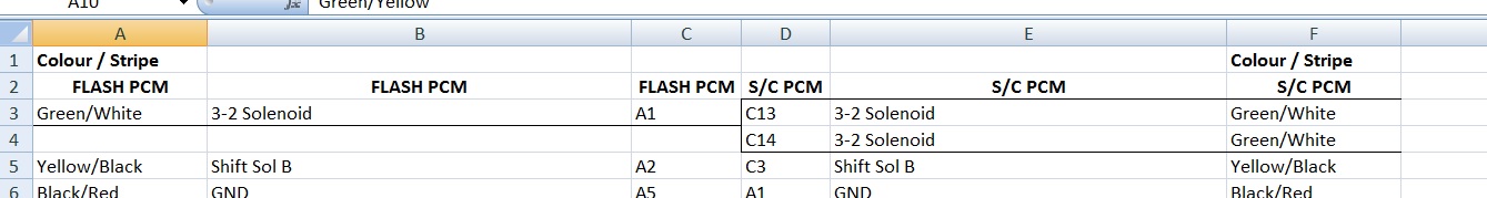

Re: Replace Flash PCM With VX/VY S/C PCM
This might explain it a bit better for you.

Yes, that pic explains it well. Thank you
Posts: 4811
yep the 2 lines are multiple on other pcm and single on the other which are the same thing.
