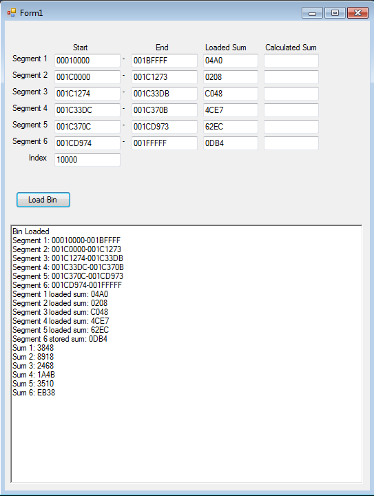

Hehe, heres what I implemented tonight. Back to figuring out the checksum calculations next.
- Posts: 3627
- cars: VE SS Ute
- Location: WA
Re: CRC's..Checksums.. Reverse Engineering!
Good thinking, Ill do something like that as well.
Just put something similar together.. looking much better nowantus wrote:Hehe, heres what I implemented tonight. Back to figuring out the checksum calculations next.
The backwards iteration crashed at some point last night.. *sigh*, I dont know at what point it crashed so Ill be starting around the 1/3 mark again.
I think I should do the same as you Ant and focus on the smallest section possible, will cut down processing time by a tonne.

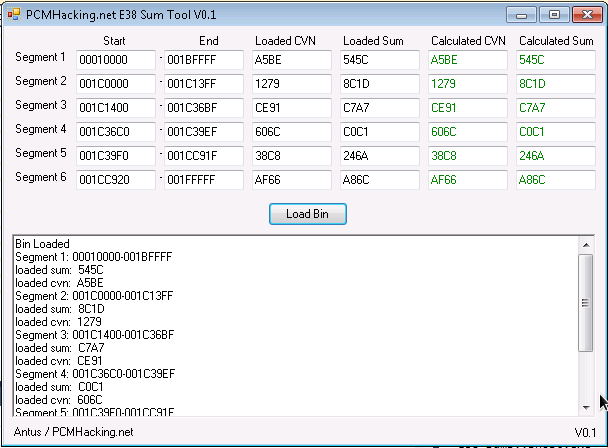

Ok. The CVN is a CRC16, and the sum is a 16 bit 2s compliment. When calculating the data you need to update the CVN first, as it IS included in the sum. The CVN is not a derivative of the sum (or directly vice versa).
Makes sense really as the scan tools (or PCs) can verify the CVN after reading the bin for warranty test purposes (that's why its in there), but the PCM only needs to do the sum which is quicker in an embedded system like a pcm. CRC can be accellerated with a lookup table, but they are probably looking at it from a space savings angle in the pcm, and its not really needed anyway.
Next steps, figure out how to ID each segment type, handle disabled sums and segments, handle differing numbers of segments, and add partnumber/ID strings.
Also, put this login in to a TP checksum plugin. Probably merge the delco checksum plugin, ls1 checksum plugin, and e38 checksumtool in to one TP5 checksum plugin.
Whos keen to help work on XDFs?
