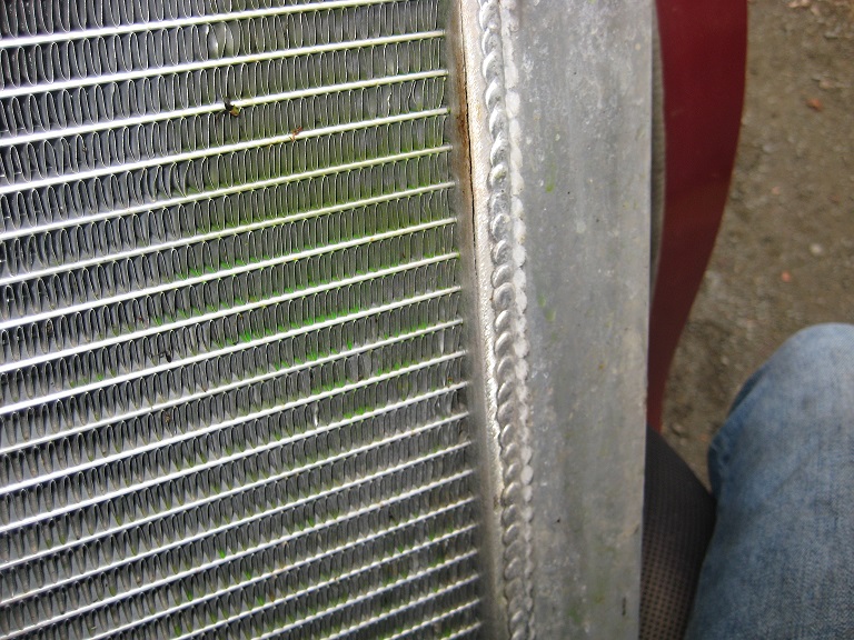

BUT! For some reason I randomly decided to pour in some more water I had in the boot to see how much it had lost. 1 litre later it start leaking onto the road!
From the radiator! Now double WTF?!! It has a fucking massive 3" split in one of the alloy tanks! Now fair enough its a Chinese ebay special.. only 13months old.

Re: VK T5 L67
That's no good man, certainly sounds like head gasket or similar to pressurize the coolant system enough to pop the tank!!
Would explain it not running too well also!
Hopefully its not a big issue but at least you can blame the missus ;)

Re: VK T5 L67
that sucks man!
that's an odd spot for the tank to split too!
not sure if its anything similar, I had an alloy tank in my torana a while back, ended up getting a few leaks in it and turned out to be stray current, totally stuffed the radiator, heaps of pin holes in it, maybe similar for yours.
hard to know though, could just be the comp in the radiator was enough to blow the weakest point.
Posts: 3676
Re: VK T5 L67
Someone might be able to weld that up rather than having to replace it.
