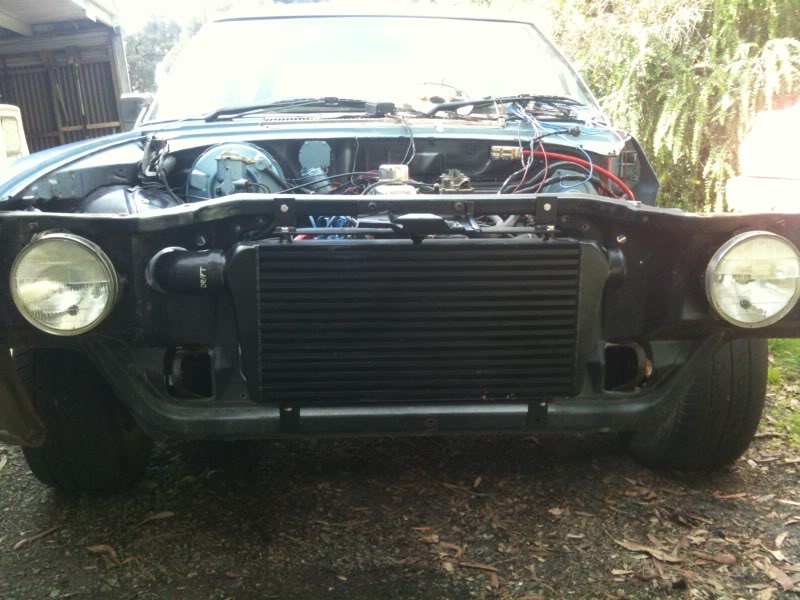

Hi holden202, just thought id drop a post to show the latest on my 202 conversion :)
I finally got around to installing my front mount inter cooler and its looking quite tough, the grille and bumper hide it entirely so it's nice and stealthy :punk:
it did take some effort to get the 3 1/2" holes in for the silicone hoses though.
I finished wiring my mechanics new shed at home the other week so the engine should be back on the boil again soon with all its delco/turbo/intercooled goodness
