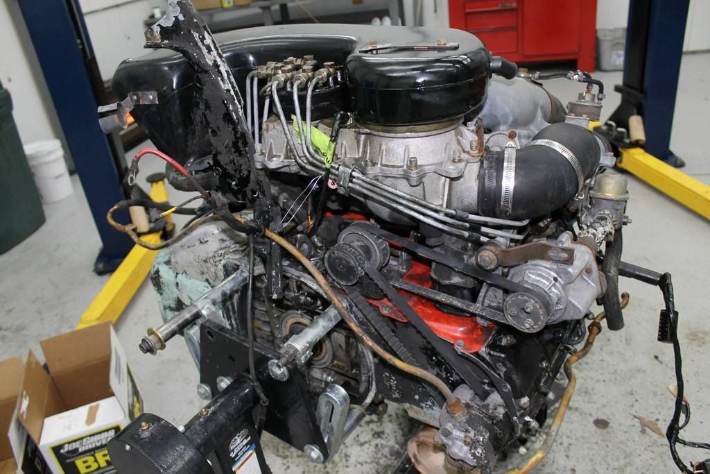

it will be a serious undertaking. just look at the amount of stuff to consider when deleting the MFI. appears to be drive by the passenger cam at the front of the engine ( back if you look from engine bay)
it will be a little more complex than converting a carby car from scratch, but well worth it. it would probably 1st of its kind in the world?
I pinched this 930 engine pic, from a guy I know of thats rebuilding this one.
