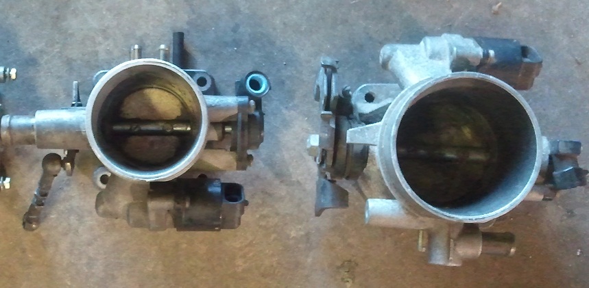

re: throttle bodies, I think the Camira has a smallish oval shaped TB. Here's a Pulsar and commodore TB, you can see there's a pretty big size difference:

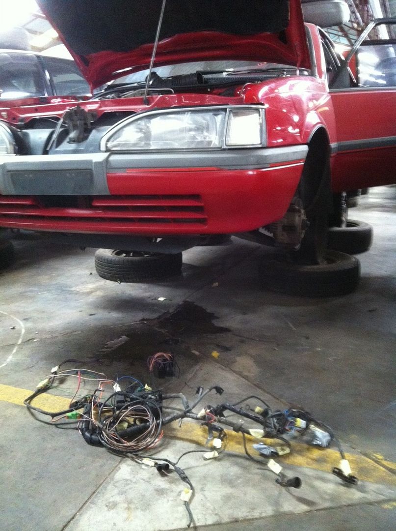

Good day today, picked the mint ECM loom out of this JE Camira including all relays , senders (except exhaust oxygen sensor as that was not coming out for anyone), sensors and coil for a whole $33. Also grabbed the fan relay and wiring loom for the rear fuel pumps as far as the dash.
This is the donor car and it was very clean inside and out and I only got really got my hands dirty taking out the coil as the distributor must have been leaking oil. I reckon I was the first person to take anything off this car.
Question, is the VN V8 throttle body similar to the V6 but just bigger? I assume it is bigger. My thinking is that the 265 hemi is a 4.3 litre, the V6 is a 3.8, the V8 5.0 litres so its kind of in the middle. There are thousands of the V6 throttle body but the V8 would be harder to get and probably pricey so I am quite happy to go with a V6 throttle body if it will keep up.

That's a steal at that price good work! The V8 throttle body is identical just the bore size. 60mm V6 65mm V8.
I guess if you fit a V8 one straight up no need to worry about it.
Or get a V6 one and have it modified to 69mm! Most places do them on an exchange set up.
