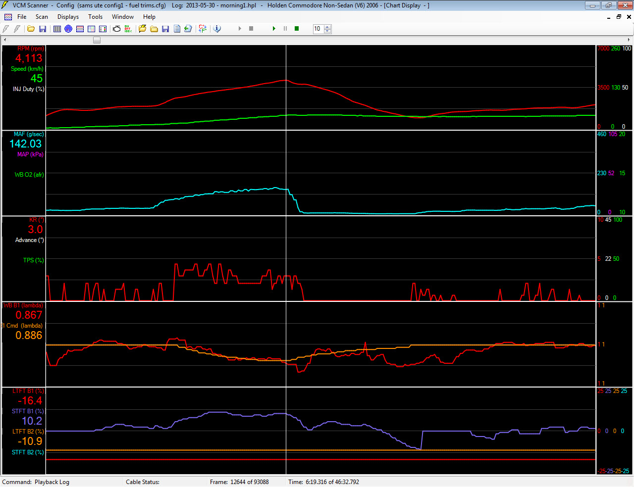

ok found what I used to use, it wasn't SAE.
can see wb lambda b1 and lambda commanded.

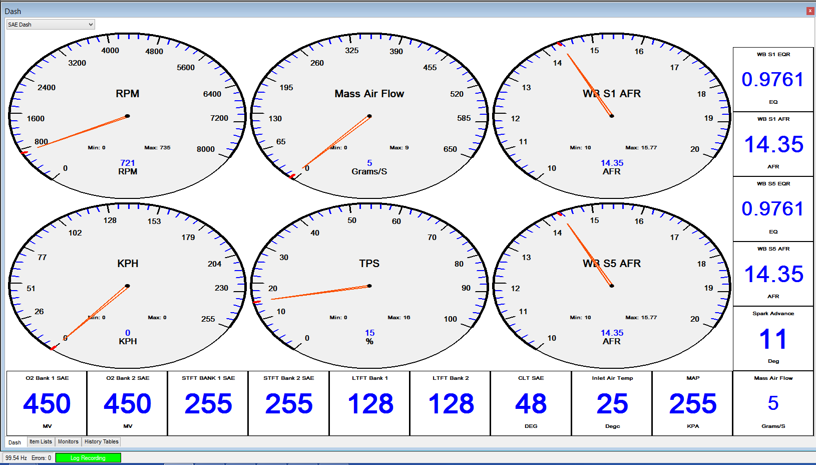

well that was unexpected.... I finally mapped out my items into DPID's. I skipped wideband2 as they are 4 bytes each! (and each DPID holds 7 bytes) and I wanted to keep it down to 3x DPID's total for speed sake. turns out that doesnt matter on alloytecs. you get 33hz per DPID.... so one DPID gives 33 hz but im pulling 3x DPID's I get 100 hz
see the extra fine detail 100hz (33 complete data sets per second) gives you. razor sharp needle response.
Re: SAE CAN ADX for AVT cables
that certainly looks better.
