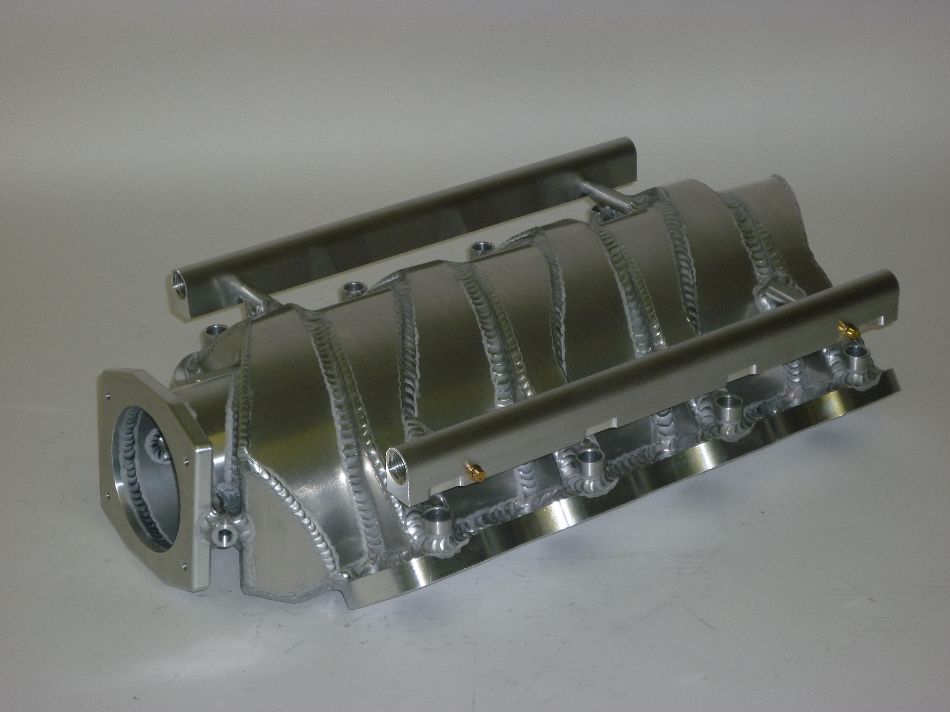

Check out hogans manifolds. There make custom sheet metal intakes and are known to be the best. They even have listed an LS banana manifold entirely made from sheet.
like this. Checked their prices, cheaper than group a and huge variety.
http://www.hogansracingmanifolds.com/im ... 75__2_.JPG
