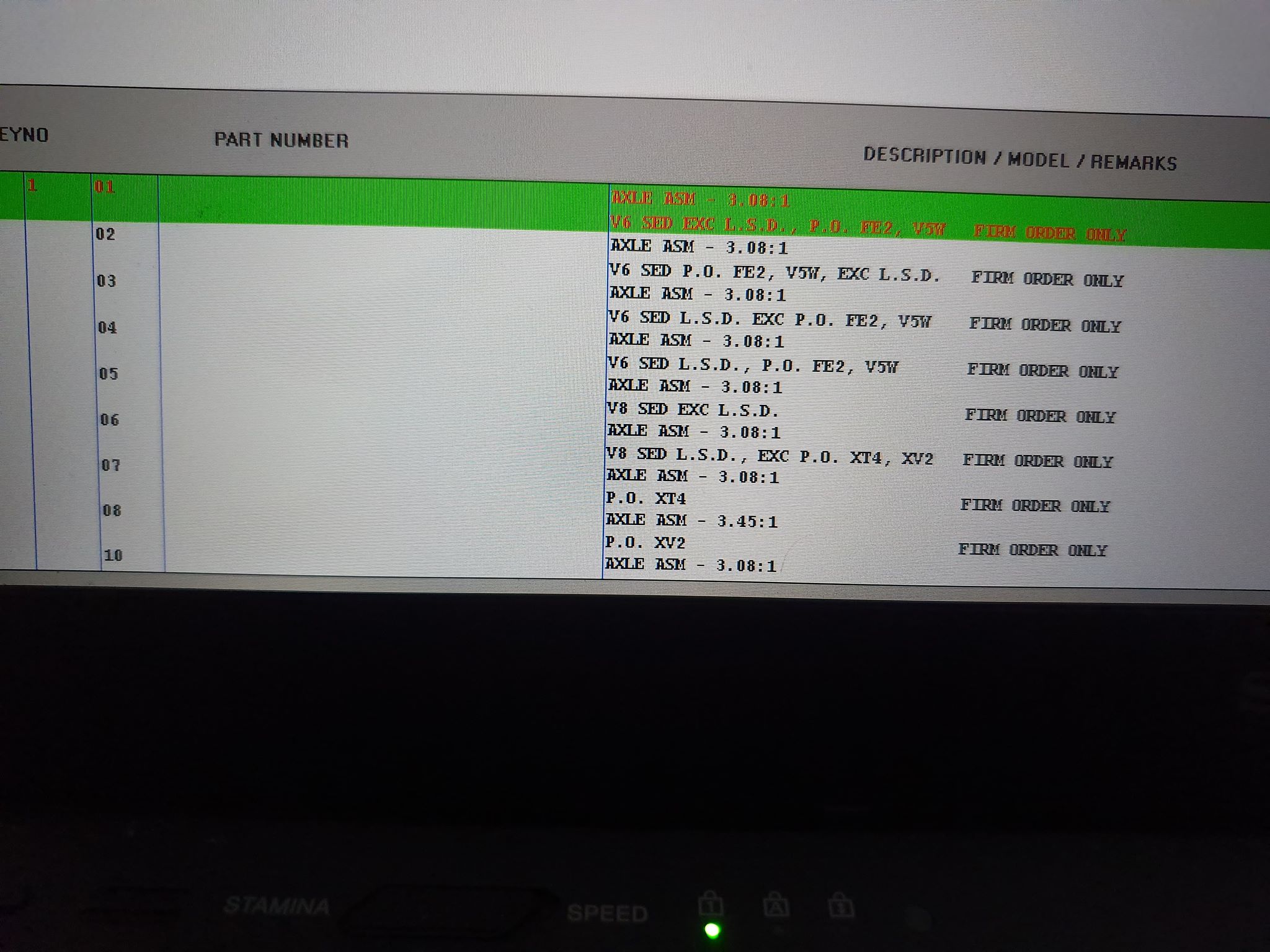

A mate just sent me this for VN. Apparently there is a few axles they made for them, even a 3.45 version. Might be something to this.
G, isn't you VP exec a factory 8? Can you measure the hub to hub with disks on?

I may be wrong but that looks like a list for the complete Assembly not just Axles.vlad01 wrote:A mate just sent me this for VN. Apparently there is a few axles they made for them, even a 3.45 version. Might be something to this.
- Posts: 8600
Re: Performance diff info thread.
Yeah complete diffs. I though there were only 4 possible combos. Ute/wagon with an without LSD and sedan with and without LSD.
According to that there are V6 and V8 versions which might be the width, I can't see what else would differ.

When they start mentioning things like FE2 in the listing it could be something like different bushings, there will be tiny differences. 3.45 may or may not have actually been available, could have just been on paper. Also ABS options could have been part of the listings even if not available until later. The odd one might have been lucky enough to get shotpeened gears or something like that too, I still can't imagine any different widths.
The listings in the spreadsheet don't separate VN/VP from VR/VS very well but there are dozens of different numbers. Sometimes they just change numbers because a production process has changed somehow.

VN GRP A was a VL width diff with 3.45 gears if I'm not mistaken. As above, shot peened gears for the V8 models.
