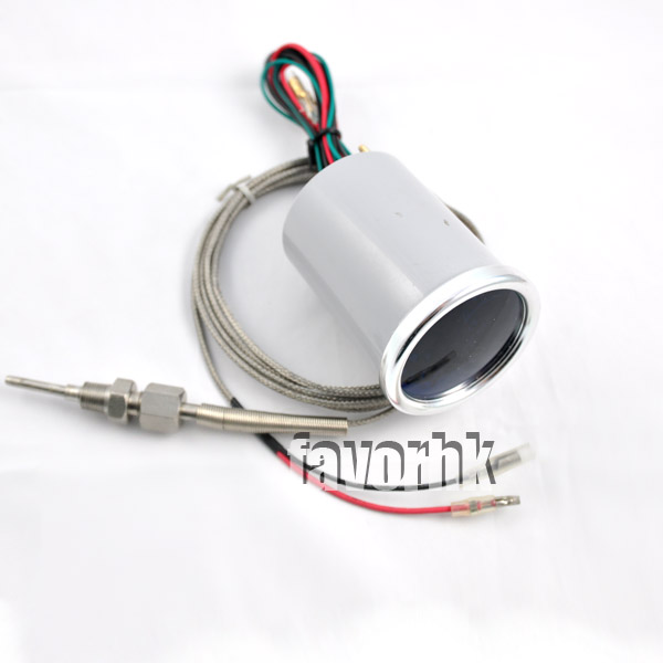

got a new toy last week was so cheap i had to get one. china special egt gauge and sender was like $20US or aud posted http://cgi.ebay.com/ebaymotors/Universa ... ccessories need to get it installed but have bench tested it and seems to work

Re: DELCOS NEW RIDE
so when you getting the other five???? hahahaha
Re: DELCOS NEW RIDE
hes installing it after the turbo to see if he can melt the end off the probe
VNracer34G
- Posts: 345
- Location: Gisborne NZ
Re: DELCOS NEW RIDE
best i hurry up and finish his heads for him to make sure of itHolden202 wrote:hes installing it after the turbo to see if he can melt the end off the probe
