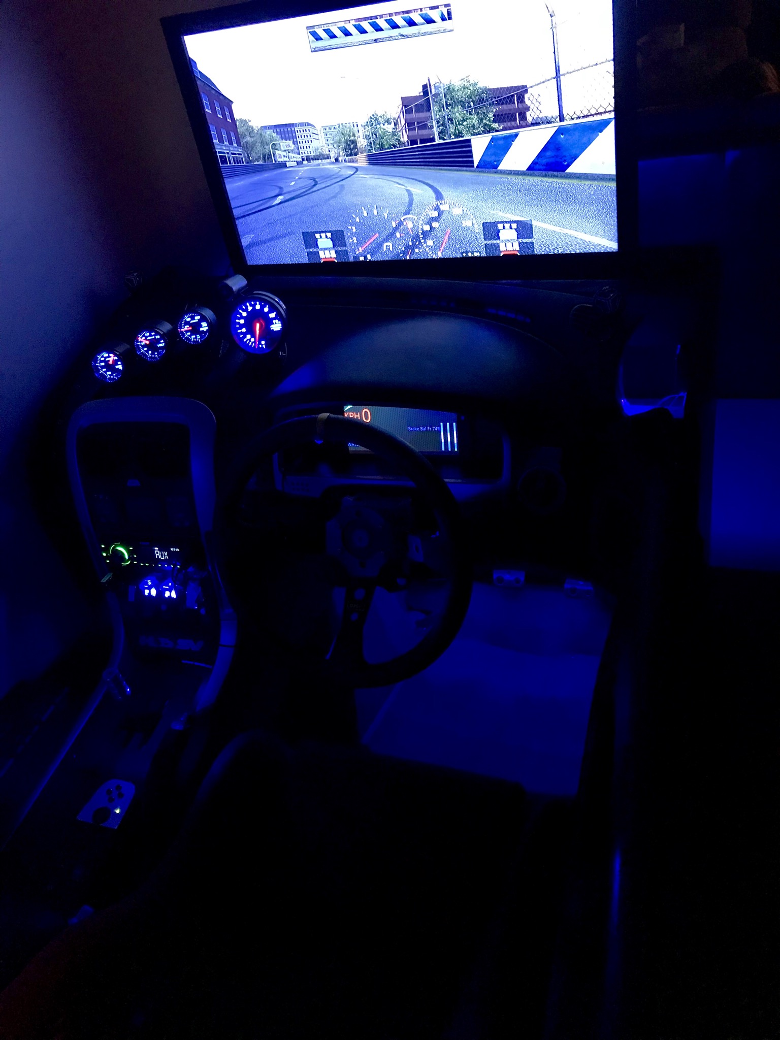

Re: My gaming rig
Just little updates lately.

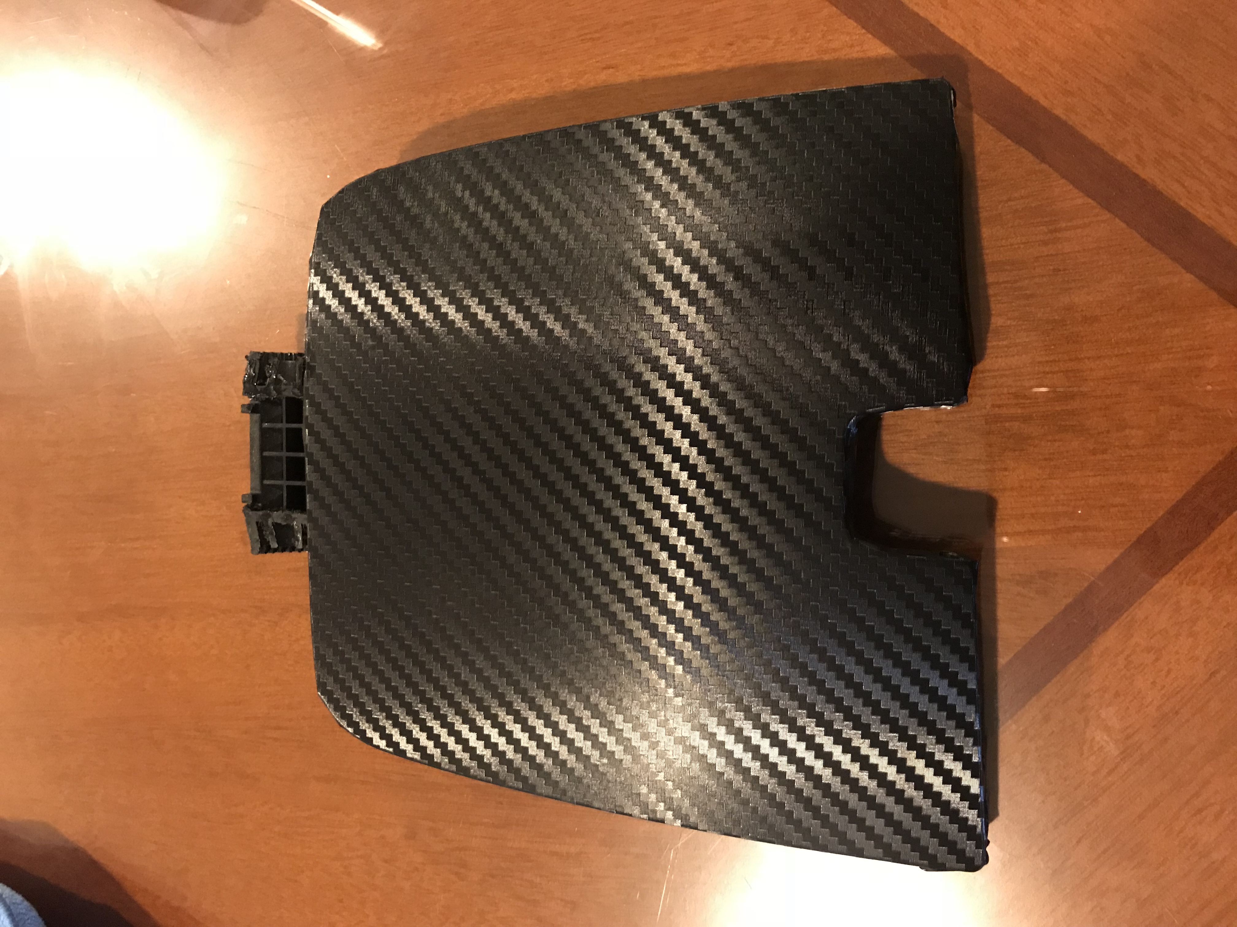

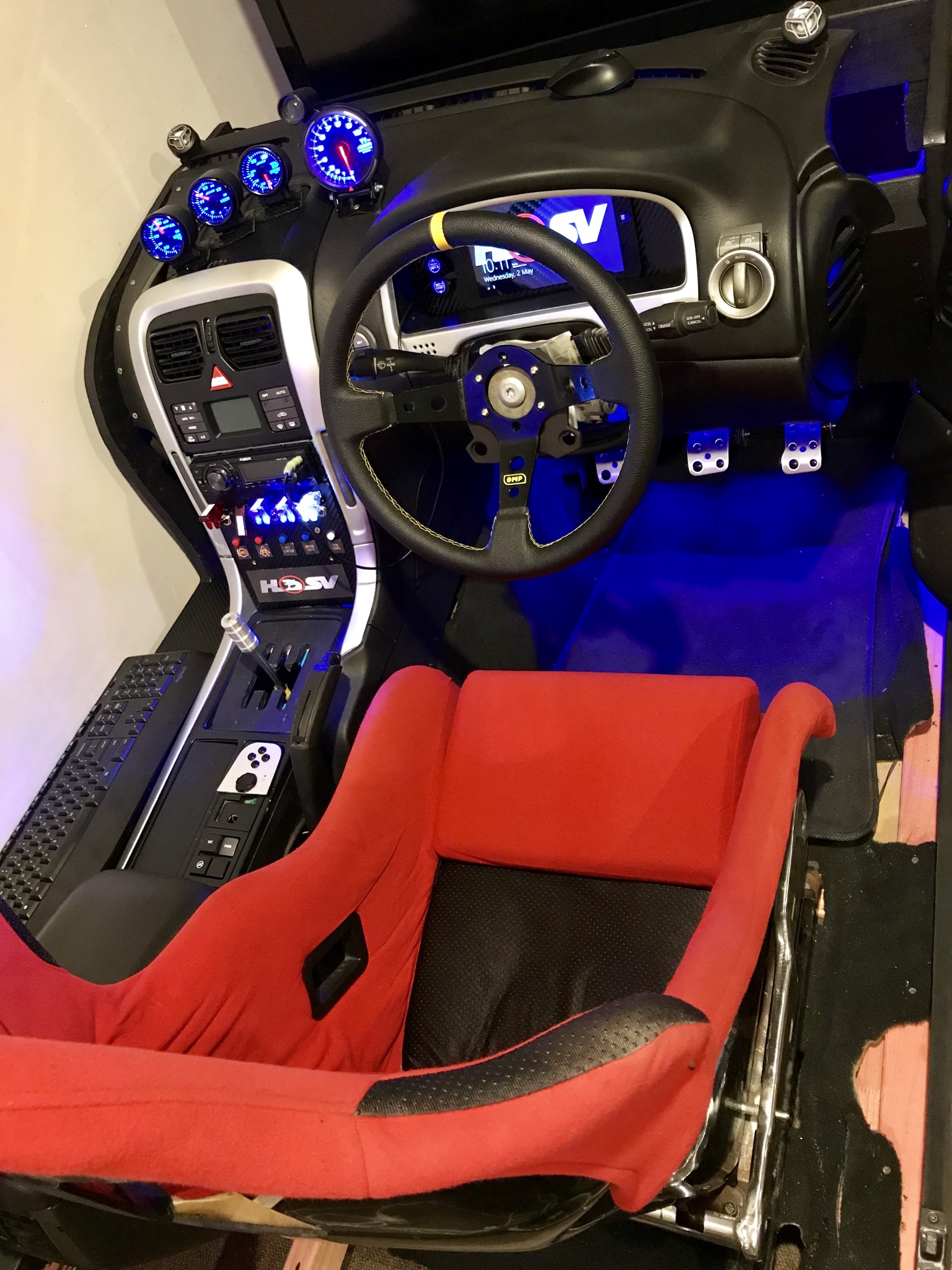

Got an old centre console lid I hate floating around to fill the void in the top of dash, made it look all nice with some carbon wrap
Also got some more gauges.
Water temp (running with a resistor on the sender wire to “fake” a temp as the games don’t output water temp)
Battery voltage (measures voltage at PSU)
And boost (works with turbo vehicles and shows TPS value in non turbo vehicles)

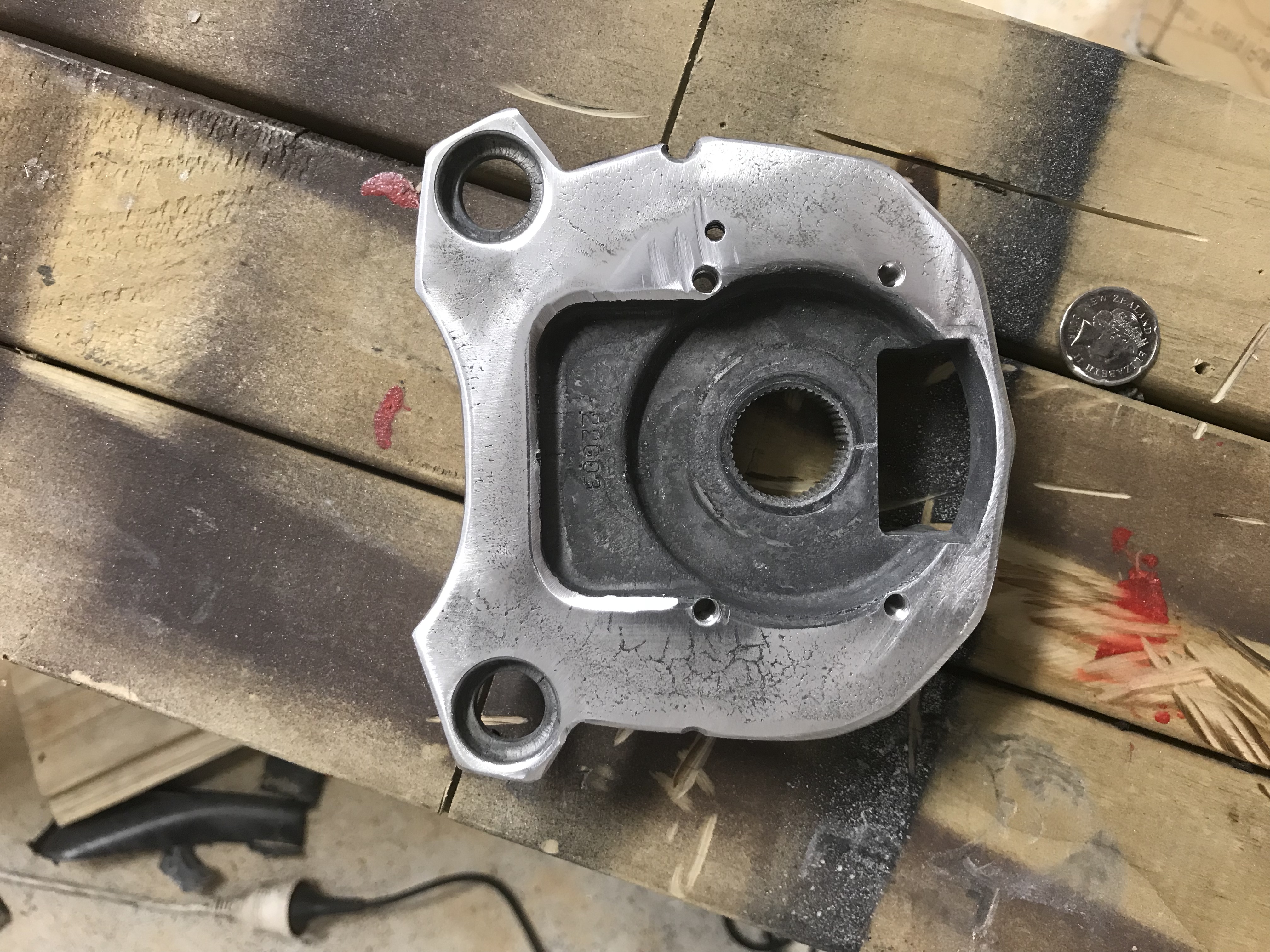

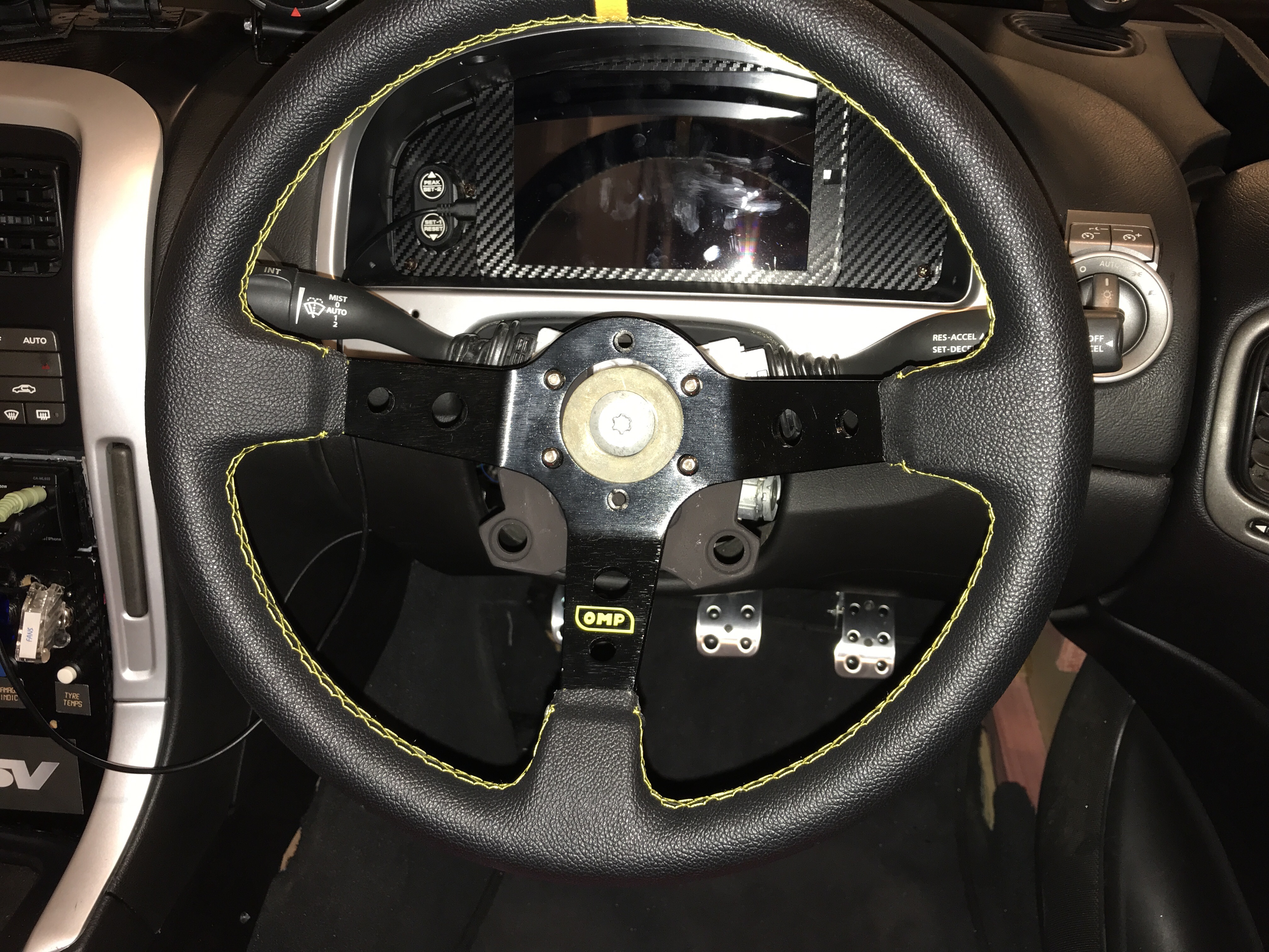

Also replaced steering wheel with a race type one and cut up the original wheel to use as a boss kit

Re: My gaming rig

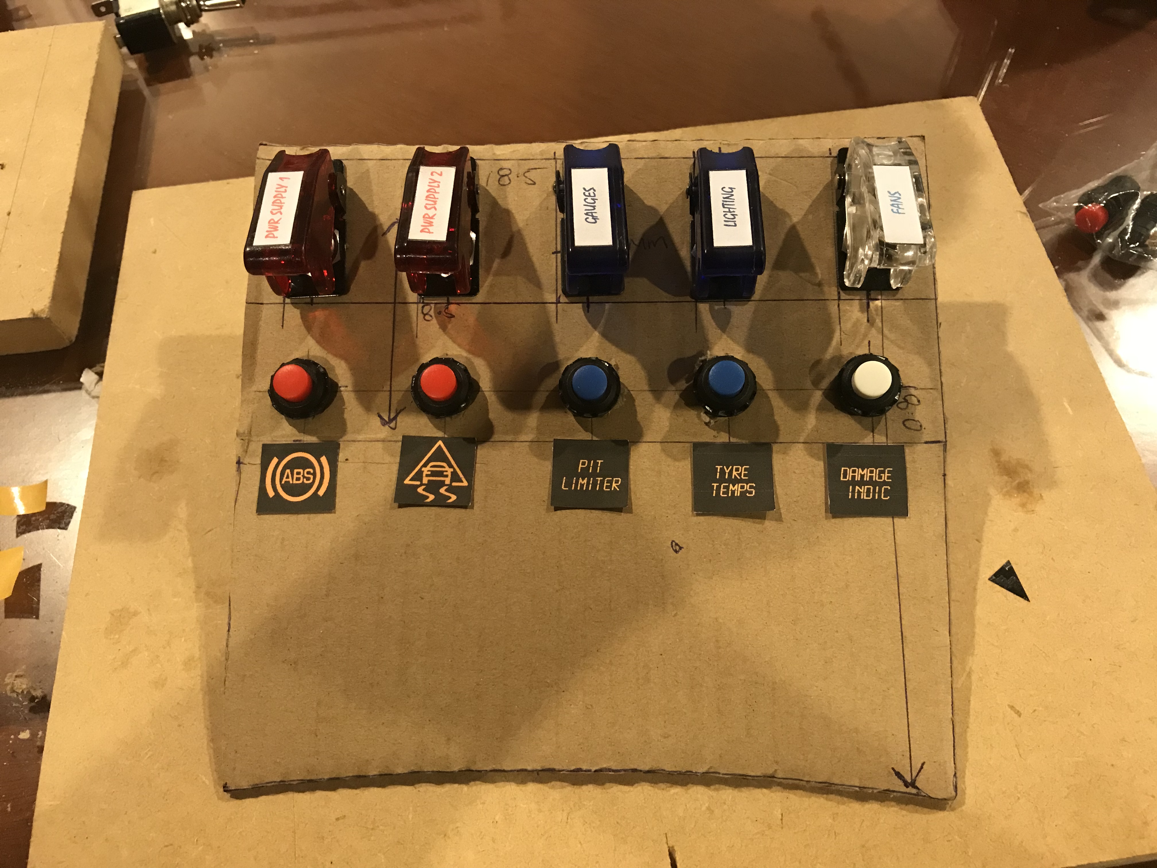

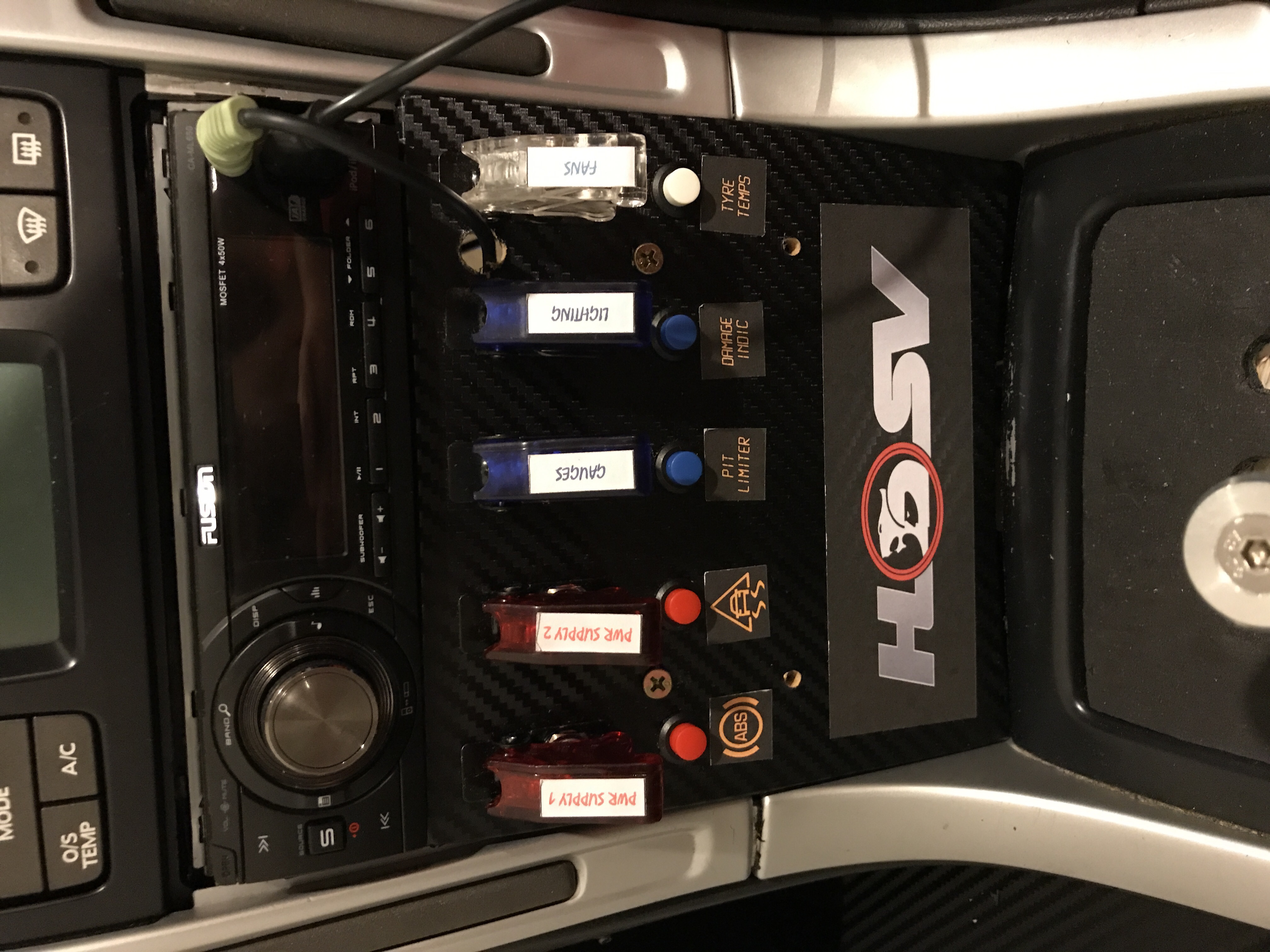

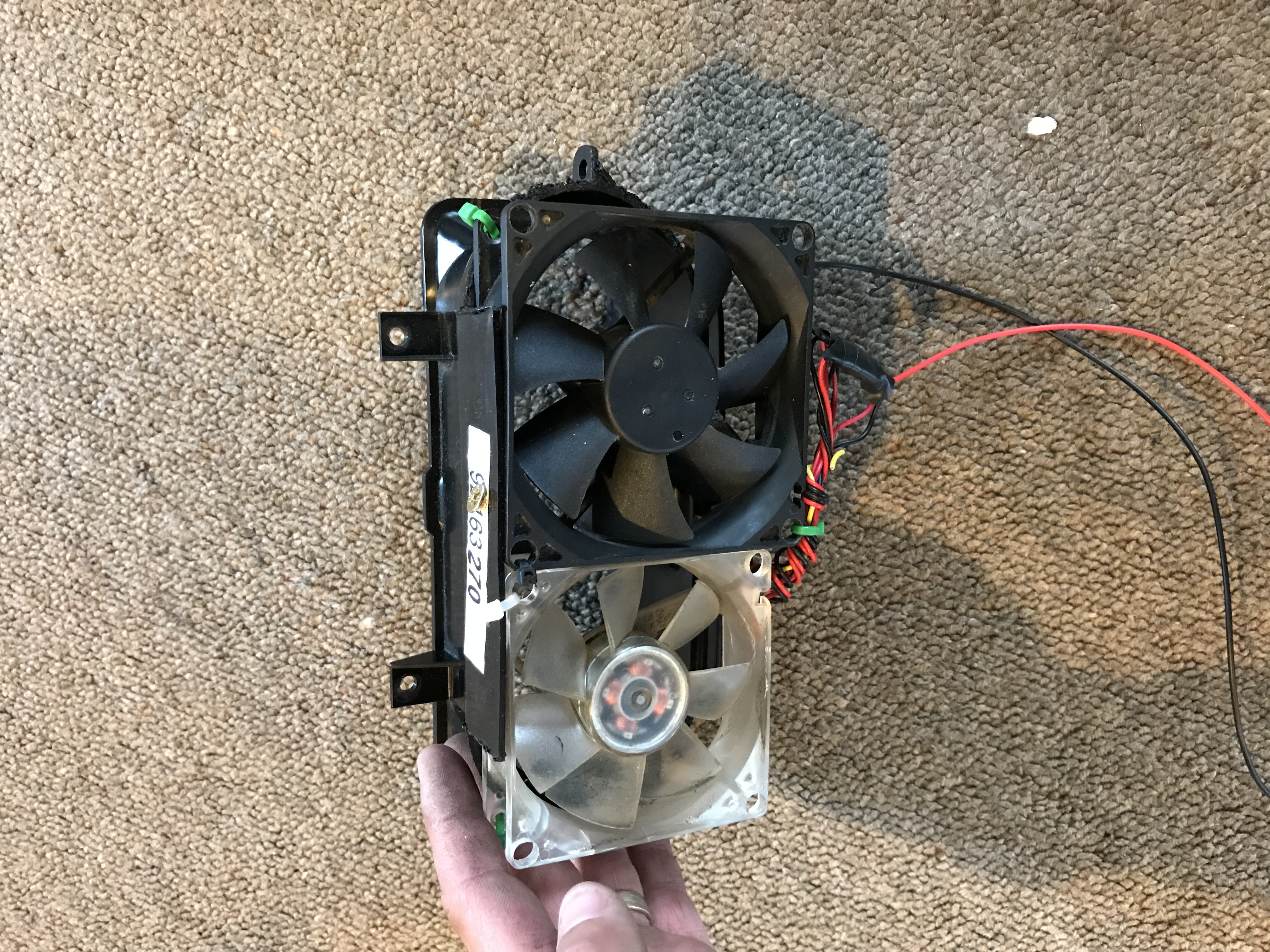

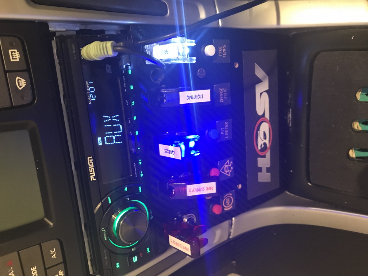

Built the first switch box for it that incorporates the toggle switches for
Power supplies 1 & 2
Gauges
Lighting
Fans
And before you ask, yeah they are actually hooked up as it gets super hot so flick the fans on and the air blows through the vents at your face haha
Gauges
Lighting
Fans
Re: My gaming rig

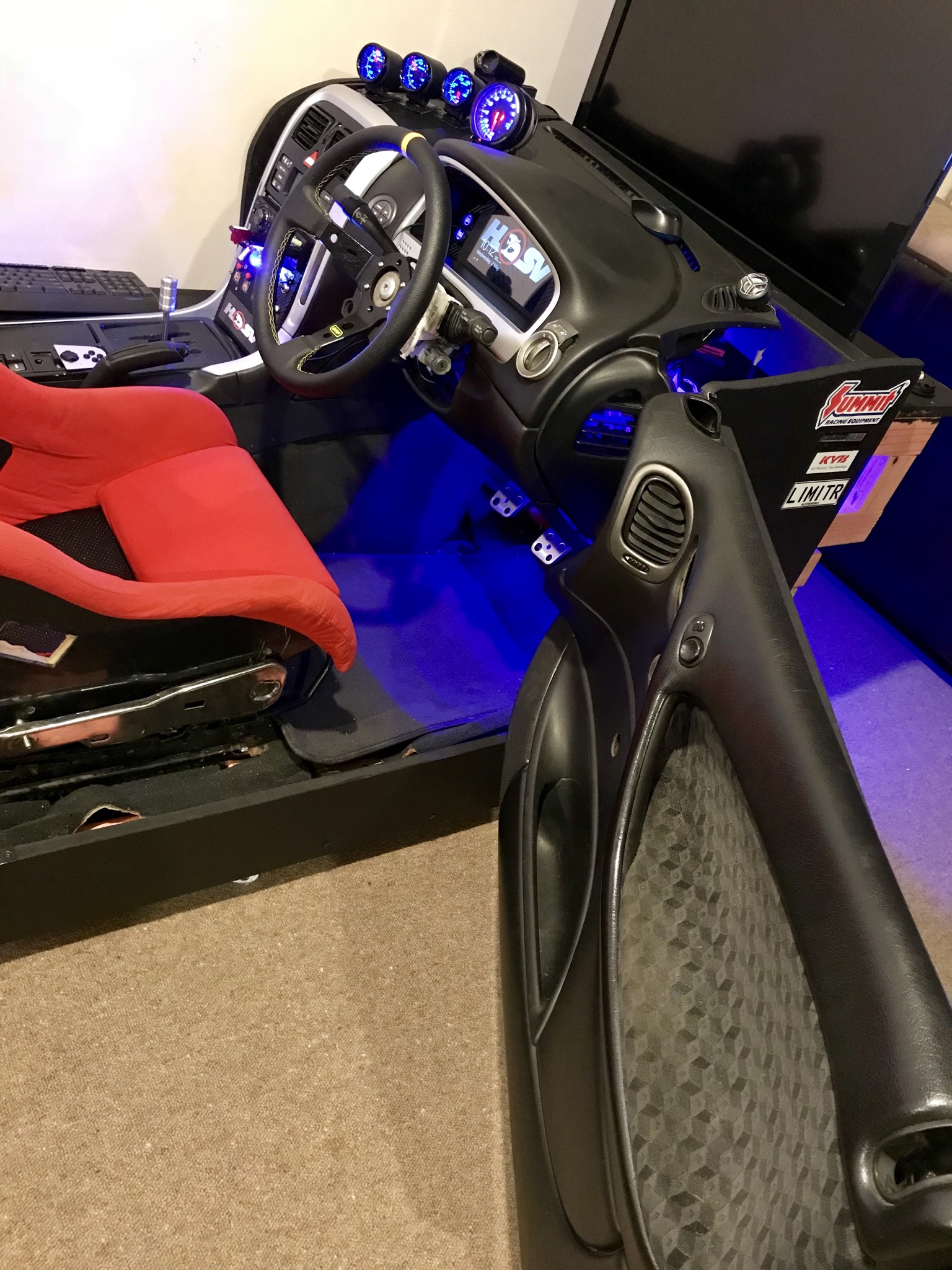

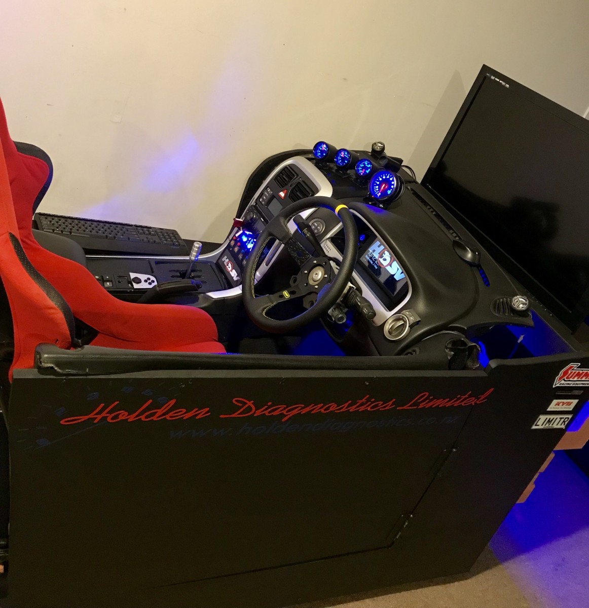

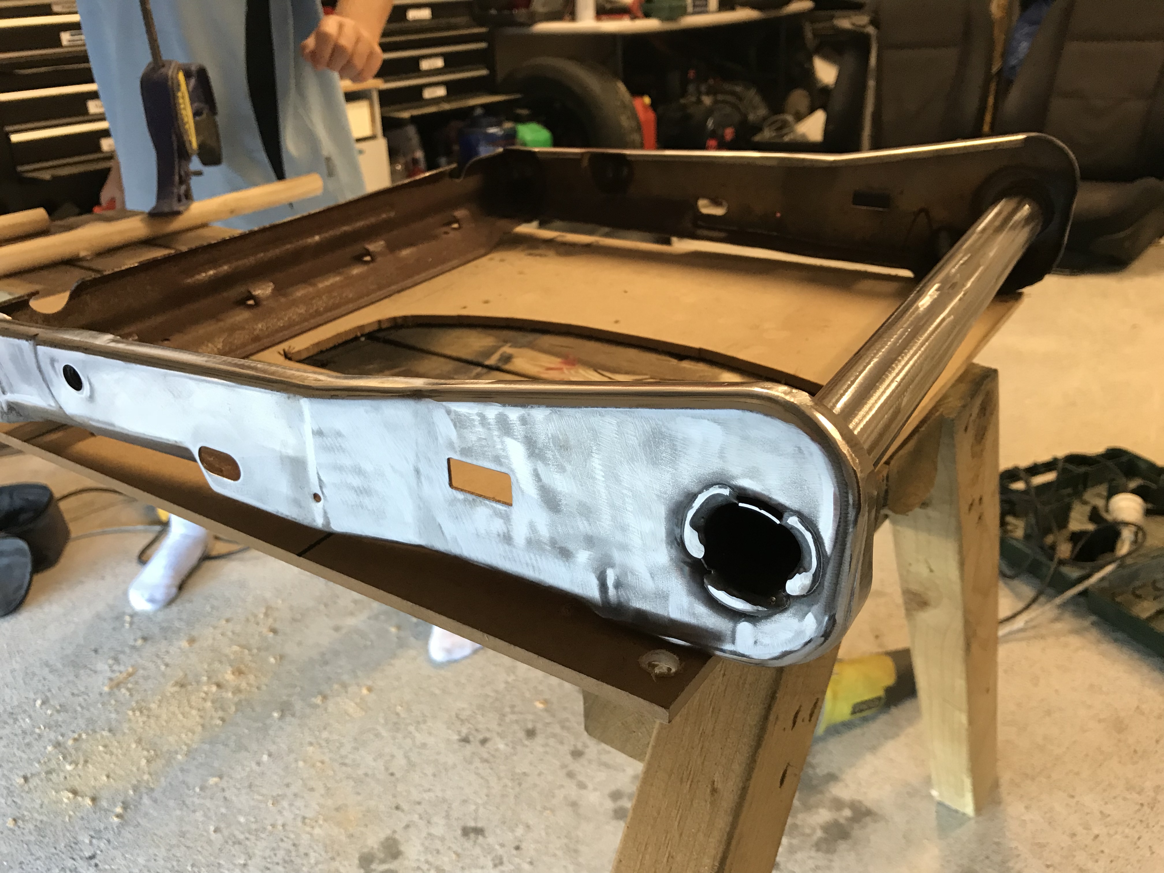

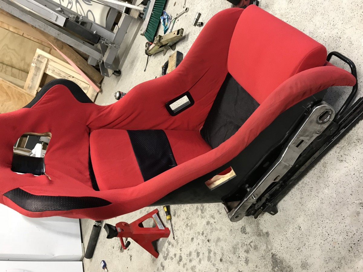

Have now also removed the old seat, used the rails and fixed the bucket in. Also makes me realise just how fat my ass is getting trying to get in and out of it lol

still need to finish the sill trims but atleast it’s better than it was

Re: My gaming rig
that is bloody fabulous mate. damn well done.

Re: My gaming rig
I liked the old commi wheel it suited the rest lol but still cool lol
Re: My gaming rig
Thanks, yeah the commy wheel was ok, but it was such a large diameter the poor young fellas have to swing off it to turn. And was really heavy and hard on the peripherals. But looked cool haha

Re: My gaming rig
Excellent work, best homebrew ive seen.
