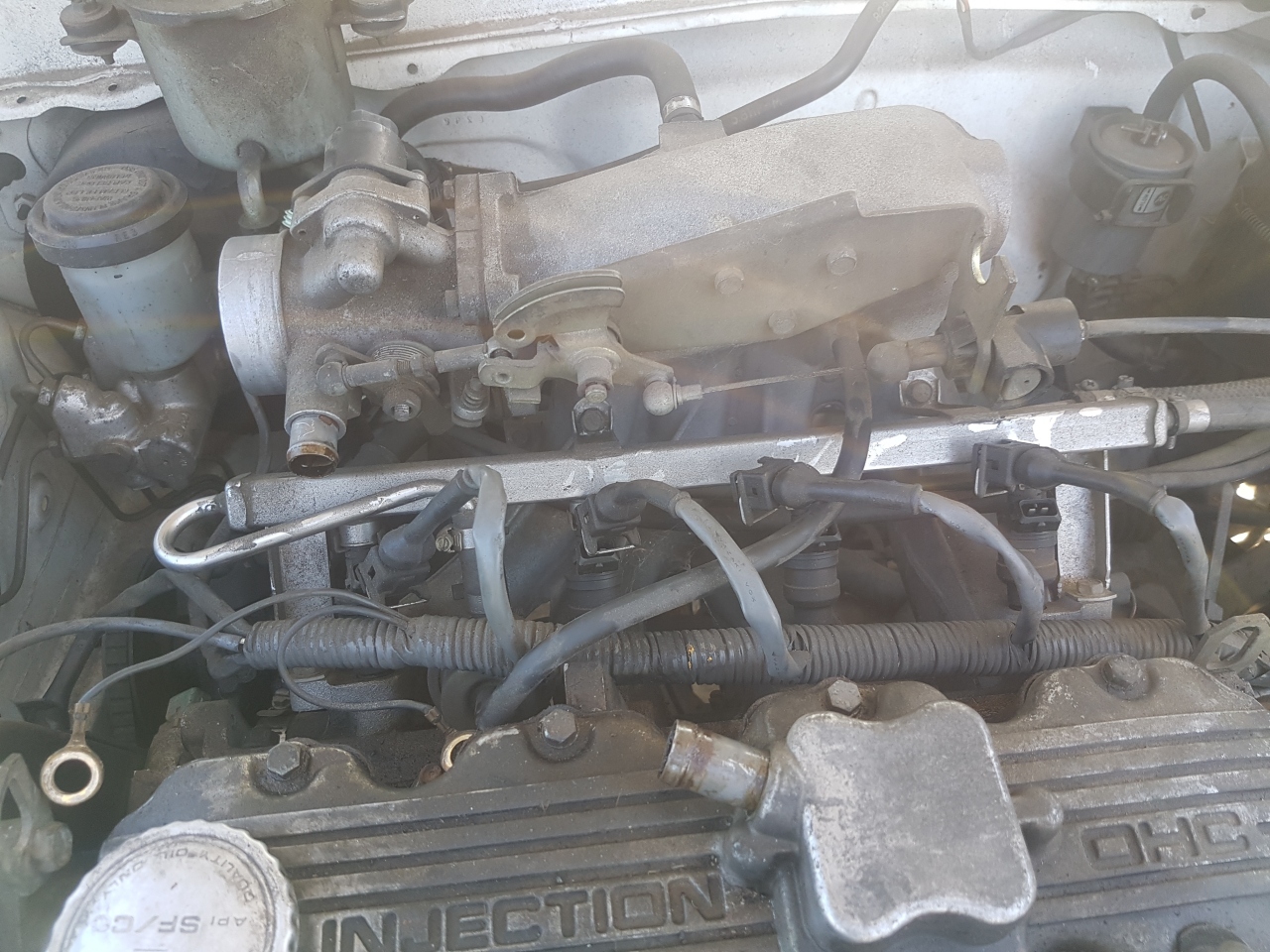

Im building up an Isuzu G200W turbo at the moment, and will be using an 1.8L N13 pulsar throttle body, and its fuel rail too. The 1.6L is TBI injection, but the 1.8L is MPI so you need that one for the TB and fuel rail. I have a custom manifold now which someone has made for my engine with a mild steel box on top of the original runners, and Im taking that to a fabricator for them to re-make the box part and cut n weld and fit the stainless steel fuel rail to my manifold so It'll fit the TB, its throttle linkage and will then be able to run the denso injectors The1 recommends in his thread. In my case that solves a lot of problems I had with the hardware I started with but you may be best just using that VX TB. The throttle crack enrichment and all of that is tuneable and not hard to sort out so expect some hesitation when you get started but you will be able to fix that in the tune by dialing in the VE and then the enrichment. You will need some kind of wideband to see that and correct it though.

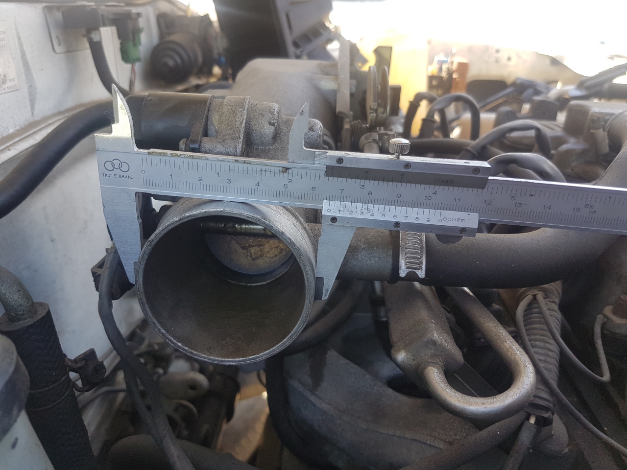

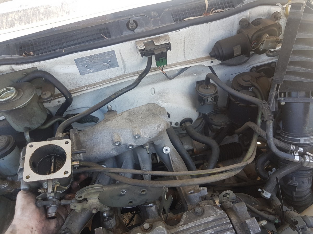

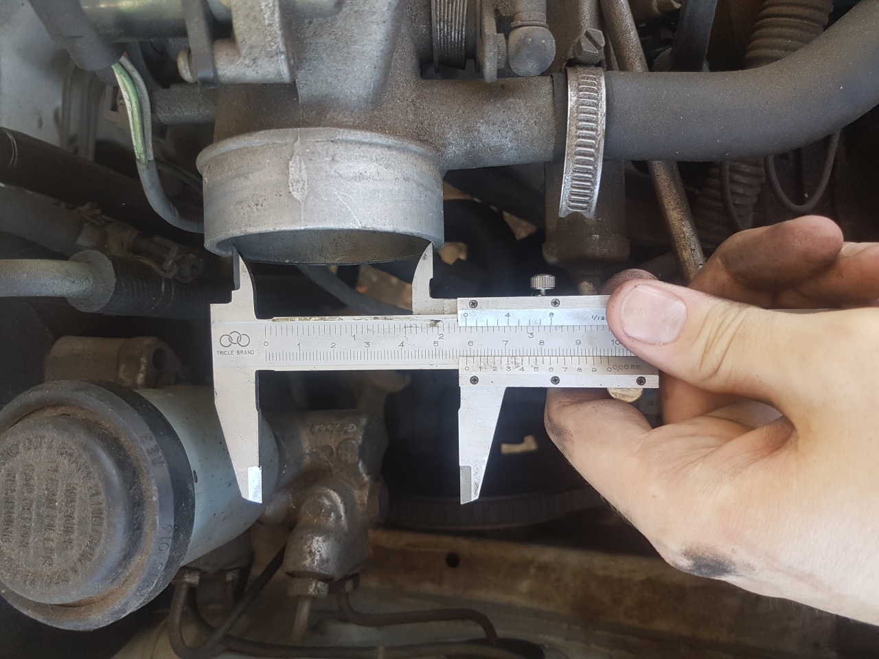

This is the engine bay I've been grabbing bits from. Measurements are a bit rough, but its what I snapped while I was in the yard. The TB is also wider at the front and smallest at the butterfly inside. If you could use this would depend on if you could adapt the throttle linkage to mount on the side of your manifold. You can also see how they mount the MAP in the pics. Bolt spacing on the TB is 60mm in both directions.
Then there is the aftermarket TBs on ebay, but they all say nissan TPS and list a model that was electronic throttle only, so cant be right. Ive seem threads that confirm they're all wrong but none of the sellers know. You could run one of those if anyone where can tell us what TPS fits. Then you'd cut in to this TB with an angle grinder cutting a V shape around the IAC and slice that part out of it, tap it and screw in fittings and install it around the aftermarket TB. On my road gemini ive got the stock TB for that engine, a nissan TPS with analog out (some are switch type only, some are both and you just use the analog part) and have used this configuration for a GM IAC going around the butterfly (whole TB actually).

I also just realised that one of the pics yopu posted has the sensor in it, on the firewall with hose attached! Might even see if I can get the bracket off the donor car as well.
