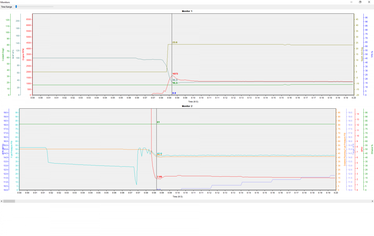

E85 isnt too bad when cold, but you need stacks of cranking fuel. Basically below about 20 deg C forget there is any ethanol when cranking, only the 15% petrol is going to light off the rest is going to do pretty much nothing. My 20 deg C PW is 48ms, stock V6 is 60 ms - essentially it is 60ms stock * 2 for not having the ethanol light off * (20lb stock inj / 80lb my injectors) * 1.5 for E85 = 45ms. Start with that calculation and it will get you close.

Cheers vl400. Only problem is, with enhanced I can’t get the cranking pulse widths long enough. After you adjust the injector flow rate, it seems to automatically adjust those tables and then using that calc it’ll the pw. I checked in the xdf to see if there was a limit or something I could increase but can’t see how to increase it. I know with the flash pcm’s you could increase the injector multiplier limit

adjusted the "Crank Table Scalar For Max Crank Pulse Width " scalar ?
