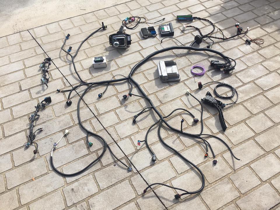

This thread is for VPW, but the same theories might apply to the e38, though there is a lot to figure out. viewtopic.php?f=42&t=7806&hilit=cluster ... 10#p119515

I wonder if its running 2 ECU's?...

Now thats a good theory! Didnt think of that.Gareth wrote:I wonder if its running 2 ECU's?...

Interesting, that looks like two computers, an LS1 computer and a E67, unless I'm looking at that wrong, the loom also looks like it has the plugs on it for both computers, there's a VF BCM there and another module on the lift can't zoom in enough to read it.
I got onto a bloke near Newcastle who is much more forthcoming and not arrogant like the other bloke and does CAN conversions for LS motors into other cars, so I've sent him a BCM, PIM and Cluster, sounds promising. Will let you know how it goes.

Definitely interested to hear more.ben_att wrote:Interesting, that looks like two computers, an LS1 computer and a E67, unless I'm looking at that wrong, the loom also looks like it has the plugs on it for both computers, there's a VF BCM there and another module on the lift can't zoom in enough to read it.
Im still trying to get something set-up in my VX to allow an aftermarket PCM to communicate with a CCM/BCM via can.

Im not a big fan of off site images as one day the other site goes down and the links break. So I went digging and found the original image which i'll archive here.

Looks like the factory PIM module.ben_att wrote:Interesting, that looks like two computers, an LS1 computer and a E67, unless I'm looking at that wrong, the loom also looks like it has the plugs on it for both computers, there's a VF BCM there and another module on the lift can't zoom in enough to read it.
