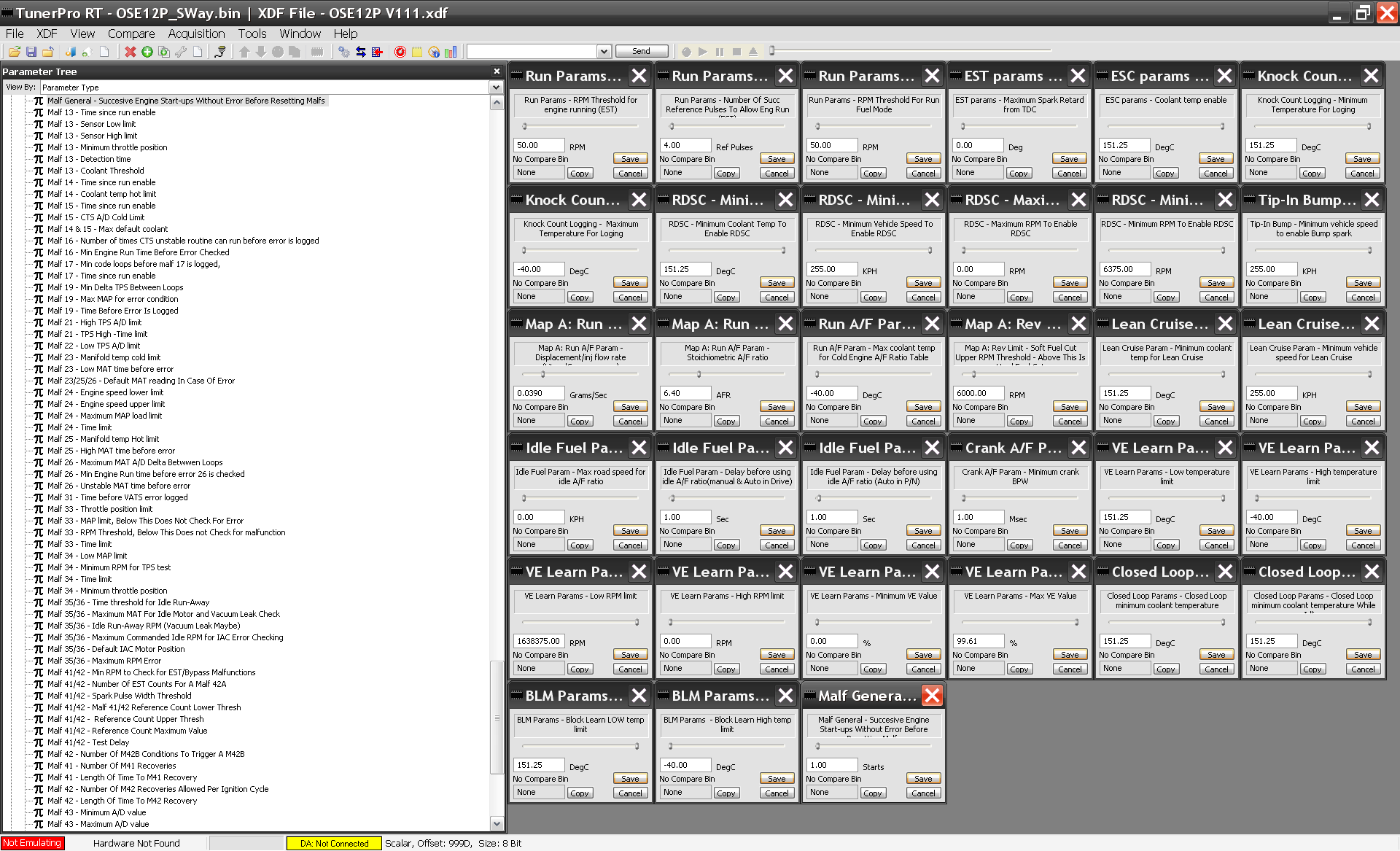

My intention was to start from scratch, though was also to see what was done beforehand and work out what was junk and what wasn't.Holden202T wrote:alot of the changes are just not needed, like VE learn, only works with a wideband, blm wont work if theres no oxygen sensor, lean cruise will probably never be an issue either as it needs a speed sensor.
anyways, yeah weather you start from scratch or not is up to you i guess.
I've made what I think is a starting point, though someone will no doubt find issues with it.
From what time I have to read {2/10's of nothing} and what I've seen others alter, this is what I thrown together as a starting point, any further editing tips appreciated.
Re: OSE12Pro A/F Maps
it looks ok to me!
