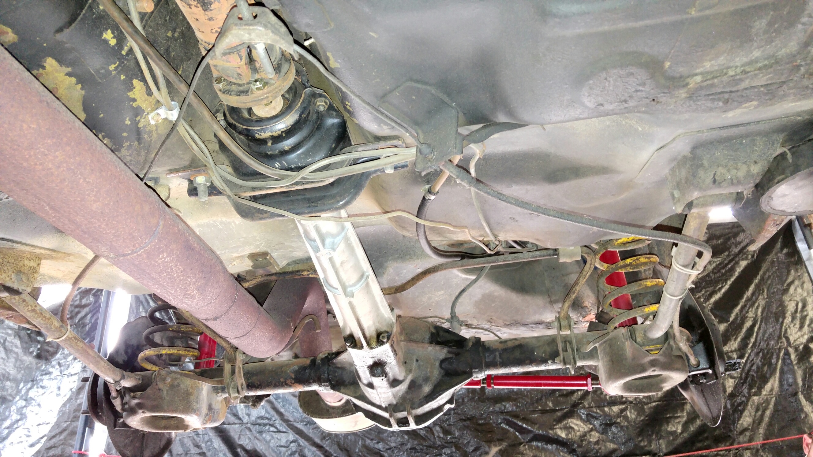

Just get a normal single spinner diff to cut up, if it works put a tru-trak in it ? If you can weld it's not that hard to do
Re: Ants SR20DET '75 Gemini track car
send me a Gemini diff housing and I'll make you one
.... what would you do though with a commodore diff, use a mac donalds bros control arm kit in place of the torque tube ?
- Posts: 10113
Cheers for the offer, I might take you up on that in the future.
I dropped the axles off this morning to Rod Tech and they had a batch just ready to go so turn around should be quick. They said that I should have used 25 spline axles because they're thinner and therefore have more flex which make them less likely to snap. Interesting point for next time but for now I just stuck with the VN axles.
As for commodore diff mounting thats a good question and one i'll need to weigh up. Looking at the pics of that kit, its quite a massive bar in front of the diff, which I reckon would foul the exhaust. Not the biggest problem but add it too the list. Along with re-routing the fuel and brake lines down the edge of the car. Planning to add a hoop in the next couple of weeks to make that a bit safer.
yeah no matter what you do its not a small job!
the 25 spliners you'll find in VL's for next time
