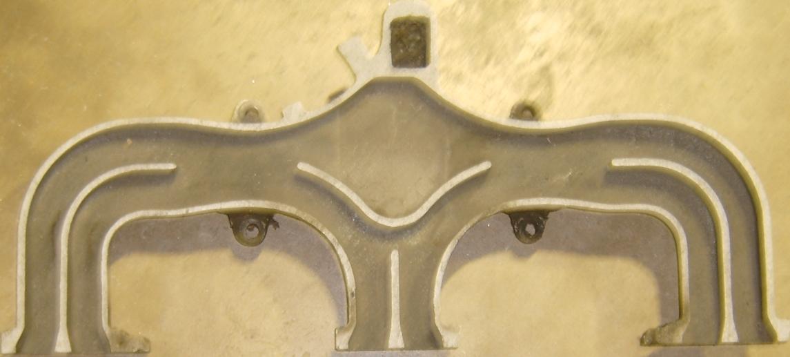

The biggest hurdle with all holden 6 heads prior to blue motor is the siamese / shared inlet ports.
The end 4 cylinders pull exhaust gas from the cylinder in it's shared runner.
eg: when cyl 1 is firing, cyl 6 is on overlap, number 5 is drawing fuel in it's cylinder whilst 6's intake & exhaust are both open, some of which ends up in number 5, the reason why most broken pistons end up being number 5 when flogged, being it's the hottest end of the motor.
The late red heads at least had the inlet divider to the manifold bolt on area, though the gasses still shared within the runner entry.
Most likely why the genuine twin carb manifolds had the 2 carbs moved closer to the middle 2 cylinders on the manifold, something that aftermarket manifold manufacturers seemed to overlook.
Something fixed with the blue / black heads and manifold.
I've put these manifolds on late red heads after re-cutting the new stud cutaways in the manifolds and made 4 inches of vacuum at idle from changing nothing but manifold, had more bottom end and ended up needing to retune it from scratch..
The port mismatch is atrocious, yet it still performed better than the std manifold
