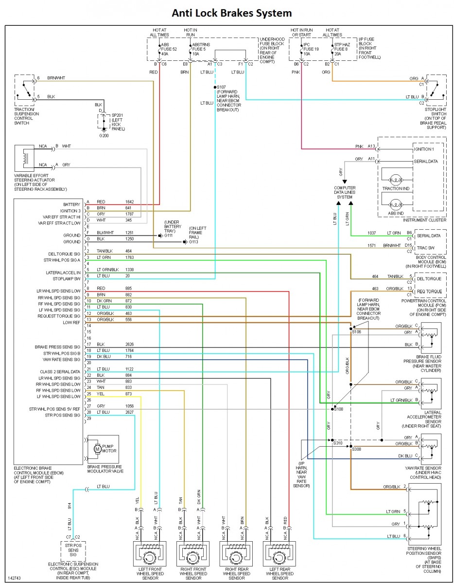

I pulled some wiring diagrams. Looks like the datalink bus is a single bus on the entire system.
EBCM has access to some interesting stuff

looking at that gives me a completely different idea. Maybe you could build a circuit to emulate the 4 wheel speed sensors then play around with scripting something that triggers ice mode. Then you could look at intercepting ice mode and disabling it outside of the module. With a bit of testing you might find its possible to disconnect one of the other sensors and still retain normal brake function but trigger some kind of error that disables ice mode which you can use on the track. Wouldnt it be nice if you found you could put a switch on the yaw sensor to disable it at the track and get the results that way, or similar.

antus wrote:looking at that gives me a completely different idea. Maybe you could build a circuit to emulate the 4 wheel speed sensors then play around with scripting something that triggers ice mode. Then you could look at intercepting ice mode and disabling it outside of the module. With a bit of testing you might find its possible to disconnect one of the other sensors and still retain normal brake function but trigger some kind of error that disables ice mode which you can use on the track. Wouldnt it be nice if you found you could put a switch on the yaw sensor to disable it at the track and get the results that way, or similar.
Actually, I had the exact same idea... I stuck a wheel hub on my bench scope (I have OEM ones since I just swapped out to the SKF hubs for track events), and looked at the waveform produced. 48 teeth/rev. Amplitude varies with speed significantly, but at roughly 1.5 rev/sec I was getting ~200 mv amplitude AC voltage. I dug through the wiring diagrams and found that the wheel sensors ONLY go to the ABS module. Now, I'm not sure how it's biased, but I believe I could probably tap the wires and sample them with my own hardware while doing an event since I've figured out fairly reliably how to get ice mode to activate (normally takes really rapid stabbing to the point where ABS also activates), and then feed the waveforms into a EBCM on my bench.
I talked to a speed shop that has extra corvette parts and he's going to give me some broken EBCM modules and some harnesses to them so that I can make a bench setup.
There's a few hurdles I see, though.
1) I'm told that the EBCM does NOT run by itself. It requires signals from the ECM in some way to do anything. This is why I was asking about bus sniffers in another post. I need to sniff this data to make ABS do its thing. I know that the TCS button in the C5 is connected to the BCM only, and the BCM relays a message to the EBCM to switch modes.
2) I need to design a board to sample all inputs into the EBCM, but I don't think I can put a male/female connector/splice in the center between the EBCM and the factory harness. I don't really want to hack up my factory harness to do this.
I started on schematics for a board to datalog this (mainly because I want to make a low cost board/diy method of getting good data (brake, throttle, yaw/pitch, steering, speed, etc) logged with a C5 while on track. Right now I'm just using Race Crono, and outside of looking at speed and accelerometer data, there's not much else. I've been working on this schematic a bit.

Re: ABS Hacking
Hmm they are good points. You may be better off unplugging things and testing on the track :) Worst case I think you'd loose ABS, im sure you would not loose brake function. That'd be a lawsuit the OEM would never risk in their design. As for the signal, those types of systems are usually just a counter on the zero crossings with analog voltages above and below a threshold. The EBCM would only see the frequency of the waveform, so you would only need a static voltage in your simulation code.
