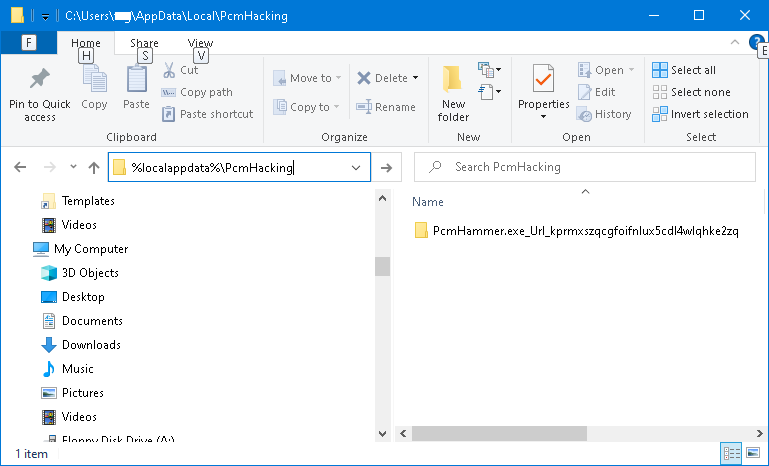

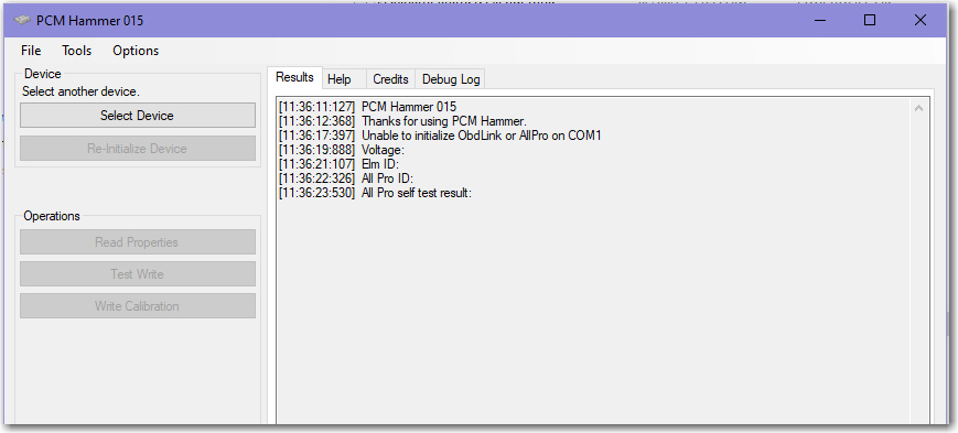

Having trouble with the install. Downloaded v15 from GitHub, installed and when I open the app it freezes, none of the tabs work, can't even close the app - have to go to Task Manager to close it. Downloaded the zip file from this thread, same thing. Delete everything and try again and same thing. Download from MS, the app loads and works but no choice as to where (what folder) it installs and a search of my drive doesn't show any files either. So, bug in zip file or am I doing something wrong? V14 still works fine.
Posts: 2332
Re: PCM Hammer Release 015
Post by Gampy »
You sure the Tool is on COM1 ...
To delete the PcmHammer configuration file follow these steps ...
Open Windows Explorer (or File Explorer in Windows 10)
In the location bar type:
%localappdata%\PcmHacking
and hit enter, you should see a folder on the right side that starts with "PcmHammer.exe_Url"
Delete it ... It will be recreated upon the next execution of PcmHammer.
You can safely delete the PcmHacking folder if you choose.
A picture in Windows 10 for those that need it ...
Or the simplest way, from a command prompt
rmdir /s /q "%localappdata%\PcmHacking"
I do plan on adding a Reset for the configuration file, possibly in the next release.

That took care of it, thanks. I saw those files and thought about deleting them but wasn't sure.
