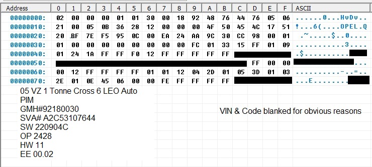

Did you ever get this sorted?
I've attached a read from my VZ SS L98 Auto Crewman E38 which has the crank input signal.
I've also attached a V6 Cross Auto 1 Tonne ute PIM and there's a few differences.
Lastly I've attached another one that I bought on it's own from a wrecker and was told it came from an L98 crewman but I don't know if it was auto or manual, as this car was wrecked I haven't blanked the codes.
- PIM VZ SS 6L Crewman - wrecker.png (29.43 KiB) Viewed 10511 times
- PIM VZ 1 Tonne Cross 6 3.6L Auto.jpg (106.9 KiB) Viewed 10511 times
- PIM VZ SS 6L Crewman Auto.jpg (108.03 KiB) Viewed 10511 times

Re: VZ PIM
Yes I did! Thanks!ben_att wrote: Hi Mate,
I setup GlobalTIS on my computer and was able to get the security access I needed with the Holden Tech2 card.
