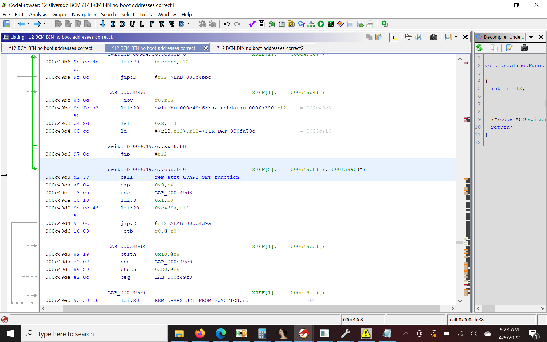

Tazzi wrote:gmtech825, what processor are you selecting in Ghidra? When I tried using one of the RSIC options (For fujitsu), it wasnt disassembling nicely. Well that was on irondukes file he uploaded with all cals implemented.
someone created a fujitsu processor module that I found. it does have some errors so that might be part of my problem. My file is set up basically the same as irondukes. I have 0xff in the empty areas where ironduke has 0x00.
here is an error thrown related to the function that calls the remote start enable byte in the system segment.
void UndefinedFunction_000c49be(void)
  int in_r13;
                    /* WARNING: Could not recover jumptable at 0x000c49c6. Too many branches */
                    /* WARNING: Treating indirect jump as call */
  (*(code *)(&switchD_000c49c6::switchdataD_000fa390)[in_r13])();
  return;
Posts: 3456
cars: VE SS Ute
Location: WA
Re: 07-2013 GM BCM
Post by Tazzi »
Oh odd, looks like it was running into a switch statement based on that text.
Maybe do a screen shot of the assembly view in graph mode. It could just be the C code representation is unable to interpret.

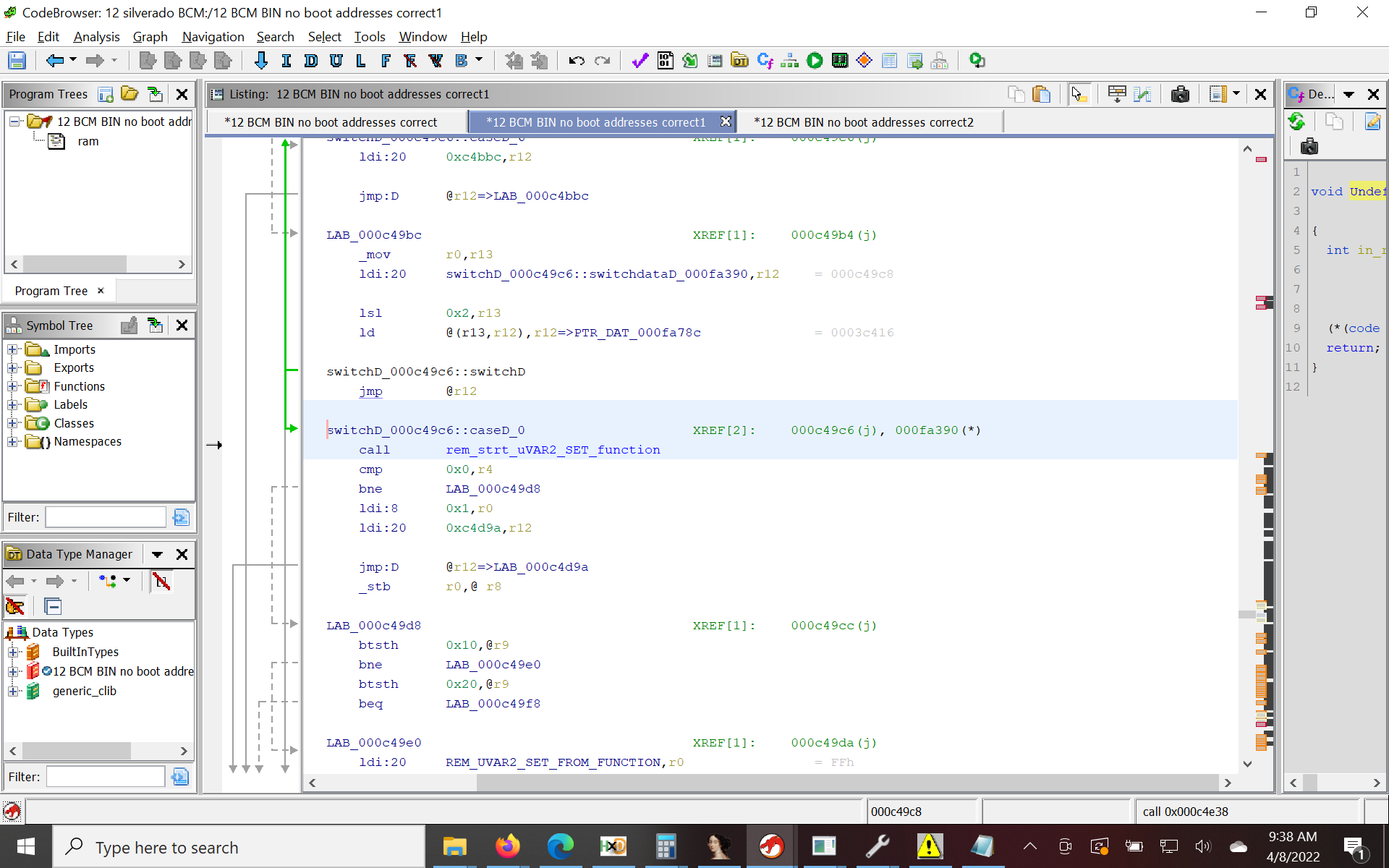

gmtech825
Posts: 194
Joined: Fri Feb 24, 2017 11:27 am
Re: 07-2013 GM BCM
Post by gmtech825 »
at 000fa390? that value is 000c49c8...sorry I'm still lost

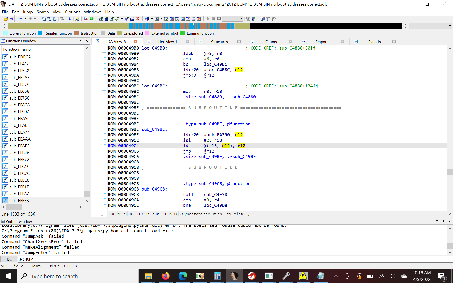

gmtech825
Posts: 194
Re: 07-2013 GM BCM
Post by gmtech825 »
here is how it shows up in IDA
Posts: 3456
cars: VE SS Ute
Location: WA
Re: 07-2013 GM BCM
Post by Tazzi »
Ill need to read the opcode definitions to understand better.
But it looks like it loads the value FA390 into r12, shifts r13 left by 2 (we do not know the value of r13) then loads data from address (r13+r12) into r12
Then it jumps to the address saved at location r12.
Its a bit of a roundabout way of doing it all. Im pretty sure the '@' sign is being used as a pointer. Meaning you need to look at the address that is saved in that register.
