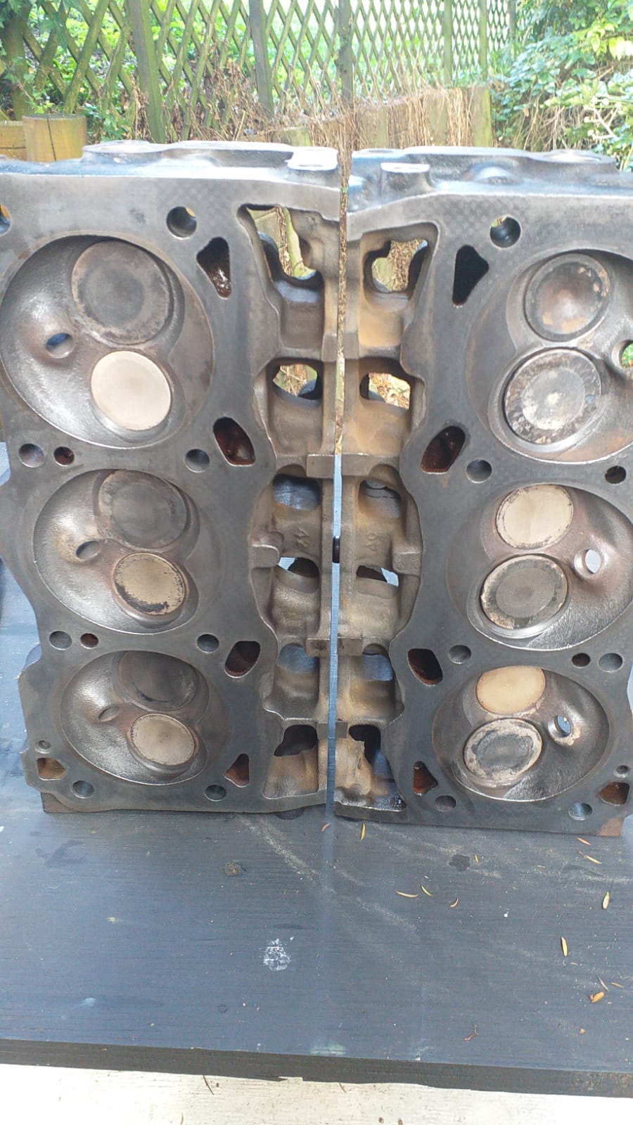

That cylinder has been getting coolant into it for some time. Oven cleaner or caustic soda works magic in dissolving carbon.
- Posts: 8120
Re: Project Rescue
I use paint stripper and a pressure washer.

I think that whole bank has been a bit sad for some time, it had the worse of the 2 intake gaskets as well, it has worse buildup on the valves too.

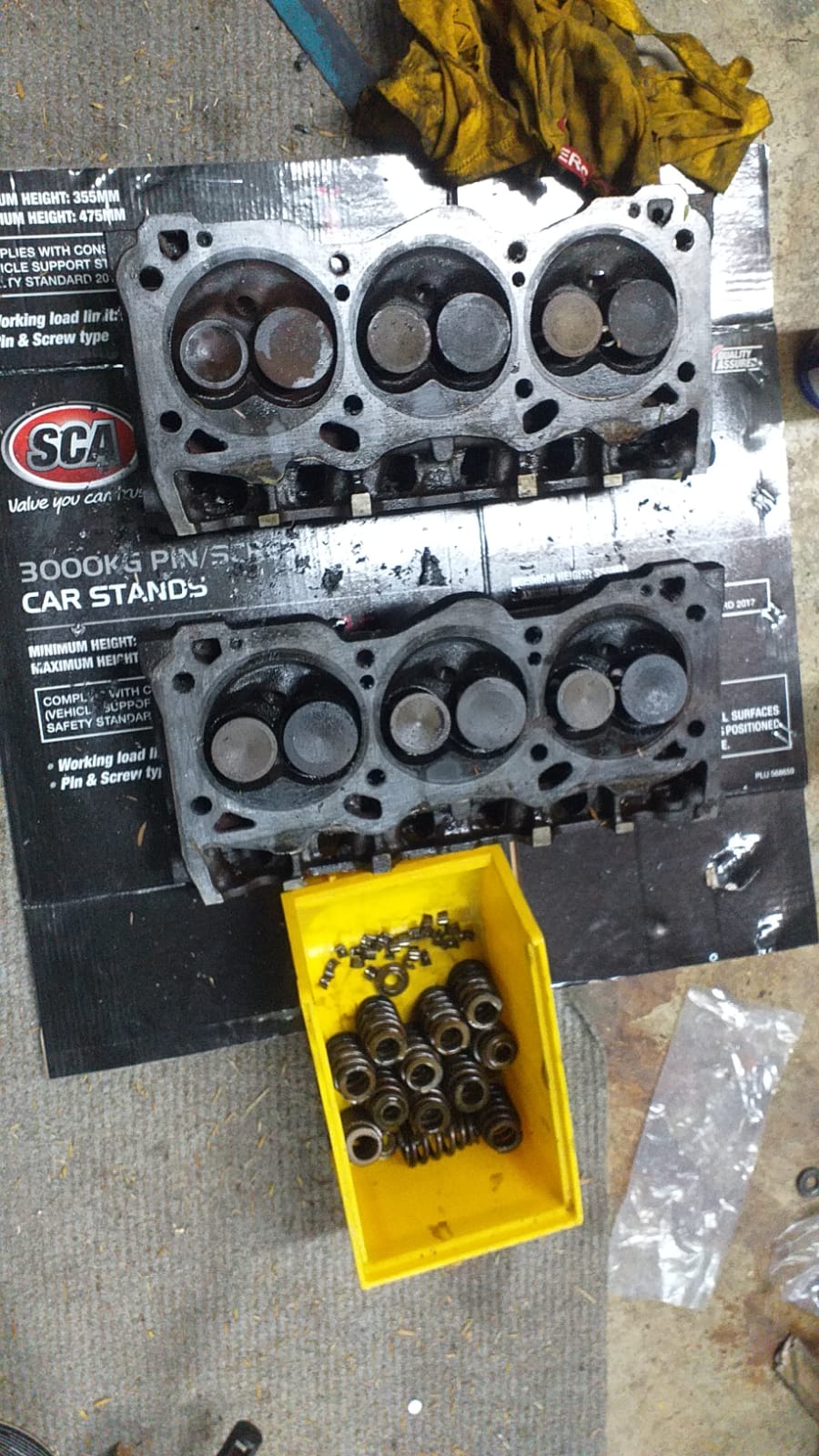

Bits ready for the parts wash.
60psi @ ~ 44mm and 180psi ~33mm Does anybody know what the stock ecotec valve springs should be? Either my valve spring tester is way off or something is not adding up with this engine. Not with the car having 340,000km on the clock.
Hopefully we still have an engraver at work and I can number the valves there before removing.
I checked one valve spring....60psi @ ~ 44mm and 180psi ~33mm Does anybody know what the stock ecotec valve springs should be? Either my valve spring tester is way off or something is not adding up with this engine. Not with the car having 340,000km on the clock.

Does anybody know what the different casting numbers are for the ecotec heads?
Some of the numbers cast into the head are 8184 E040
Checked a few valve guides. Seems like minimal to no play on the ones checked.

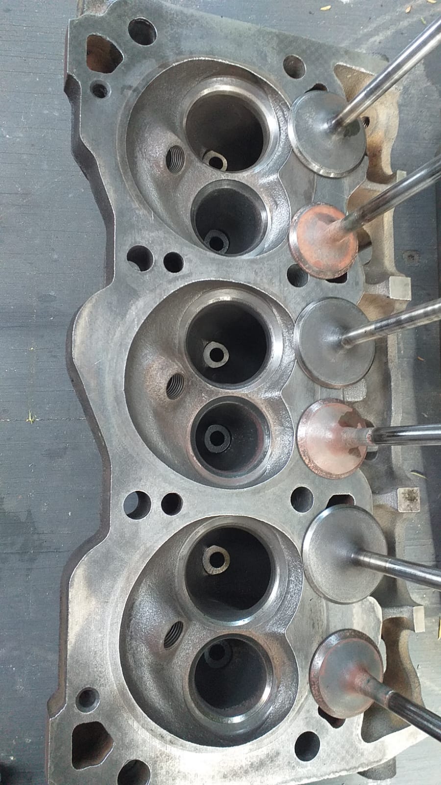

Well, after a good soak overnight and a few hours elbow grease...
My valve grinding paste was rock hard so I have a new tube on order, should be here in a day or 2. Ideally the exhaust valves need new seats cut and have the valves touched up but not going that far on this build.
Valves still need a good polish. A bit of valve seat recession on the exhaust valves but otherwise not to bad I think.My valve grinding paste was rock hard so I have a new tube on order, should be here in a day or 2. Ideally the exhaust valves need new seats cut and have the valves touched up but not going that far on this build.
Re: Project Rescue
Cleaned up mint.
Before I read your comments below the images I thought, jeez those exhaust valves really come in for a pounding...
I think they need doing. Remember that all the heat transfer from the exhaust is through the valve seat. You'll see how bad they are by giving it a once over with some grinding paste. I doubt you'll even get a full contact patch 1st time.
I used to set up a valve adapter and bolt it to a bench grinder to re-surface the valve seats then lapped them in. Saved lots of cash that way.

I'd love to do the valves/seats but I don't have anything at home capable of doing a proper job. I'll lap em by hand and see how they come out for starters.
