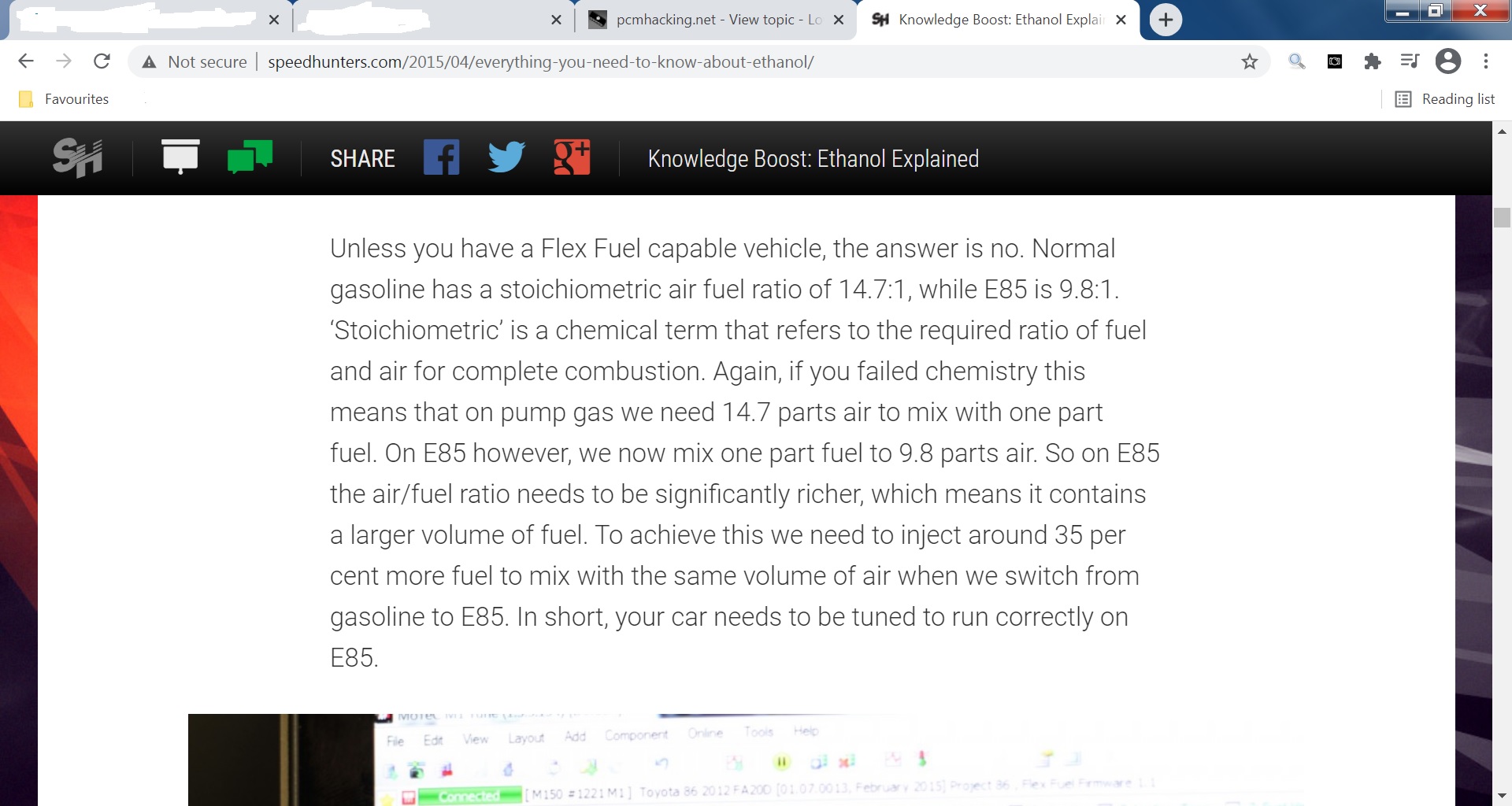

'quipt4it
- Posts: 675
Re: Low RPM + High boost = Bent rods?
Andre did say this...
