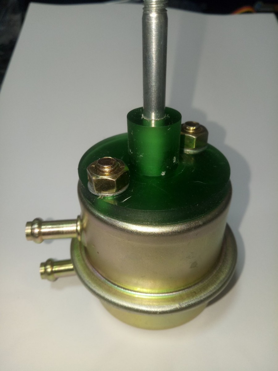

A little more work on the VNT-Petrol setup.
I ordered a pair of dual port actuators from Aliexpress. One port was supposed to be for boost to extend the actuator, the other is designed for boost to retract the arm. Unfortunately, China being china did a half arsed job and didn't include any seals in the 'retract' side against the shaft. I ordered two and both were the same, the seller says it's OK, just use the other side... They're factory sealed and there's no getting into them to add one.
An hour later the 3d print finished, a quick reaming with a 6mm bit for a real nice fit around the shaft and we've got the second port sealing.
The theory is, I set the VNT vanes at a set angle to come on boost where I decide - 2000rpm. If the boost port see's positive pressure it'll open the VNT nozzle controlling the boost. If the vacuum port see's a vacuum it'll also open the nozzle so the turbo is effectively 'off' when there is manifold vacuum - cruising, anything not WOT. This *should* give boost control, economy at cruise and extremely good boost response at WOT.
I'll fit a heat shield around the print until the CNC'd aluminium version arrives. Hopefully it'll allow a few test pulls before the print fails. It's resin printed so it won't melt, just burn if it gets hot enough.

The VNT actuator worked a treat! I've got brass versions on their way for the bearing properties. I've also grabbed some valve stem seals which fit the actuator shaft perfectly. I'll turn down one of the brass seals to accept the valve stem seal, bore the hole a little bigger so it has some articulation. Right now the shaft flexes a little due to no give in the bearing and the actuator arm on the turbo moving in an arc but no issues controlling boost.

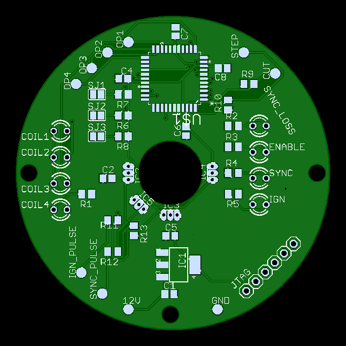

I've also found the plugs fouling to be a real pain. Mostly due to over rich tuning high up but also the dizzy preferring to arc out internally than send the spark to the plug. So...
I've made a small board that fits in the dizzy, a magnet fitted in the rotor shaft keyway, hall sensors pick up the signal for synchronising and now I can use wasted spark or dedicated coil packs for each plug. Should give a much stronger spark even through fouled plugs. They'll be here in about a week and I've got a VW coil pack I'll plug into this thing.

Put a link between the shaft and arm to absorb the miss alignment caused by the arc of the arm.

I'll try find some bar stock today and give it a go. Cheers!Gampy wrote:Put a link between the shaft and arm to absorb the miss alignment caused by the arc of the arm.

There is an actual name for it and I cannot remember it ... Driving me up the wall.
Converts a rotary/arcing motion to a linear motion ...

Watts Link.
