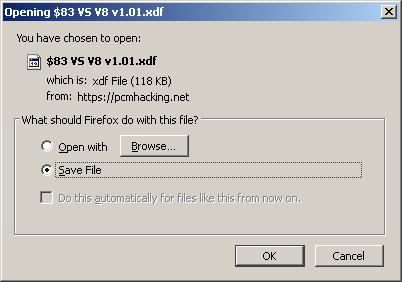

From your laptop, clicking on the link should open a dialog,
Select Save File and then OK, and it should save a file named "$83 VS V8 v1.01.xdf" in your downloads location, use that xdf file in TunerPro.Intelligence is in the details!

Re: Vs v8 scanning help
Aha, thank you sir!
