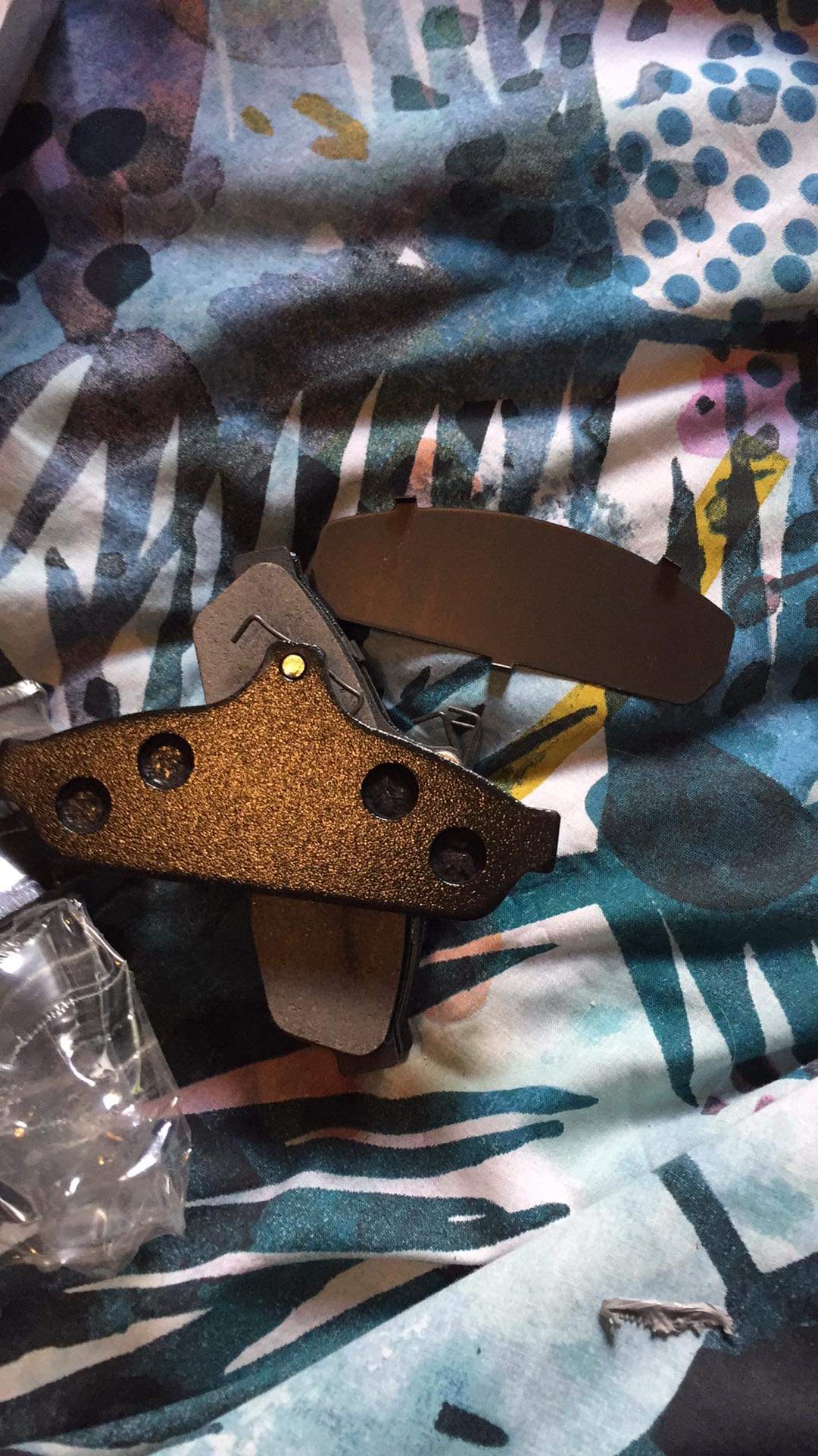

I was suggested the Forza FP3 compound was the successor to the A1-RM but better cold bite and a higher high temp range and not as aggressive on the rotors like the original QFMs.
You have that feeling the pads will be good when they come in boxes like this lol, no need to compensate with fancy box art and marketing.
The great thing is the shims pop right off with your nail, not glued on like other's I have used.
