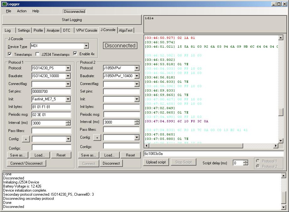

Version 0.20.18
A big update to j-console monitoring and some fixes and improvements to script language.
-connect a j-device to 2 protocols simultaneously and monitor and send custom commands to both.
-extensive configuration of how j-device connects.
.select pins
.set custom filters
.set command flags
.set custom configurations
-run scripts with commands in a loop with setting different variables that can increase or decrease.
-many other small improvements and fixes
a screenshot and some sample vpw scripts for testing.

I AM LOOKING FOR SOME CAN TESTERS with j2534 device.
An incar high speed CAN logging test will be very informative. Does the program locks up on very heavy can traffic.
Open logger->j-console->set protocol to CAN->baud 500000->timestamps checked->connect
Some CAN logs will help with CAN analyzer that is being under development.
For gmlan logs low speed can
setprotocol SW_CAN_PS->baud 33333-> setpins 00000100->connect
If the program don`t lockup on HSCAN you can monitor both LS and HS can buses[MDI is preferred here]
Than
setprotocol 2
SW_CAN_PS->baud 33333-> setpins 00000100->connect protocol 2

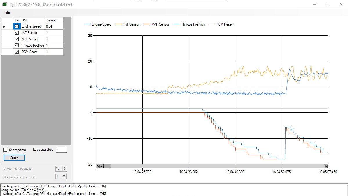

Version 0.21.0 adds graphics to logger.
In 0.21.1 zoom is enabled, by dragging area in graphics

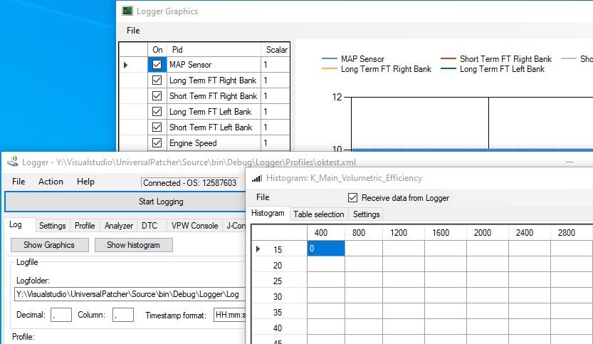

Version 0.21.2 have also Histogram in logger.
Currently it might be little bit difficult to use, please send ideas how it should work.

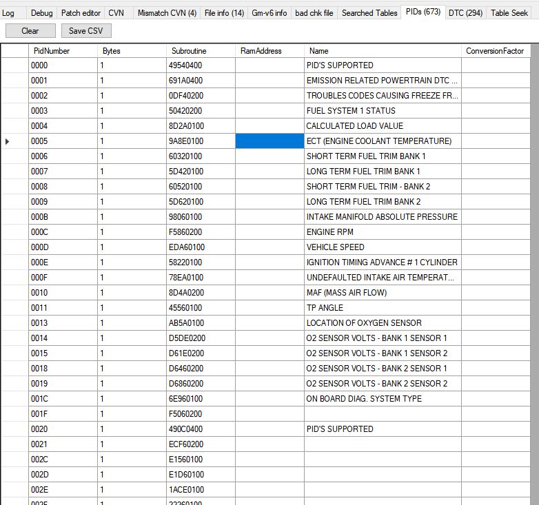

I understand official support is not available yet. I am hoping to help get it there though. Using version 20.26 but it does not look like anything pertaining to my scenario was added in later versions.
I am trying to get the PID search to read E40 and T42 PIDs. It looks like there is more changes needed above and beyond just editing the xml files. I have changed the e40-platform.xml, t42-platform.xml, and PidSearch.xml files which has thus far allowed the PidSearch to return results for the E40(did not explore T42 any further as of yet). For E40 purposes, I am getting the correct PIDNumber output. Bytes, Subroutine, RamAddress columns are all not working correctly. Byte is showing only a value of 1. Subroutine is including the function address and also the bytes. Nothing showing for RamAddress. I included a screenshot of the E40 results I am getting. The byte value is after the subroutine address which is different than Gen3.
E40 pid table for the subject OS starts at B4EF2
T42 pid table for the subject OS starts are 5435E
Logs from bin files used are:
E40 -
T42 -
Looking through github, I believe the next step is to modify the Pidsearch.cs file. Unfortunately, I do not have the skills to make changes past the .xml files nor have I been able to discover any other files that need to be updated, though I presume there are others.
E40 search string being used in e40-platform.xml:
T42 search string being used in t42-platform.xml:
PidSearch.xml modified to insert e40 search:
PidSearch.xml modified to insert T42 search:
If there is anything I need to include, please let me know. I'll gather what I can.

On e40 we have
00 00 -pid number
00 0B 49 54 -subroutine address
04 00 00 00 -size
Pattern seems consistent across all bins.
On ls1 pcms the ram address was hardcoded by some opcodes [move address to d0]. Not sure if that is possible with e40, need to look at some disassembly.
Current pid search is too limited, and most of the ls1 stuff is built in. Maybe we need to expand it to full blown search since lots of CAN ecm also have some pid tables, that can be used.
If you have some solid patterns already, we can hardcode them if not possible to add them by simple search.

Found some code patterns for ram address lookup for e40 It is move word to d1 + some others for a byte and a dword. I think a full blown search needs to be added, since e38 and newer pcms follows similar format, so we can easily expand it to cover most newer stuff.
