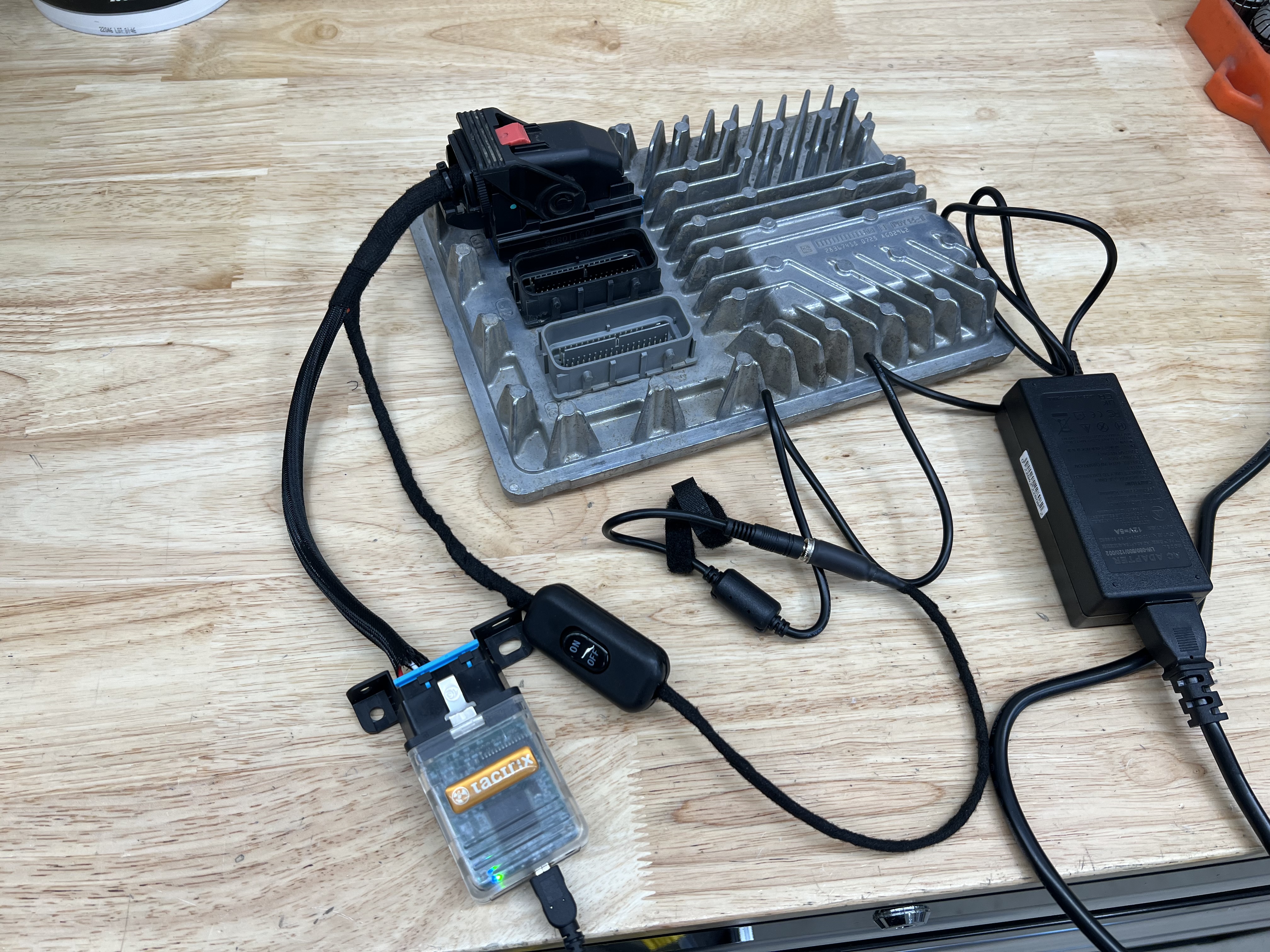

I'm mainly just wanting to make sure my second PCM is alive. I made a bench power harness and I'm not getting any comms. I don't know why I didn't think of this first, but I tested with a commercial tuning software/cable and I'm not getting anything.

Re: E92 PCM Reverse Engineering
Ok, I got it. Needed power to the pin 18 in the IOTerminal PDF you linked.
Edit:
I cleaned up my bench wiring now that I know It works.
I was also able to connect with the Tactrix and Drew Tech Tool very easily thanks to your help. I’m going to have to play around with it some to get more familiar.
Edit:
