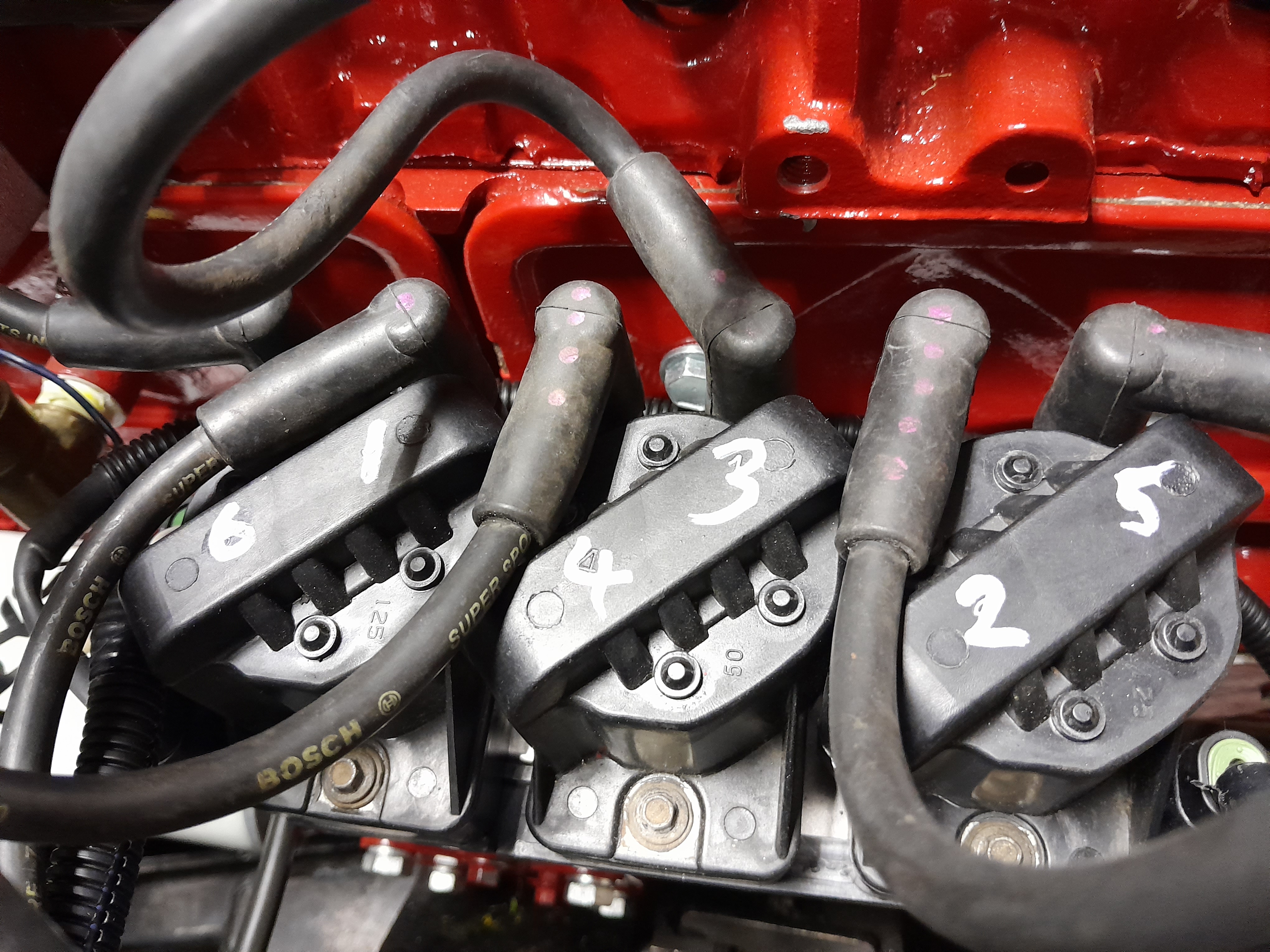

Reference now set to 60 and have what appears to be a constant usable spark.
I tested each lead with the timing light and found the firing order not to be anything that I expected.
I obviously had no.1 and 6 firing at 5deg below tdc. But when I tested the leads on cylinders 5 and 2 they where firing 120deg after 1 and 6 instead of 60.
So consequently change so that coils fire 153624 .
Still doesn't fire up but it sounds like it might
Photo of the coils show where the leads go

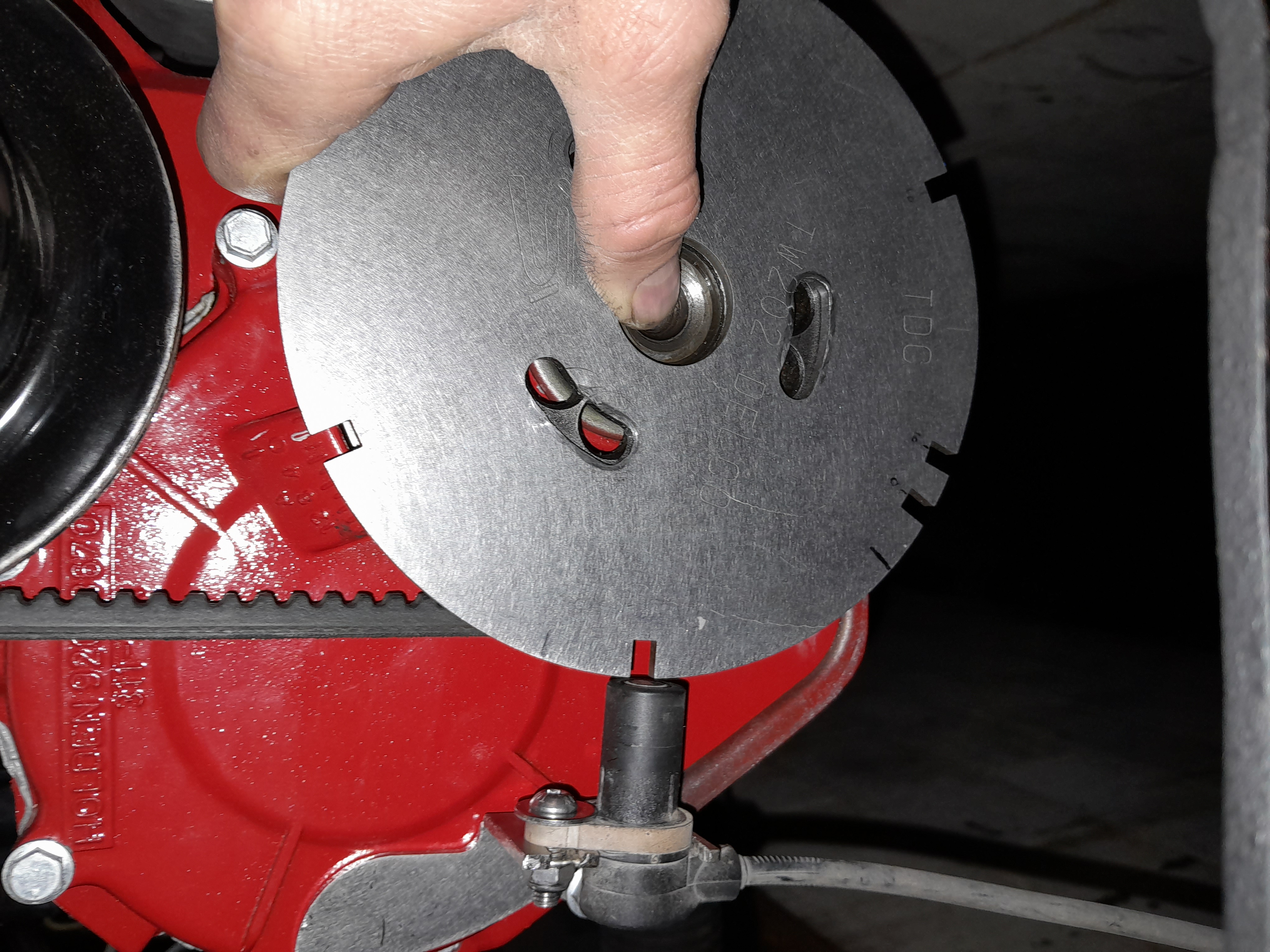

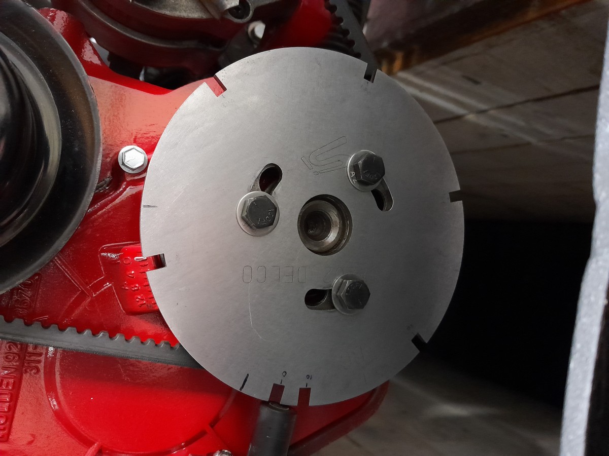

So just to confirm.
The next 2 photos are with the engine at tdc.
The bottom is what I have at the moment
The top is what I understand Antus to be describing to be in the previous recommendation as far as sensor location. Sensor at -60 and zero at -120 with ref at -130
I'm a toolmaker with access to a decent mill so I should be able to get the new slots somewhat bang on if I'm sure of what I'm aiming for.
If not I've got a perfectly good round disc that I'll hang on the shed wall to remind me how little I know about car electronics
