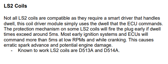

Is your LS Coil Driver different to VL400's LSx Coil Driver possibly ?SilentBob wrote:
LS2 D585 & D514A not recommended.
In the notes for that LSx Coil Diver it has the D514A as being know to work.

This is completely different to the VL400 module. The VL400 module is programmable including its own dwell settings and replaces the factory ignition module (Its also no longer made). This one retains the factory module and piggy backs its output.

Thank antus, although that snippet above about the LS2 coils actually is in the MPR Coil Driver Rev2 instructions that VL400 sent me to download.antus wrote:This is completely different to the VL400 module. The VL400 module is programmable including its own dwell settings and replaces the factory ignition module (Its also no longer made). This one retains the factory module and piggy backs its output.
Also though I think BBG may have had something to do with the information update after fitting the Coil Driver box to his V6 Hilux.

I might have gotten a couple of bad coils, they were out of a wreck. I'll have to retest at some point.OZ38 wrote: Is your LS Coil Driver different to VL400's LSx Coil Driver possibly ?
Cheers Deek
There were two different modules that VL400 made, one was the MPR coil driver viewtopic.php?f=11&t=3065. My unit is basically functionally the same as this.antus wrote:This is completely different to the VL400 module. The VL400 module is programmable including its own dwell settings and replaces the factory ignition module (Its also no longer made). This one retains the factory module and piggy backs its output.
The other is the one you're talking about and is very different viewtopic.php?f=11&t=2913&hilit=ignition+module. That one is fully programmable, etc.
About compatible coils with my unit, I'll copy/paste what I sent to OZ38 in pm.
Since the dwell time is set by the ecu, any coil that has been ran successfully on an MPR unit should also run fine on mine. I just try not to recommend anything I haven't personally tested.
