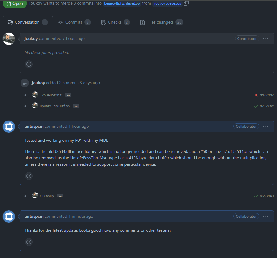

I dont know how I can add modifications now. Should I close old pull request ?
- Posts: 10096
Re: Hammer not reading ECU
No it auto updates when you commit to your develop (which is the merge request) and push the branch. It looks good to me now, and the merge request shows the cleanup push. I'll give it a day or two to see if anyone else wants to test and report back, but I am happy with it. Cheers!
Posting the screenshot of the view of the merge request here, for any learning devs with eyes on this conversation. You can see the additional pushes, see CI start passing, see your most recent cleanup, chronologically. This is going on here https://github.com/LegacyNsfw/PcmHacks/pull/345
Anyone can checkout Joukoy's branch, build the C# part of the project and copy the kernel dlls from the existing pcmhammer release, or add the 68k assembler and build the kernels themselves if they want to go that far and test. If they have a github account they can report results of testing in the merge request. It seems to be good, but more people, more hardware, more target ecms are all good.
